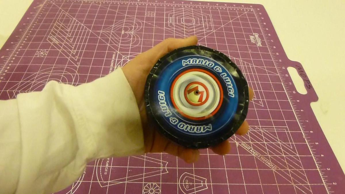

Part 4. Tire Construction
1.  Now for Tire Construction.
2.  I used 1” thick foam from Home Depot to make my tires.  The forum suggests using EPP foam.  The tires are 4” in diameter.  I used a 4” hole saw to cut them, but you could just cut them with sharp blade.  Use a marker to marker the center of the hole, you’ll need to know that later.  Cut 4 tires.
3.  Cut eight 2” circle discs from plastic gift cards or old credit cards.  Drill holes in the center for the size axles you need, making the holes just slightly little larger than the axles.  These will be the wheel hubs.   Note, the front axles are smaller than then rear ones.
4.  Cut notches in the sides of the disc and bend them over 90 degrees.
5.  Push the discs into the center of each tire, lining the center holes together.  Hot glue them together.  Repeat for other side of tire and for all 4 tires.
6.  Spray paint tire black if you wish.
7.  Cover the tread of tire with black duct tape for durability.
8.  Hot glue the printed tire covers, one onto each tire.  Make sure the center of cover is in the middle of the hole.
9.  Cut a 4mm long piece of fuel tubing just large enough to fit over each axle.  Slide the tubing all the way against the main wing.  Use CA or Super Glue to glue in place.  You can also use a glob of hot glue if you don’t have fuel tubing.
10.  Put a tire on each axle.
11.  Cut another 4mm long piece of fuel tubing just large enough to fit over each axle.  Slide one onto each axle and glue into place.  Make sure to leave a little room for wheel to turn.  You can also use a glob of hot glue or an actual wheel collar to keep the wheel on.
