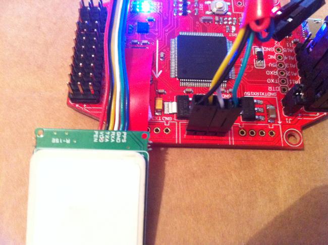

This video gives instruction on how to enable the GPS on your board.
GPS WIRING
YOU MUST FOLLOW THIS VIDEO if you want your gps to work, but do not try to fly with this software as it is not configured for flight.

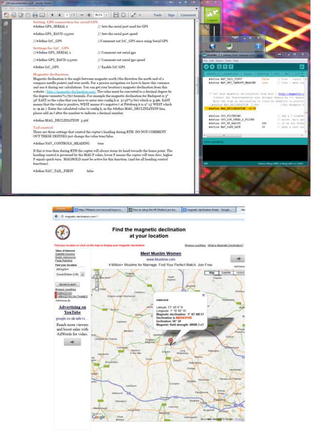

IF you are using multiwii final code you must set the magnetic declination

Tx must go to rx and rx must go to tx
if so then it worked because you used the setup software (dev software)
if you did not then you were simply lucky

Having difficulty getting GPS to work. I've followed the setup video for the GPS exactly and triple checked that my wiring from the FC to the GPS is correct and still no GPS signal.? Com port is correct and speed is set to 115200. Everything else seems to be working fine. PKT light is not flashing at all (solid red) but the home light is lit green. Any ideas?
Have you swapped the TX and RX leads so the gps tx goes to the boards RX and the GPS rx goes to the boards TX?
You will have to look at the chip and see what it is then select in arduino
