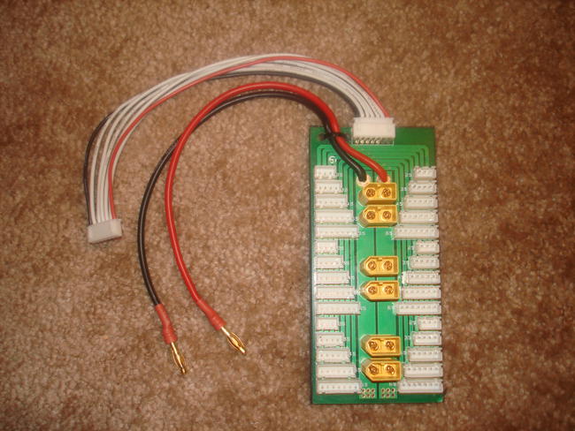

Here's a pic of what the board looks like as delivered from Hobbyking:
The board works fine as delivered from Hobbyking but I chose to clip off the XT60 and soldered on a couple of banana plugs so I could plug the board directly into the charger.

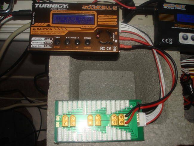

 Here's the board hooked up and ready to go on the Accucel 6

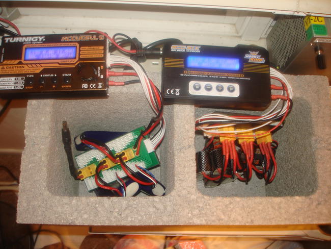

The Accucel 6 and the ECO 6 both hooked up and charging batteries. These two chargers are very similar, the operator menus appear to be exactly the same.

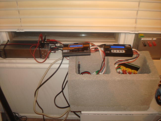

 Pulled back a little to overview the whole setup.
 There are plenty of other ways to accomplish parallel charging with both of these chargers but these boards make it easy. Just make sure the voltages of the individual batteries are fairly close (within two tenths of a volt seems to be working well for me). Plug the big plugs (xt-60) onto board first, if there is a difference in battery voltage, it will equalize (same with the balance pugs, but the traces are much smaller so they are much more likely to act as a fuse if there is too big of a difference). Only charge batteries with the same amount of cells together and follow all charging precautions as normal. Using these chargers, you will not charge multiple batteries super fast but at least you can charge and save time by charging a bunch at once. Charge safely!

I like how you use the brick to keep your house safe from an unexpected fire!

jetpackninja on July 11, 2012
Thanks Andre-
I may actually move this setup out to the garage. It's all about risk management.
The cinderblocks likely will prevent a fire in case of a catastrophic lipo event but would most likely still fill the house with the stinky smoke.
Kind of weighing the risk. Charge attended inside my hobby room vs. unattended in the garage. In the garage I will probably place a big ziplock bag of sand on top while charging...
