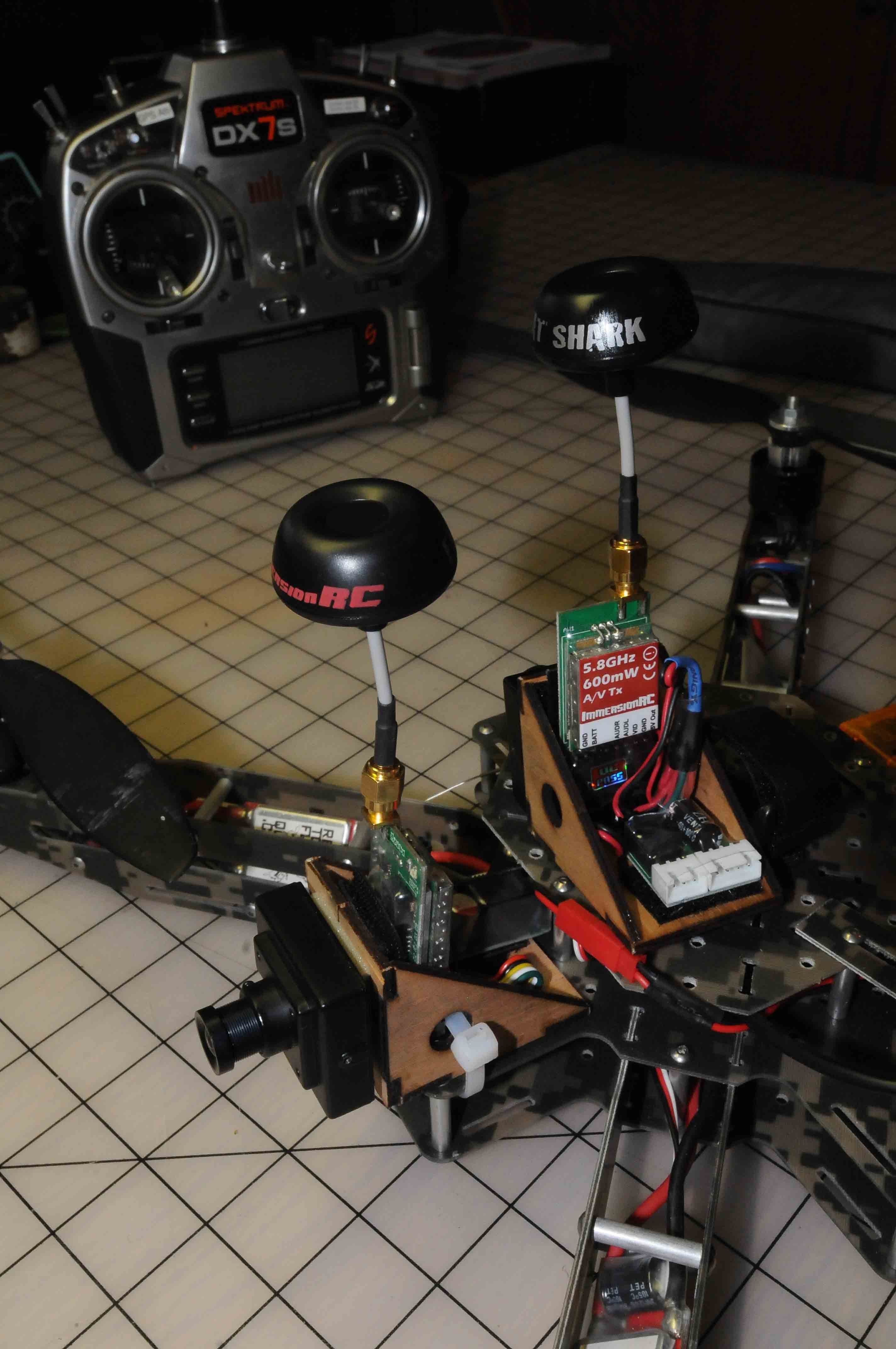

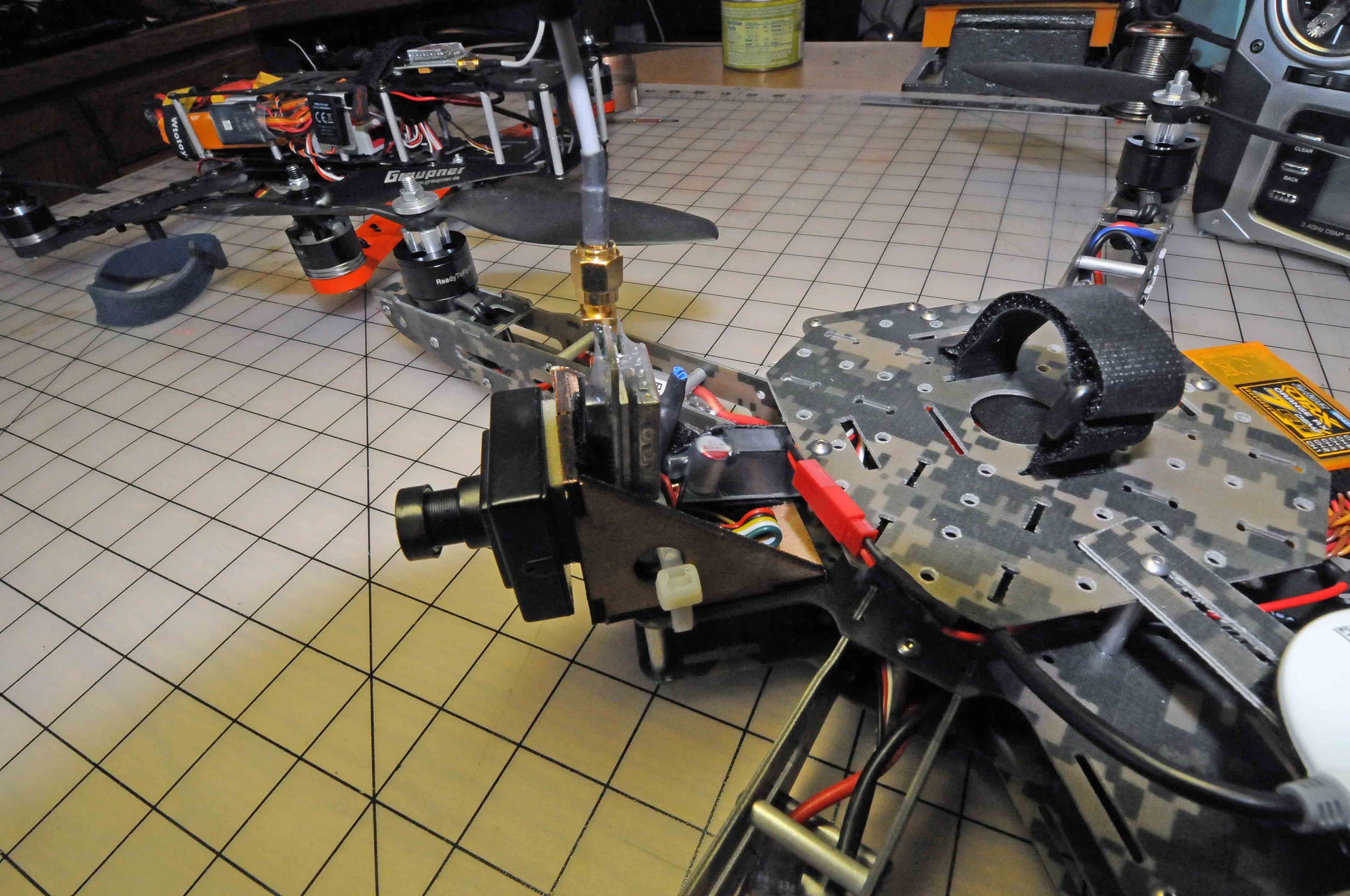

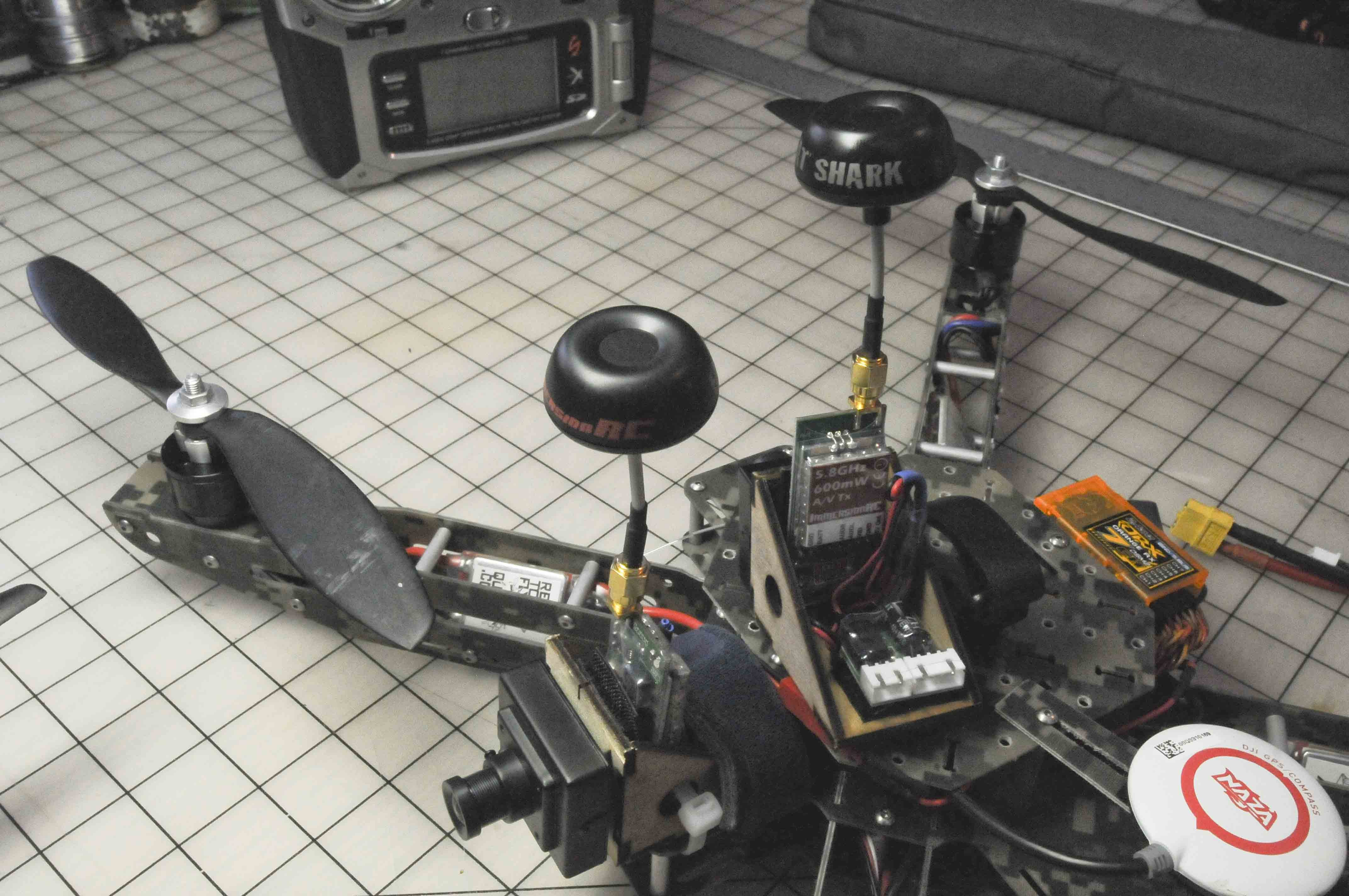

The base is a kit from the Flite Test brothren,  https://store.flitetest.com/ft-elements-simple-firewall/  .   It is very strong and weighs little.  I have built a couple, one has a JST connector for power and the other plugs into battery balance lead, to power filters that condition 12v for transmitter and 700 line CCD flight cam. Camera is mounted with gelfoam squares. Everything else mounted on velcro in case of mishap but the pod mounts to anything with a zip tie. I am going to lose the outer camera shell on the next one and save a lot of weight if I just fly the board and lens without the heavy housing.  Works on our quads, planes, and once on a dog.  Have at it.
