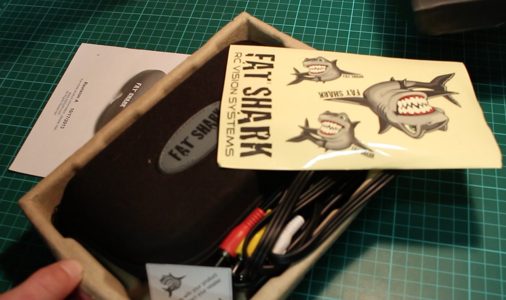

So I started off the video with an unboxing!
Link of the manual here
http://www.fatshark.com/uploads/pdf/1759-1.pdf
Out of the box came the fabulous cardboard container, containing the wonders inside!

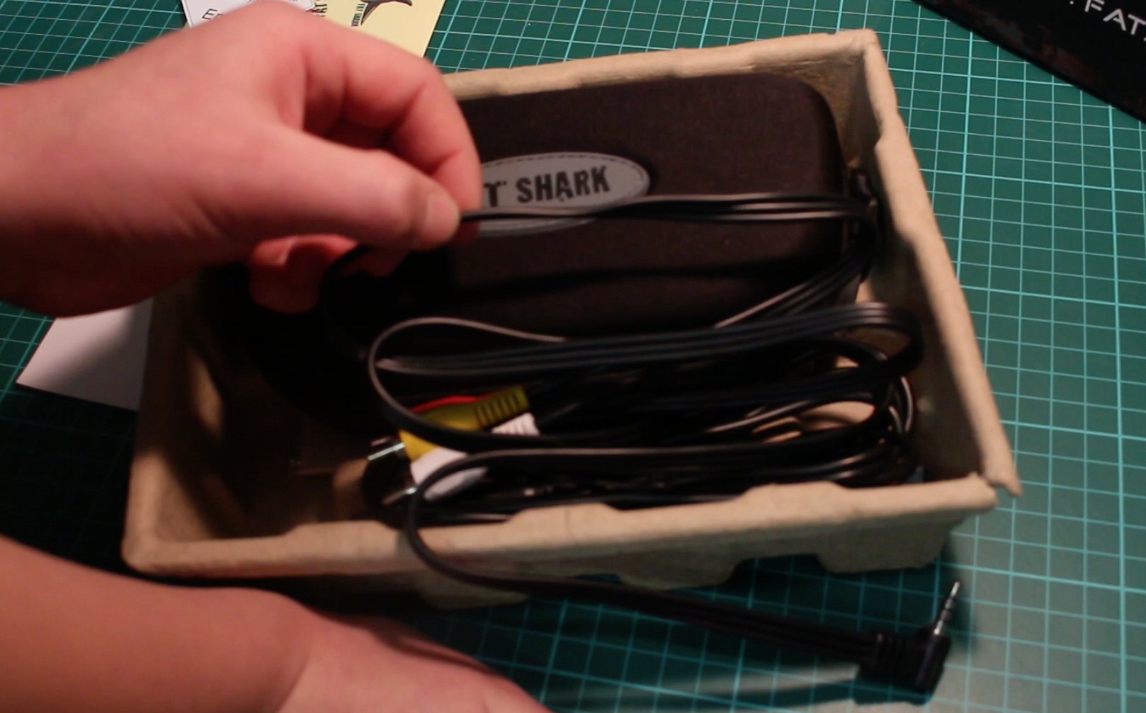

First there was the stickers, then there were the cables! In the box you get 4 cables! The 3 Data cables,
3.5mm JR, Futaba 6P and ezUHF MiniDIN and then you get the AV Cable!

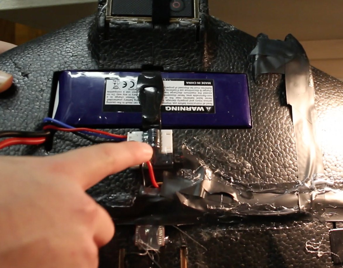

I also show the electronics in the manual. The thing is I coudn't wait when I got the goggles, so I instantly installed all of the electronics in my plane. So then I had to show them mounted on my plane!

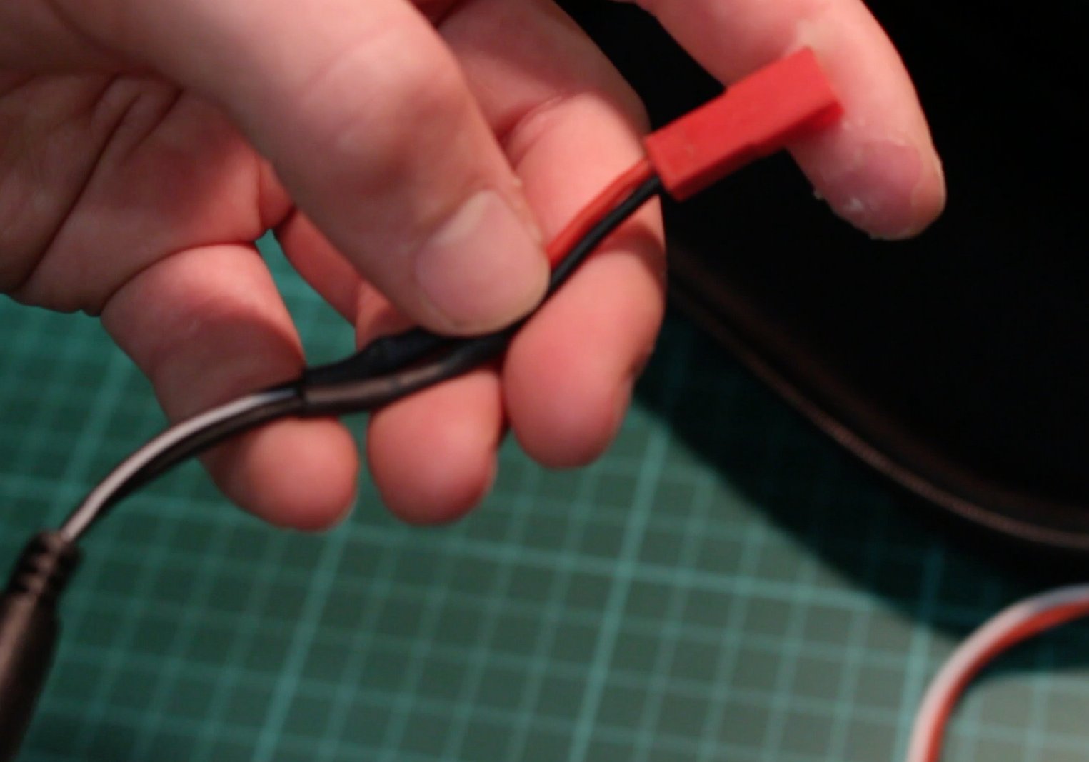

I then show of my little adapter I made! It's just a barrel connector adapted to a JST connector for my Rhino battery.
All you need to make this adapter is:
-Barrel connector with 2,1mm inner dimension. 5,45mm on the outside.
-Male JST connector.
-Solder and Soldering Iron.
-Heat shrink.
-And basic soldering skills!
+ On the barrel connector there should be 2 black wires but on shoud have a white stripe on it.
Usually that white strip means that wire is positive and remember the pin in the inside is positive and the outside is negative.

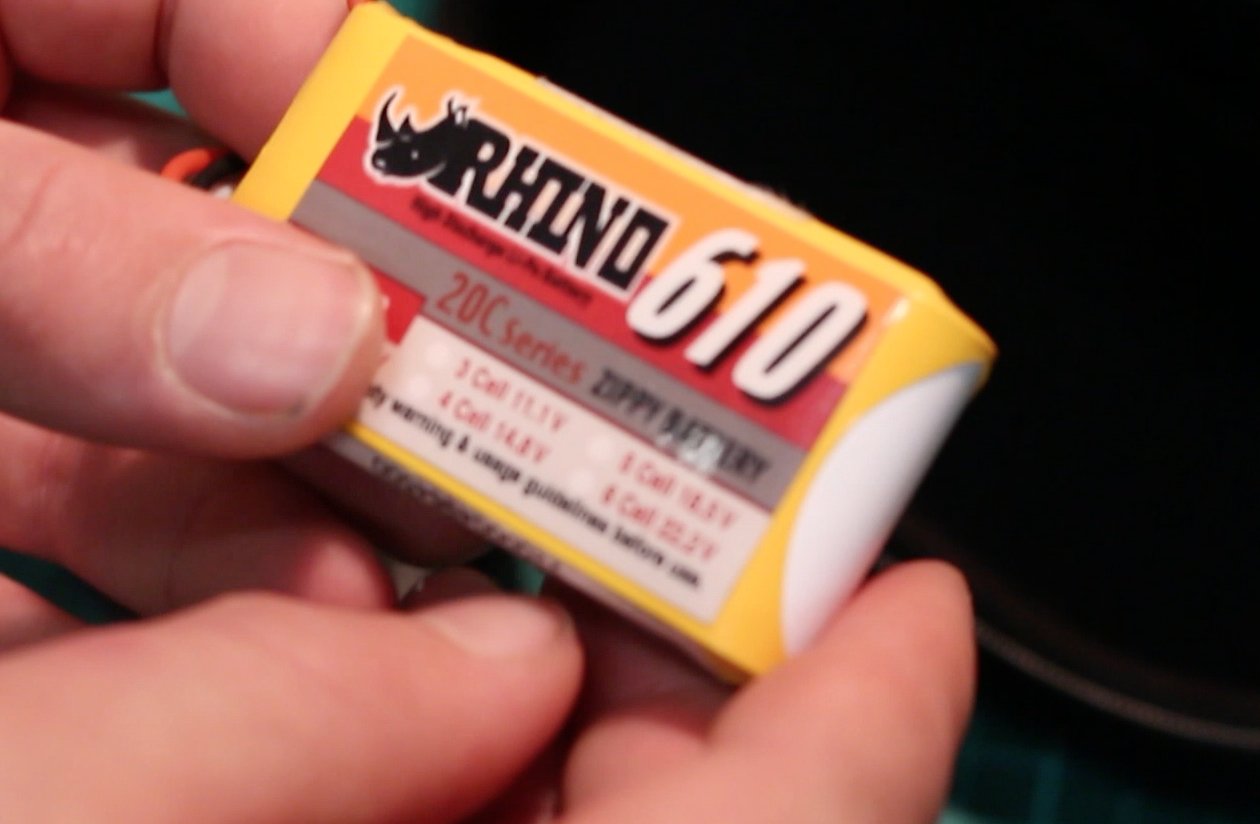

The battery I used was a HobbyKing Rhino 610mAh 2S 20C!
http://www.hobbyking.com/hobbyking/store/__7305__Rhino_610mAh_2S_7_4v_20C_Lipoly_Pack.html

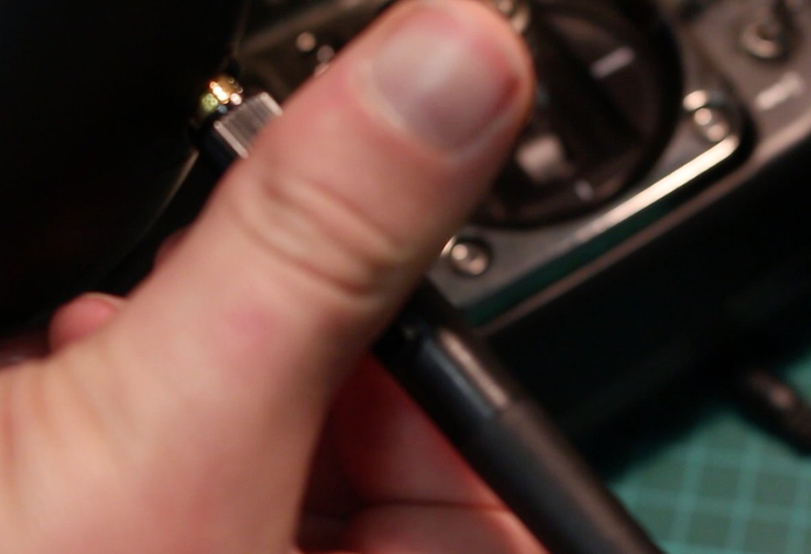

I then showed the Rubber Ducky antenna. The antenna is the stock antenna for most Fatshark goggles.
They're 5.8ghz and they're not that powerful. And if you fly behind yourself you'll lose a lot of signal.
So what I'm doing to fix this problem is I'm gonna build a circular polarized antenna.
I would advise everyone who gets one of these "RTF Fatshark Kits", to replace the stock antenna with a circular polarized antenna!

All you have to do to attatch the antenna is just screw the SMA connector together!
