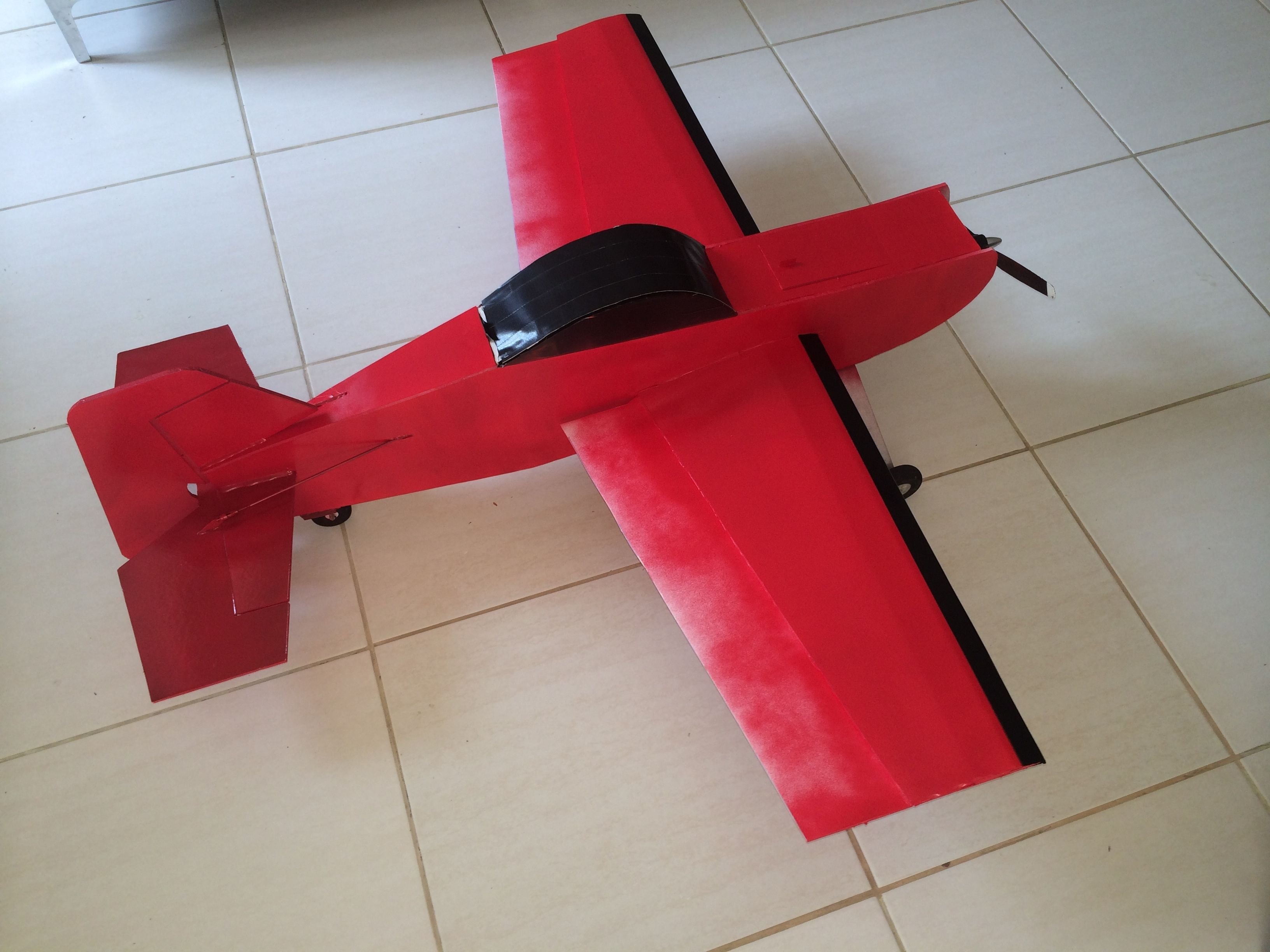

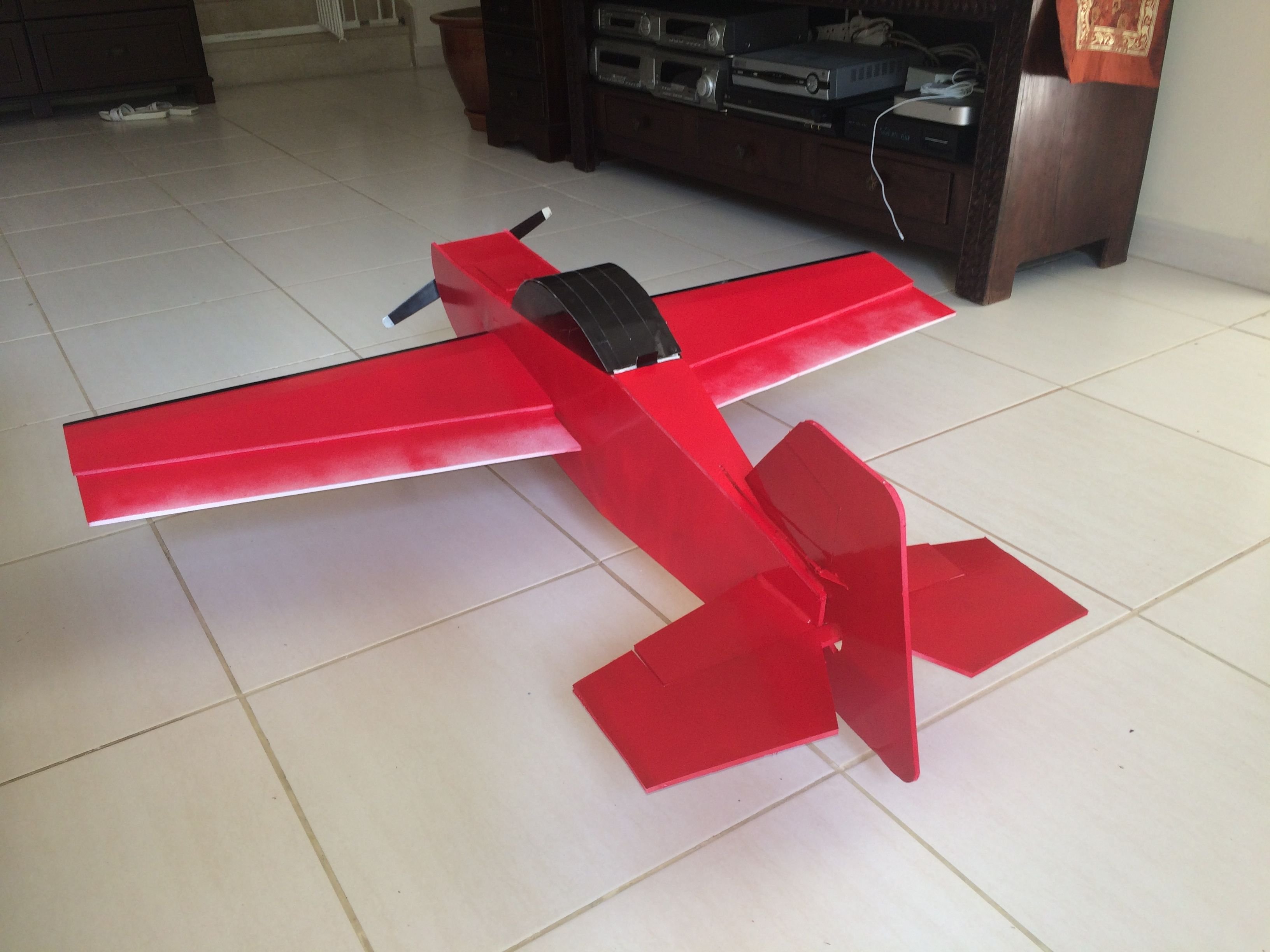

This is my 1.30 scale version of the FT 3D.

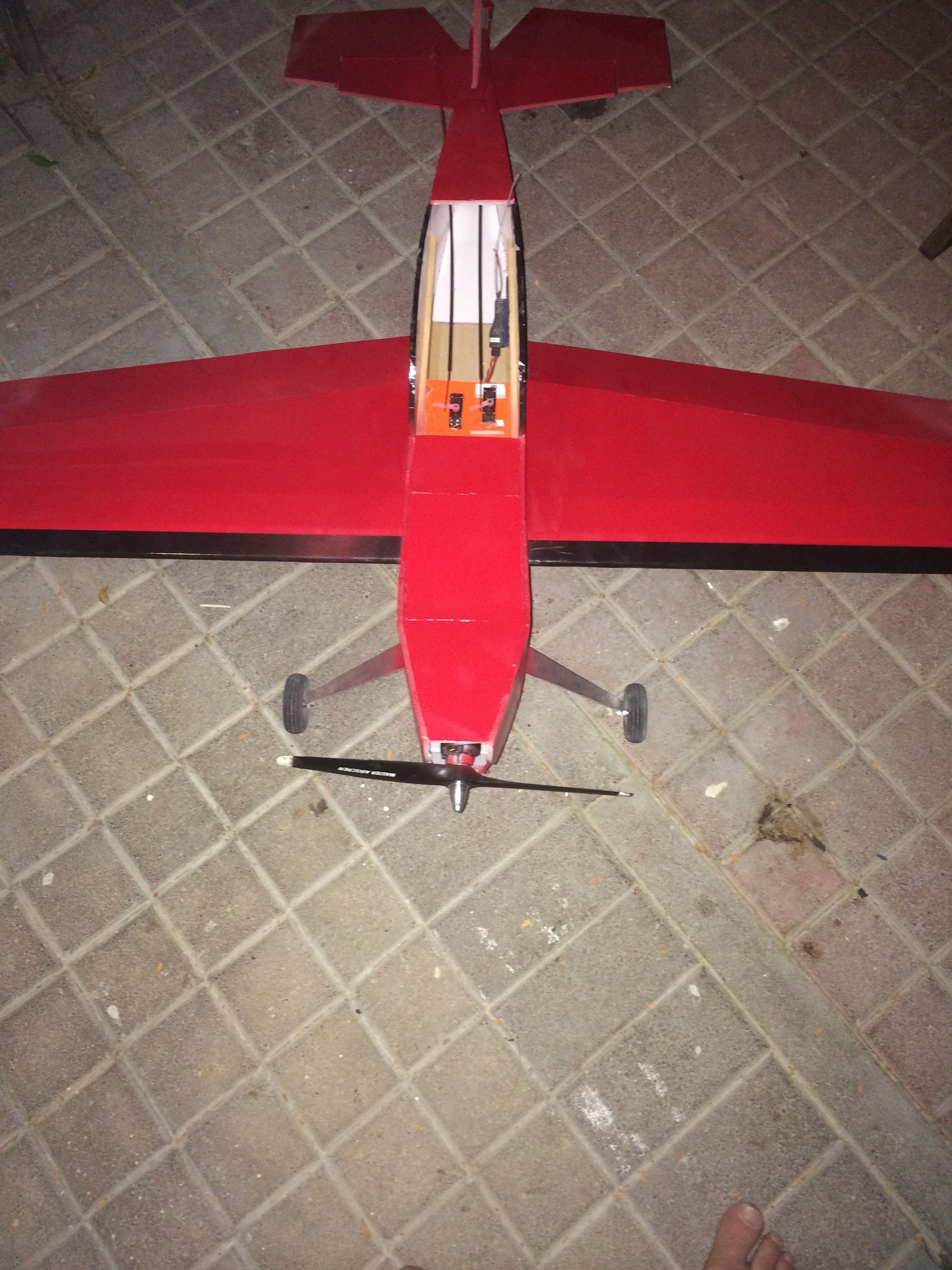

It is made out of foamboard with wood bracing on the inside.
The bottom plate is entirly bass wood from the front until the tapering starts behind the ailerons.
During build before painting it red.
Plenty of space (for a squirrel) inside!

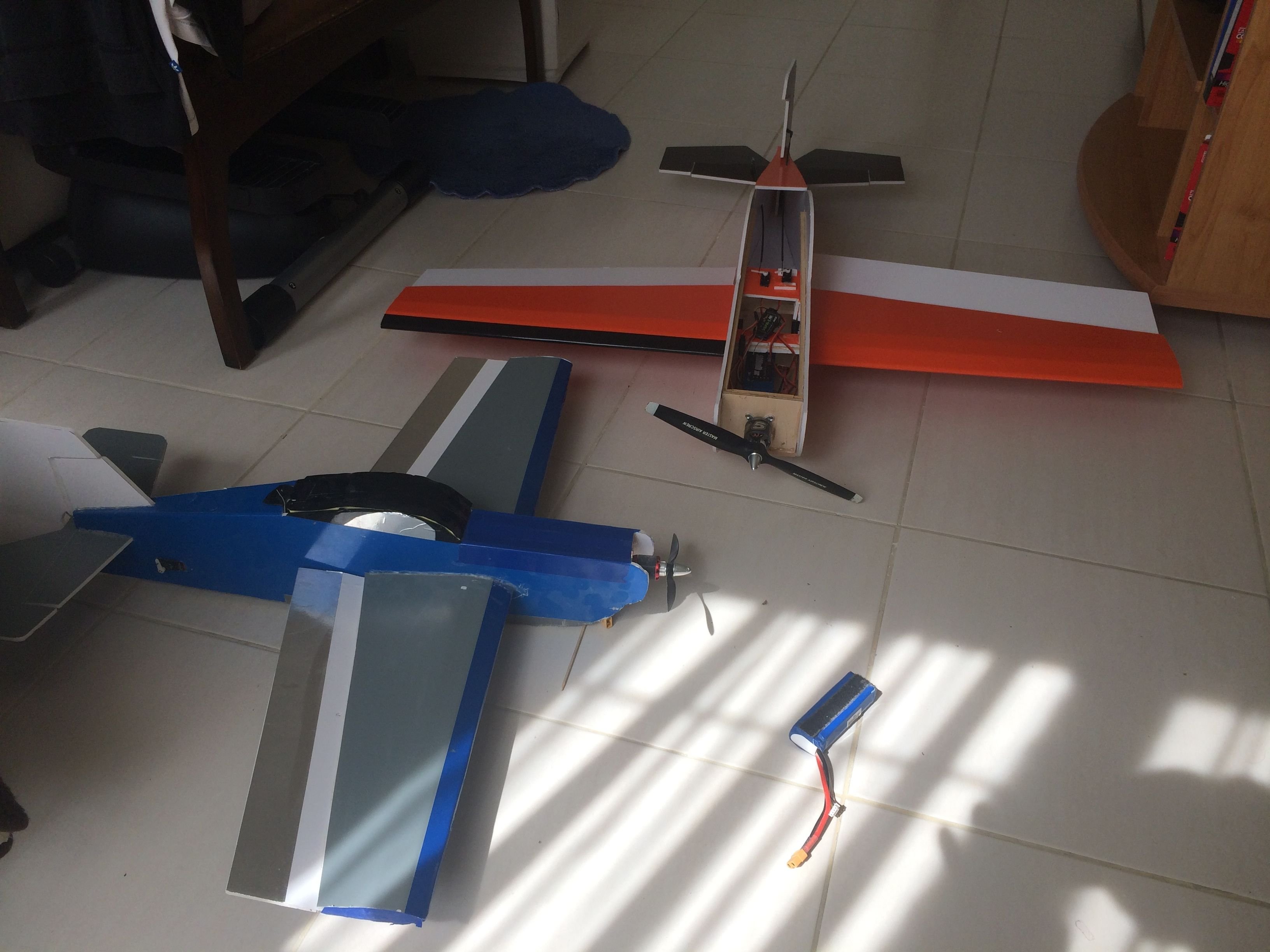

In comparison to the standard size FT3D.
Every meassurement is exactly 30% bigger then Josh's plans except the nose that I made 4cm longer.

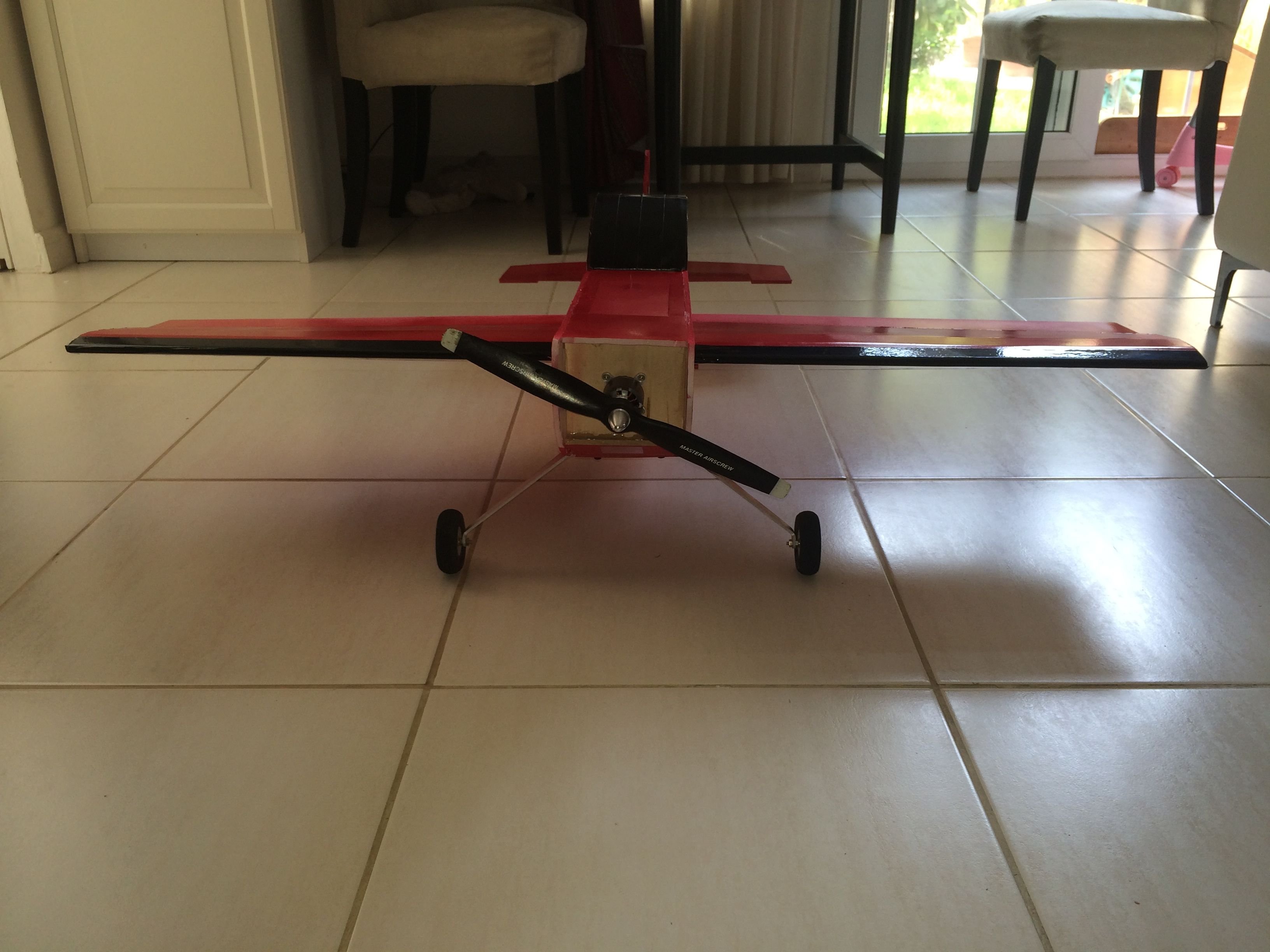

I have since the pictures was taken changed the nose like below, I felt that I did not have enough power, and blamed the large "waste" area the firewall created.
