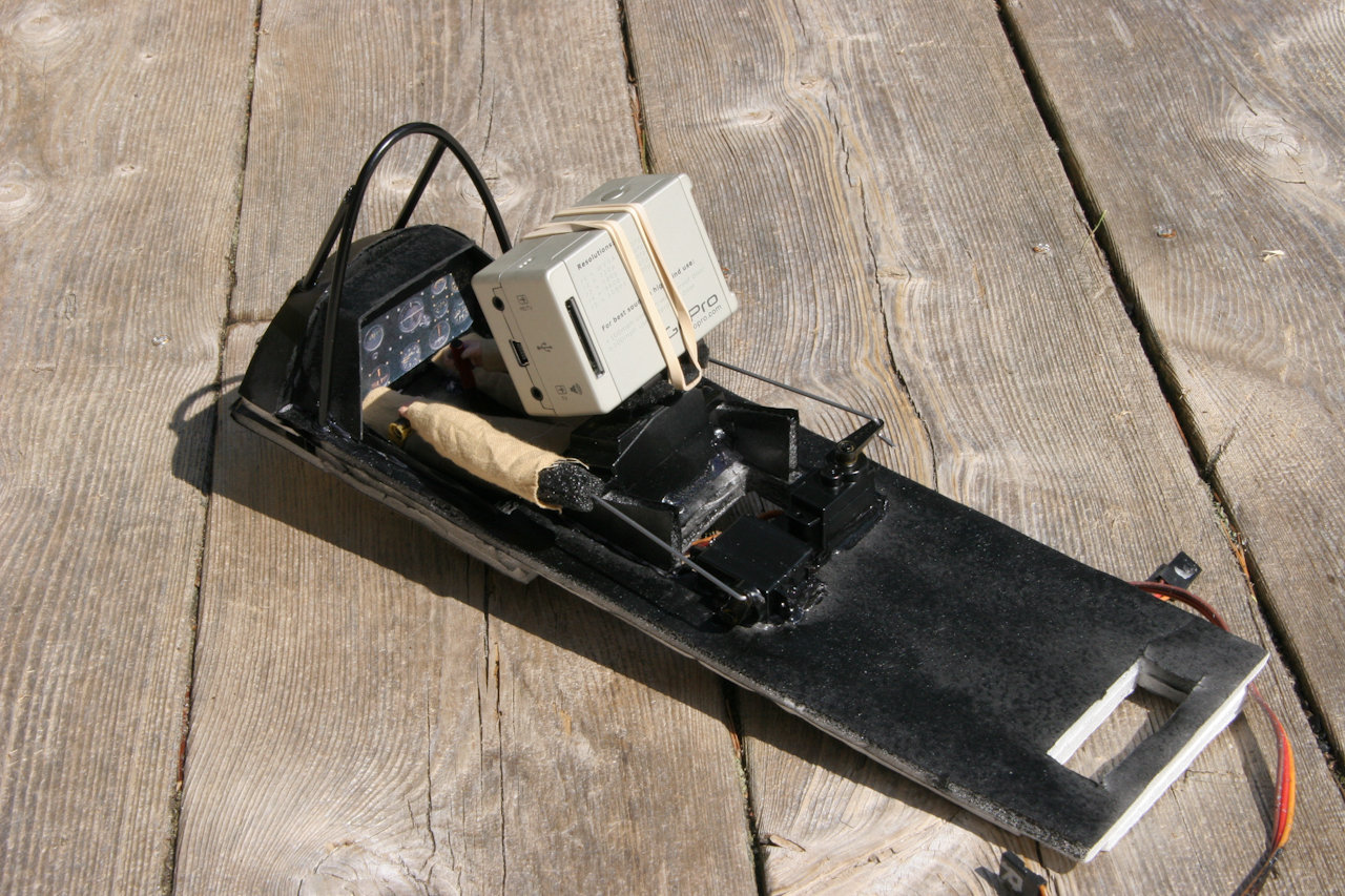

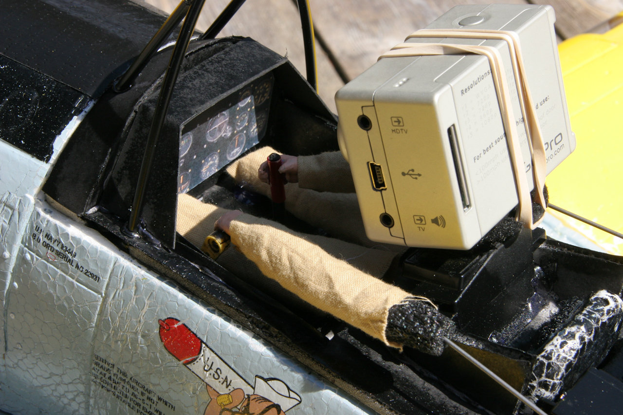

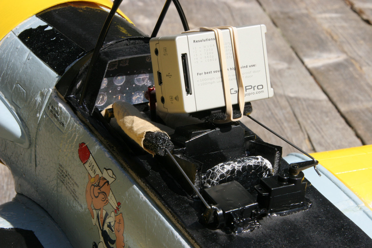

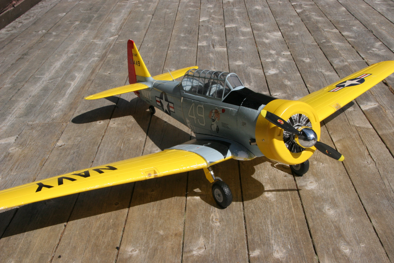

After seeing David's P-51 Mustang FPV project, I knew my Art-Tech T-6 Texan could support the weight of my GoPro.
 I fabricated a cockpit using the ever-popular Dollar Tree Foam Board and hot glue!
My first flight was truely just a test, really. It flew remarkably well as the weight is pretty much right on the CoG. As you can see in the video, my field isn't quite flight-ready, but I took her up anyway! I just couldn't resist!

Incredibly realistic pilot with the moving arms

Yes, the camera pan servo is linked to the rudder. I also have a switch that will give me manual control with a potentiometer.

Brilliant! It would be one thing to have the control stick working, but to have the throttle arms working too is shear genius!
