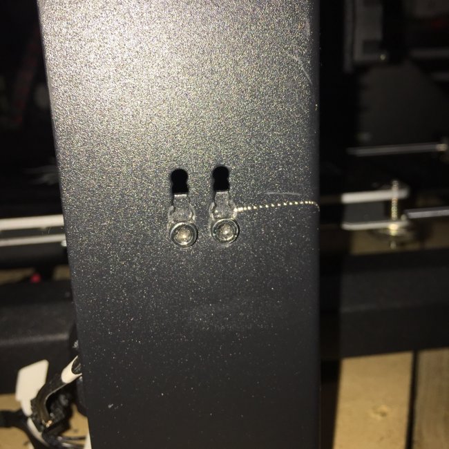

My only issue with the printer is leveling the bed. The dip switch for the Z access is too high, In my opinion. So, I decided to drill some lower holes in the frame, about 2mm below the original holes.
Why? I didn't like the fact that I had the leveling screws all the way out. The springs had almost no tension on them. This caused me to have to level the bed more than what I wanted.

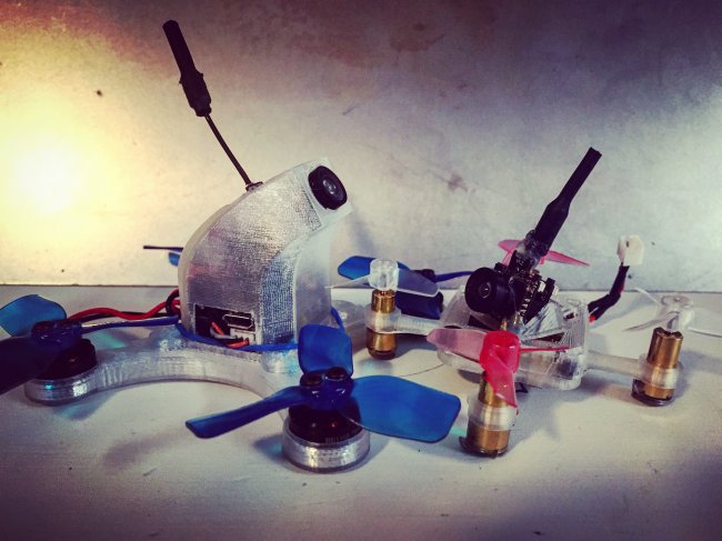

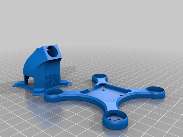

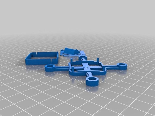

I'm including the links to 2 of my designs. One is my "VD" which is a 65mm brushed TinyKwad and my "TKO" which is 90mm Brushless TinyKwad.
If you haven't seen them fly I post video's on my instagram.
