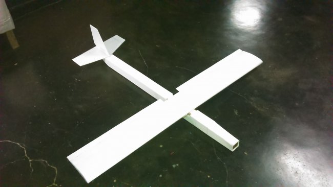

Second experience with flying rc plane.
Specification :
Wing span : 48"
Fuselage : 43"
Motor : D2826-6 2200kv Outrunner Motor.
Prop  : 6x4 Precision propeller.

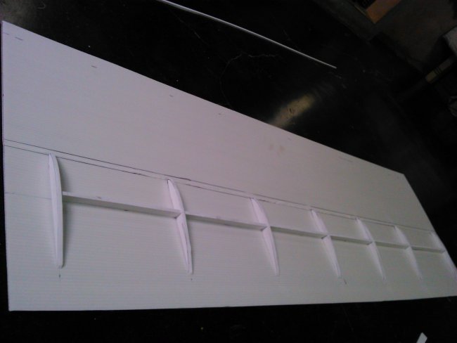

Some built pictures:

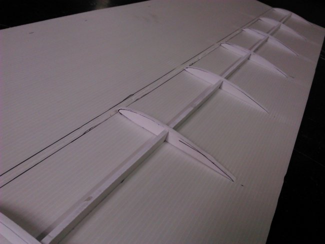

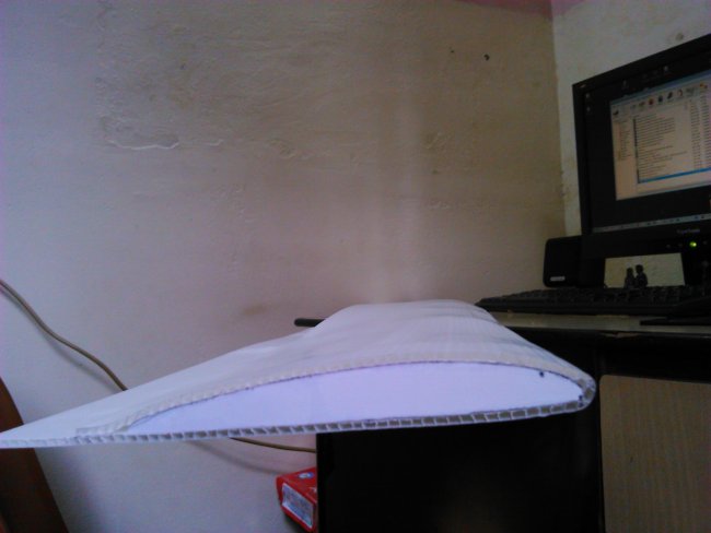

Thick form board is used for wing rib.
