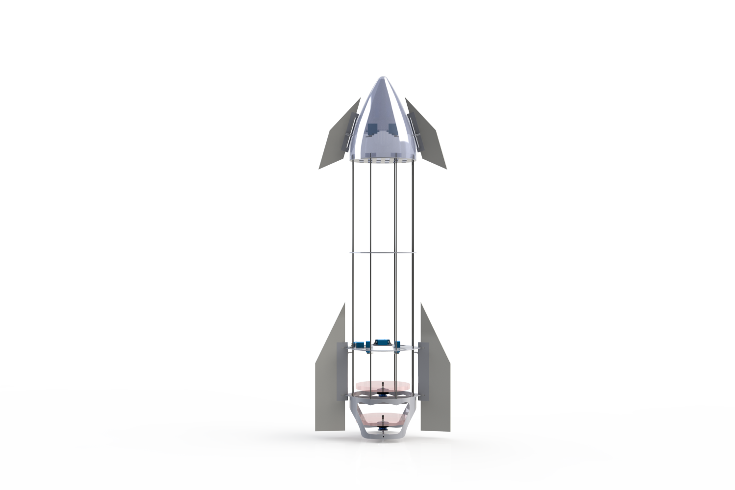

Designing in CAD

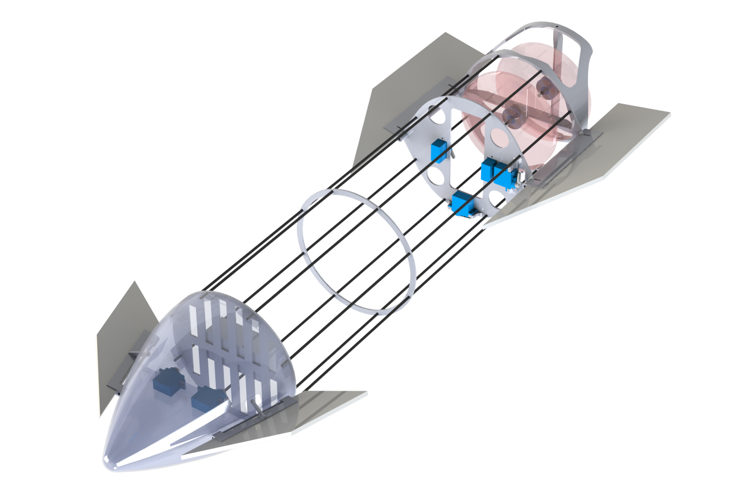

I used Solidworks CAD software to design all the parts for this vehicle. It is about 33" tall, and 5.5" wide to accommodate two miniquad motors in the bottom for thrust:
The benefit of designing in CAD first is that you can see how all the parts fit together to make sure it will actually work and be manufacturable. You can also assign masses to all of the parts to get a mass estimate and center of gravity estimate before you even order the parts. The mass should be roughly 850 grams, which is perfect for my two motors that can produce more than 1400 grams each. After moving some parts around, here is my center of gravity location:

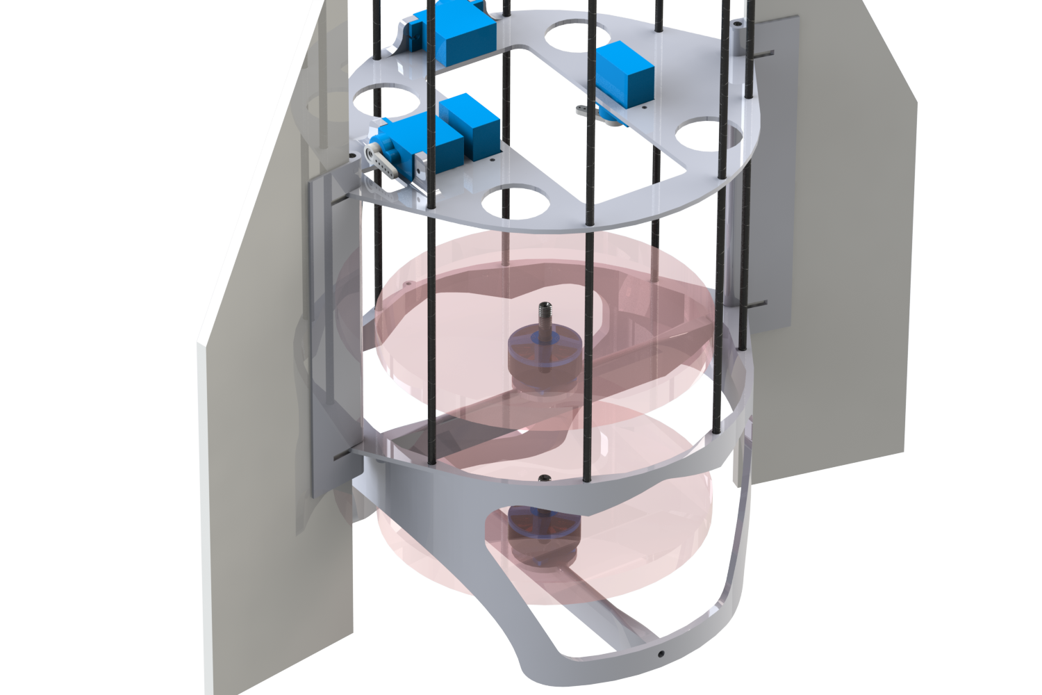

Here you can see the lower section in a little more detail. The two motors will pivot on their own axis for roll and pitch thrust vectoring control, actuated by servos from above.

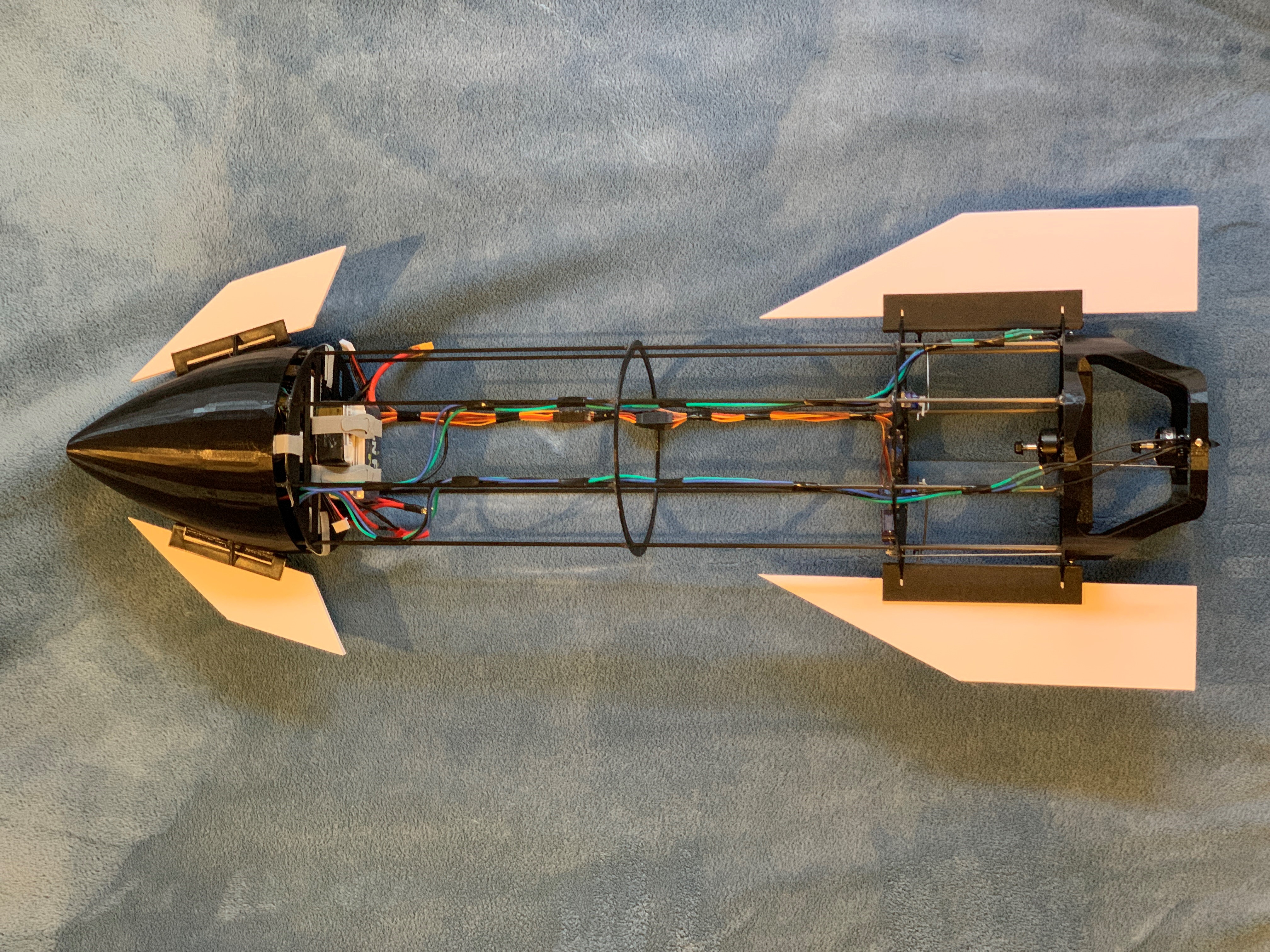

First, I threw all of the parts I designed on my 3D printer and printed them in PLA. The body spars are 3mm carbon fiber, and I cut the control surfaces from foamboard.
The cool thing about my design is that it is broken up into a few main subassemblies: the bottom motor mounts, a servo mount section, electronics section, and nosecone with canards. Then all of the subassemblies slide together over the carbon rods and can be pinned in place with your glue of choice; mine is hot glue so that I can easily remove it if I need to.
Here is the first subassembly: the motor mount section. Here, each motor is mounted to it's own axis of rotation that will be actuated by a 9 gram servo. This will give roll and pitch control in hover. They are spaced so that at maximum deflection, the 5 inch propellers cannot intersect and hit each other.
Next up is the servo section, which is used to mount the servos for roll and pitch thrust vectoring, and a servo for each rear control surface:

After sliding all these parts together over the carbon rods and pinning in place with some hot glue, I ran the wiring from the electronics at the top to the motors and servos at the bottom. I also installed the servos in the nosecone for the canards and put everything together:

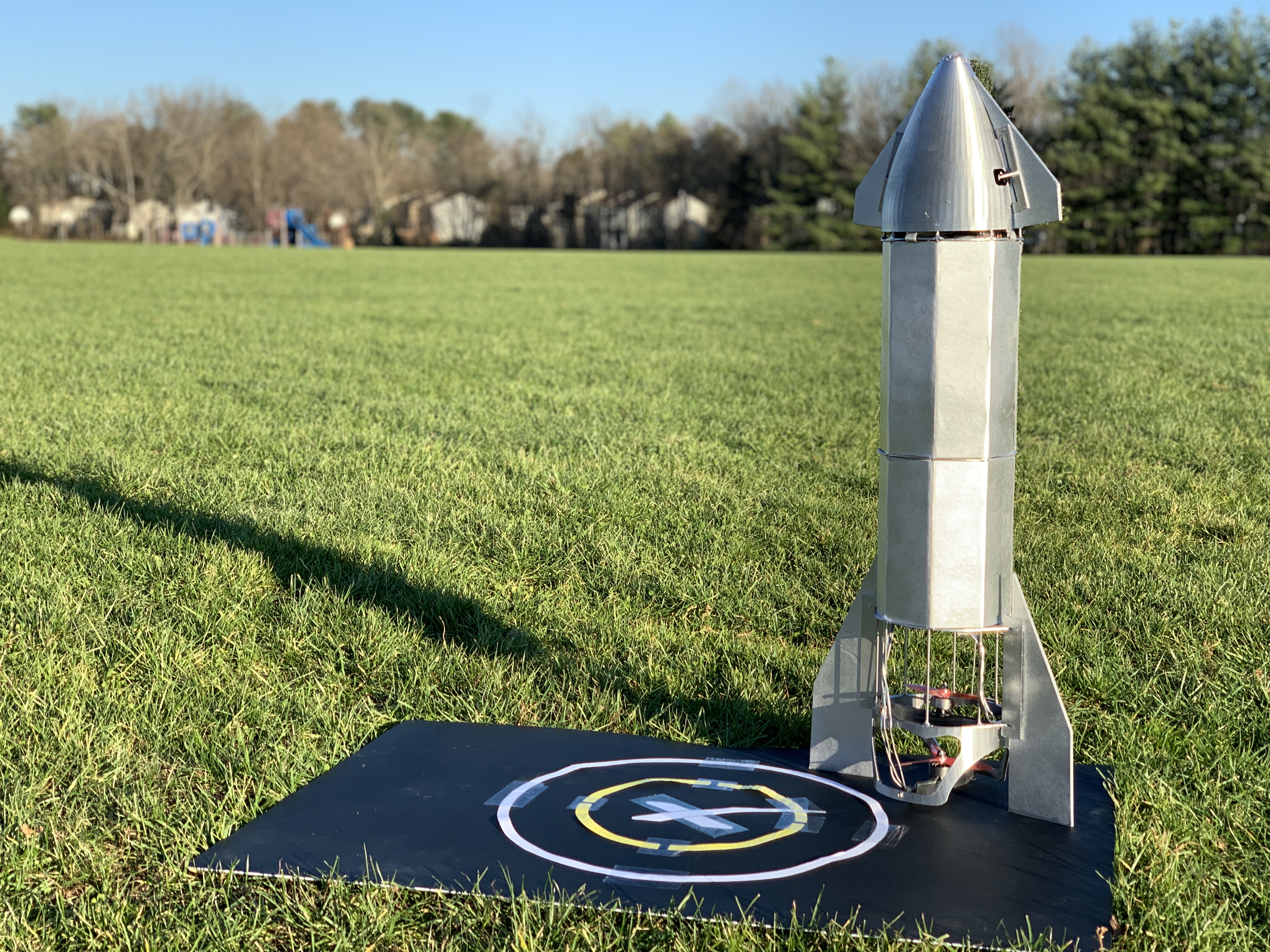

Next up, I needed to wrap the body in something. I chose some foamboard which also acted to torsionally strengthen the body. Then I added paint to match the real Starship:
And that completes the build! Lots of flight testing and PID tuning went into making it a flyable Starship model capable of the elusive belly flop maneuver and landing.
