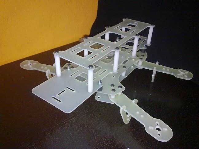

i bump to a blog named http://untestedprototype.com/ . Credit to the author who provide free plans
 I called my friend who had CNC machine to build it. The material is plain white G10, i choose not to paint it because it looks beutiful at night with LED light.
I choose GO Mini Quadcopter because it can be upgrade with Go Pro

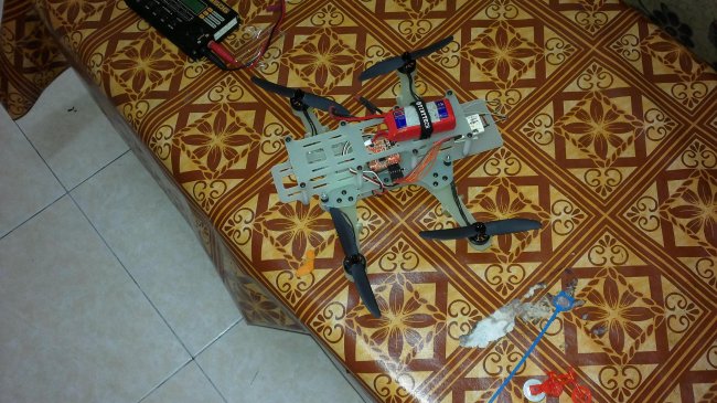

This is one of the prototype that my friend finished to built it
For the power setup i choose
ZMR 2400kv motor
10 Amp SS ESC
1300maH Gen Ace Lipo
5x6 Genfam
and lastly Acro Naze 32
For FPV setup
Just Predator Google n 250 Fatshark
Keychain camera
AUW is only 540 gram including FPV Gear
Yeah Acro Naze seems easy to setup, This is my maiden flight with Acro Naze
