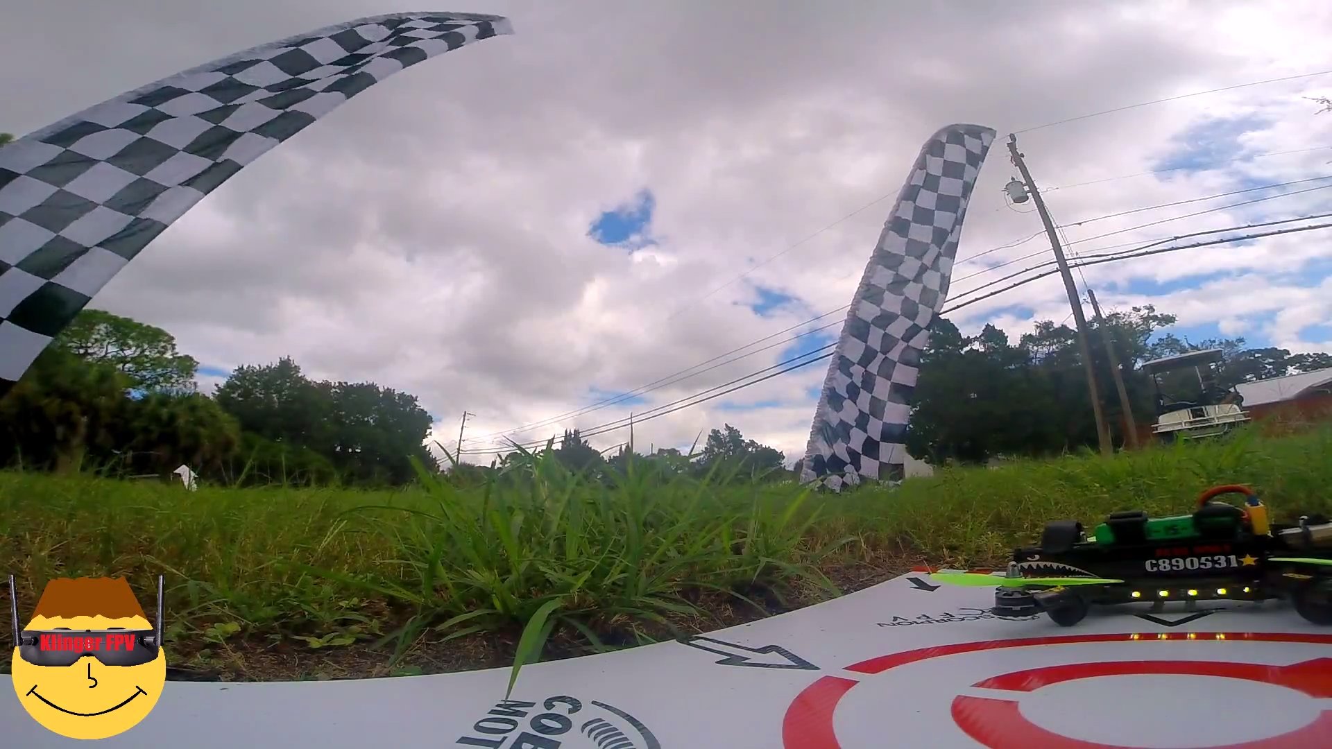

Takeoff/Landing Pad
 This is the first thing seen, so it should look good. You can make the takeoff/landing pad from coroplast. This can be gotten from your local hardware store. Or you can get it online here: http://thd.co/1QTfxdn
If you want your landing pad to look even better, you can use vinyl stickers. Vinyl can usaully be found at the dollar store or you local hardware store. Or you can get it online here: http://amzn.to/1Vzl4Hw

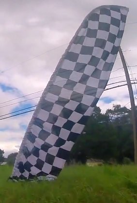

Flags
Flags can be used to mark the start and finish of a race, or for turn markers. Our flags were made out of checkered fabric purchased at a local fabric store. You will also need some PVC pipe from you local hardware store. Both of these can be purchased online.
Fabric: http://amzn.to/1QTg27q
PVC Pipe: http://bit.ly/1JNn4Fl
 Simply sow a sleeve slightly larger than the PVC pipe down the length of the fabric (if you don't know how ask your grandma). Be sure to put a slight curve in this sleeve, so that it fits right on the bent pole. The curve in the sleeve is not mandatory, but it does create a better looking result. Now for the PVC pipe. Using a heat gun (or some other heat sorce) heat up the end of the pvc pipe. You want to do this a little at a time, so the pipe remains flexible. Heat about a 6" section and bend it with a pair of pliers. Repeat this as much as you want, to creat a bend that you like. Then stick the PVC pipe into the ground and slide the fabric over it. BOOM! You now have yourself a racing flag, for cheap too.

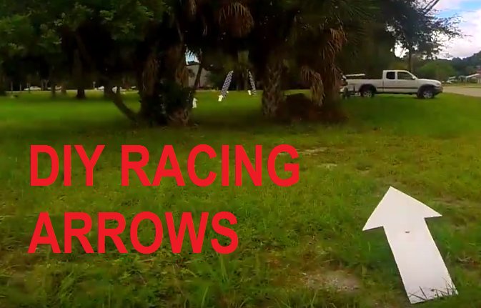

Arrows
Arrows help you know were you to go, and make it seem like your going super fast. They ad a super cool element to your videos. You need coroplast and some kind of stake, we used the stakes for your usual coroplast signs. Both of these should be available at local home improvement stores or hardwares stores. They are both available online as well.
Coroplast: http://thd.co/1QTfxdn
Stakes: http://amzn.to/1VzmhOZ
Take the coroplast and cut it into arrows. Then drive the stakes into the ground and put the coroplast arrow on it. Plan on making a lot of these, because you need a bunch for a ny good sized course. You can also simply lay the arrows on the ground if you're in a hurry or on an ultra tight budget.

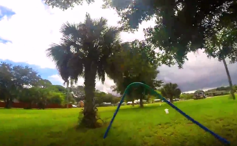

Air Gates
The gates ad an element of difficulty to your course. Trying to line up and shoot through the gap is super fun! You will need some 3/4" PVC Pipe and 3 pool noodles for every gate. The pool noodles are available at the dollar store, and the PVC pipe is wating for you at your local hardware store. Both are also available online.
Pool Noodle: http://amzn.to/1Ma4YiF
Our gate was made using two, five foot sections of pvc pipe and 3 pool noodles. The two sections of PVC pipe are driven into the ground at an angle, then you slide one noodle over each pipe. A third noodle is then slid over the exposed end of the pipe the join the two pieces together, forming the gate. I have found blue noodles to be the most visible, but you can experiment and see what works best for you.
