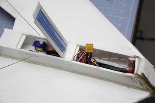

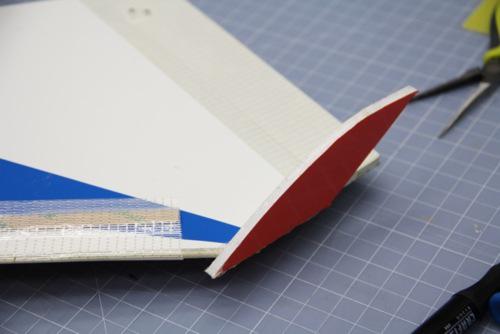

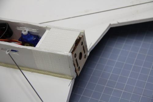

Ever since the 100MPH under $100 episode we’ve received many requests for the FT Speedwing design. While it’s not a step-by-step tutorial, I hope the dimensions, parts list and photos will help…   “Speed Wing” APC style propeller 8x6-E [$1.00] http://www.hobbyking.com/hobbyking/store/uh_viewItem.asp?idProduct=5438&a… TowerPro Brushless Outrunner TP2409_12D [$13.81] http://www.hobbyking.com/hobbyking/store/uh_viewItem.asp?idProduct=4899&a… 2 X HXT900 9g / 1.6kg / .12sec Micro Servo [$5.38] http://www.hobbyking.com/hobbyking/store/uh_viewItem.asp?idProduct=662&af… TURNIGY Plush 30amp Speed Controller [$11.54] http://www.hobbyking.com/hobbyking/store/uh_viewItem.asp?idProduct=2164&a… Turnigy 1800mAh 4S 20C Lipo Pack [$13.99] http://www.hobbyking.com/hobbyking/store/uh_viewItem.asp?idProduct=9761&a… Shaft adapter to suit 3.0mm motor shaft (collet) [$1.99] http://www.hobbyking.com/hobbyking/store/uh_viewItem.asp?idProduct=5677&a… Hobby King 2.4Ghz 4Ch Tx & Rx V2 (Mode 2) [$22.99] http://www.hobbyking.com/hobbyking/store/uh_viewItem.asp?idProduct=8338&a… Foam Board [$1.00] Packing Tape [$2.69] Control Horns [$1.00] TOTAL: $75.39 It looks a little rugged here. We added lights and flew it in the dark. Eventually it hit the ground.
