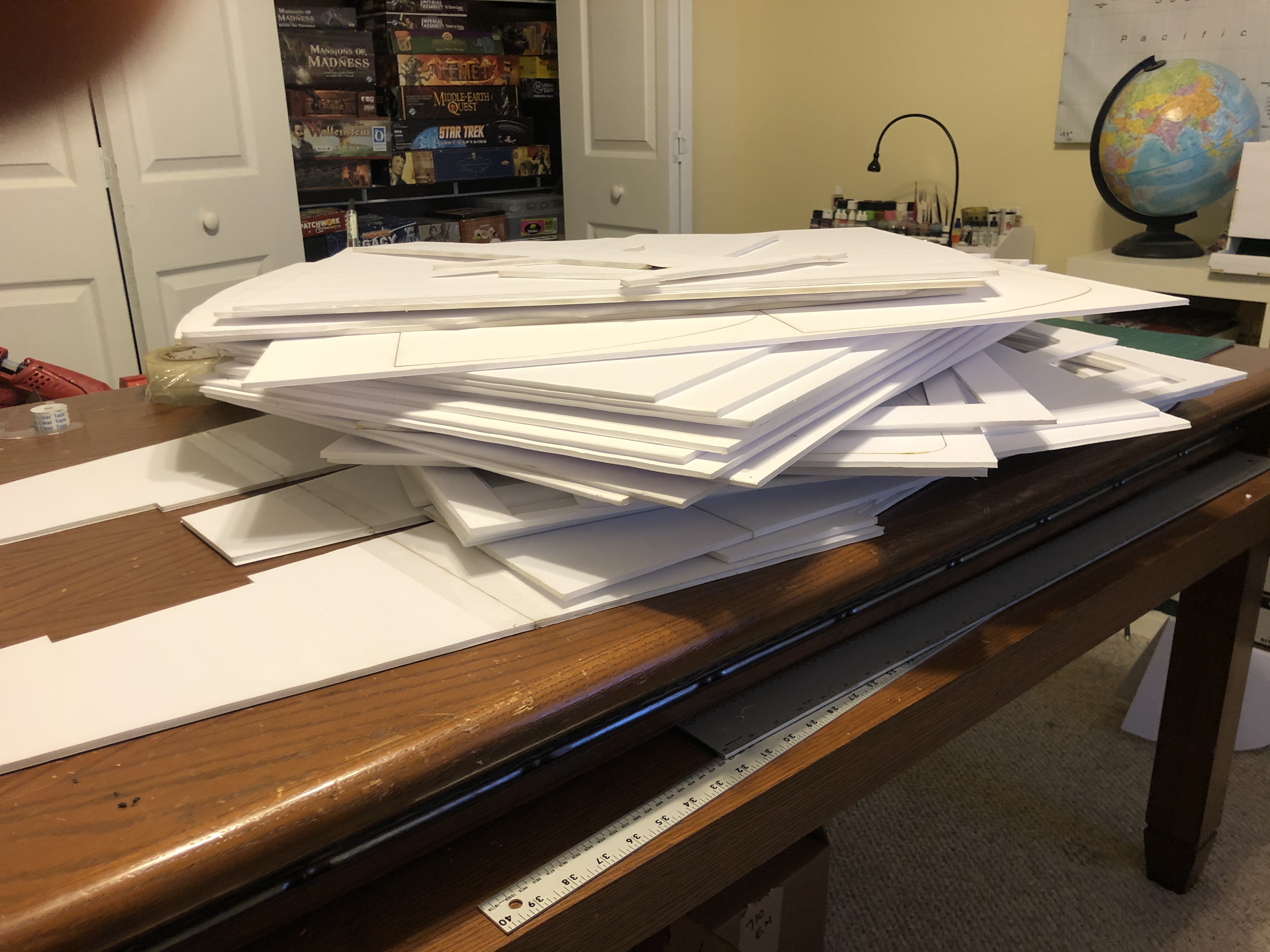

33 sheets of foam later.

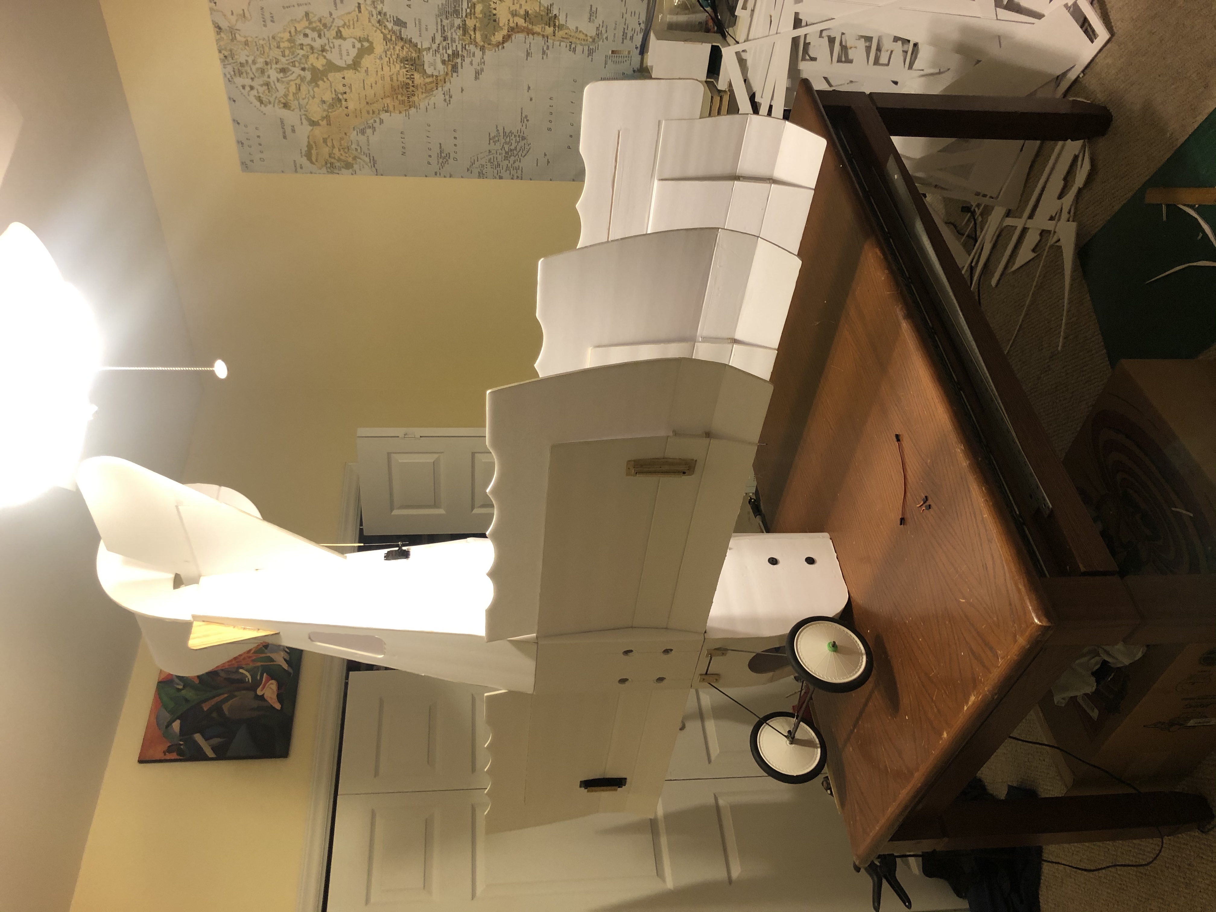

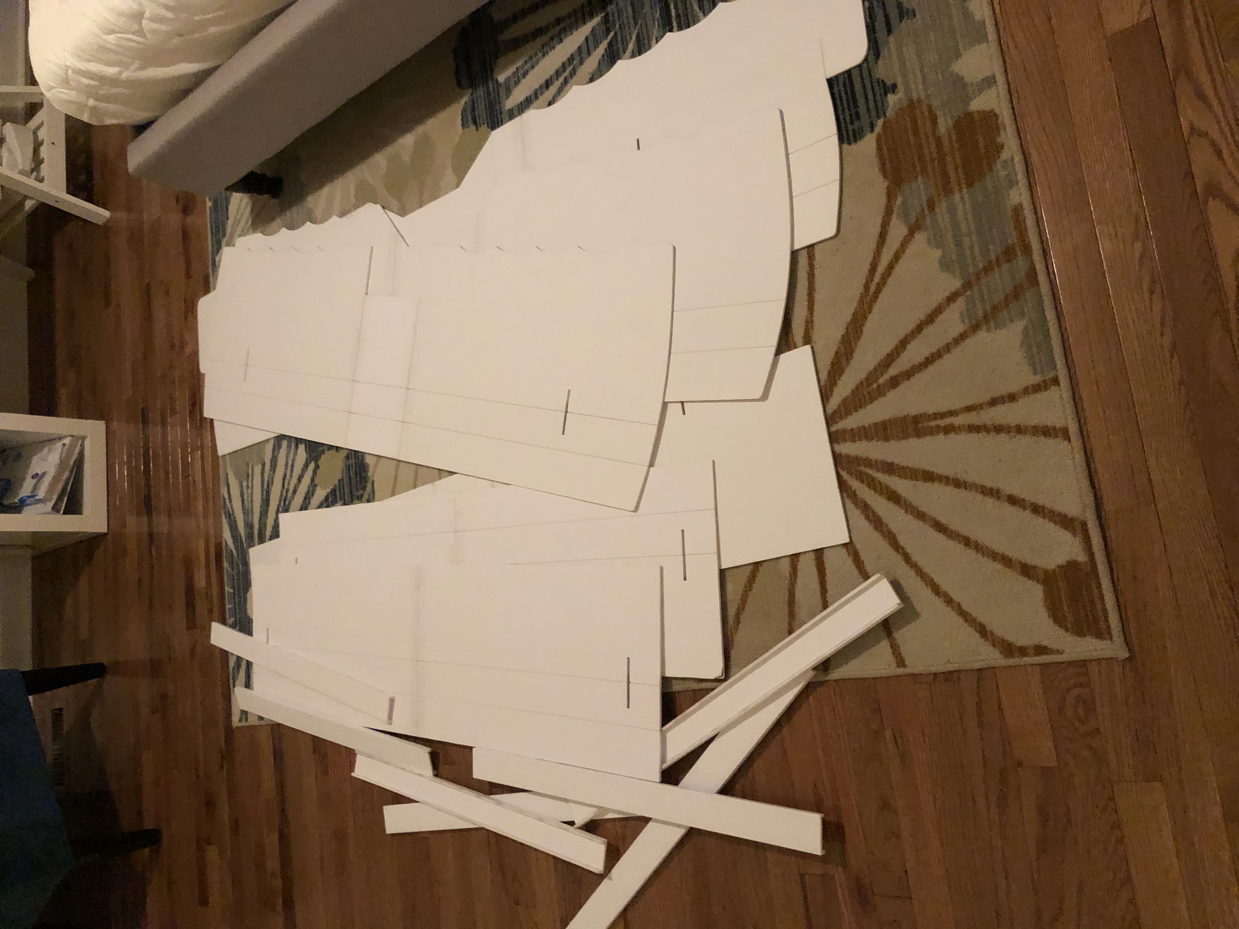

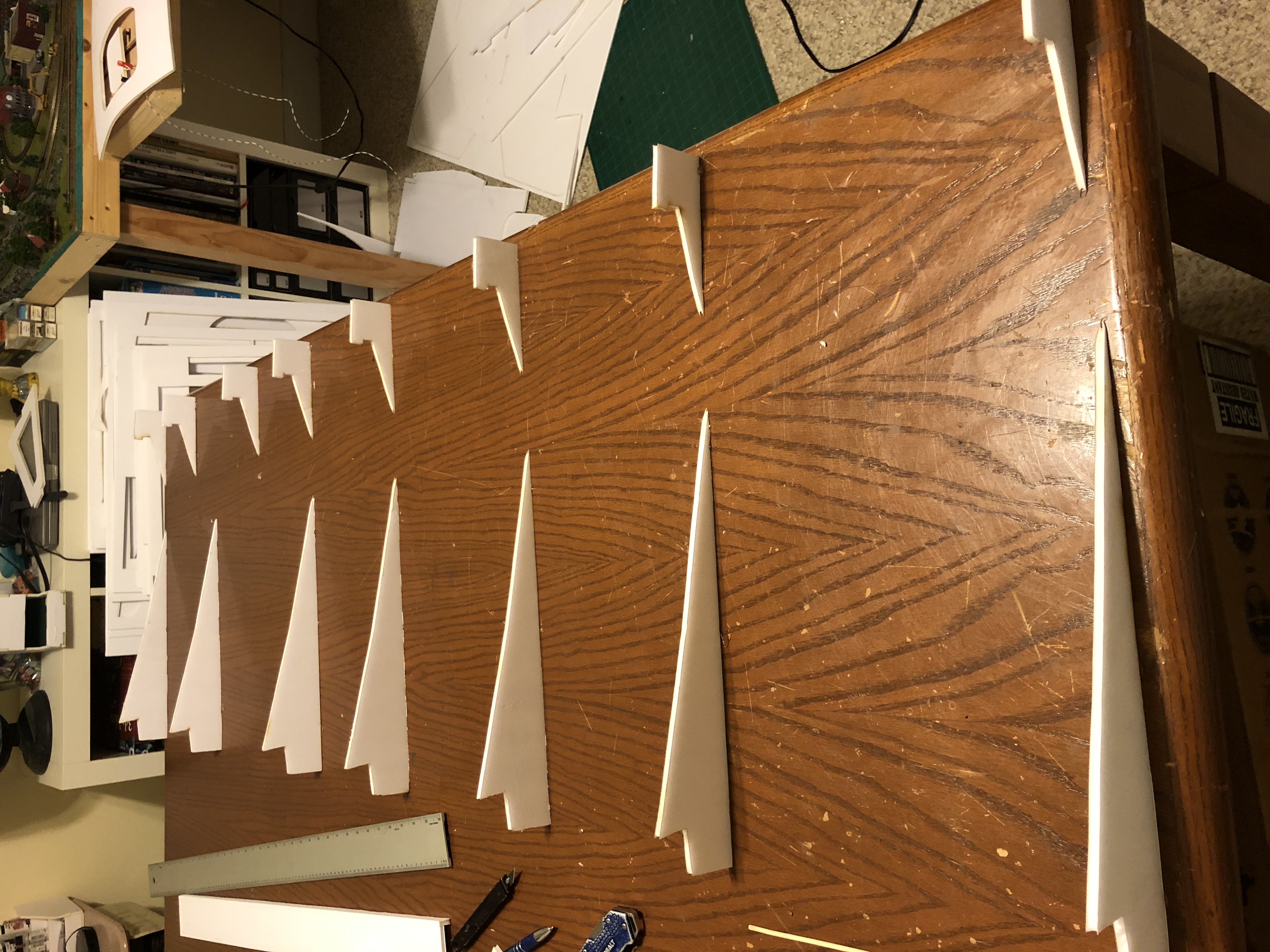

Wing parts.
Wing rig.
Wing rig with one of the wings

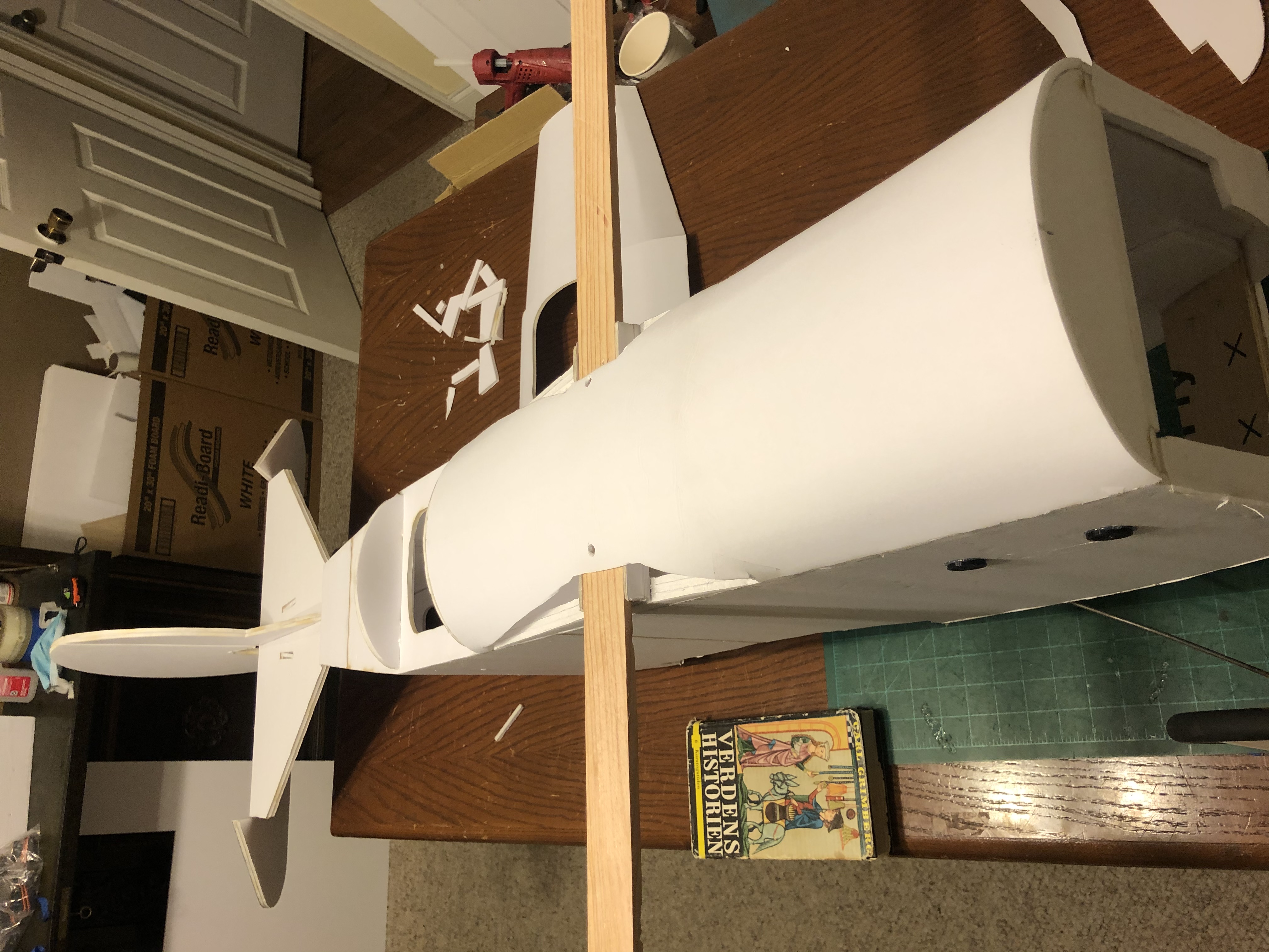

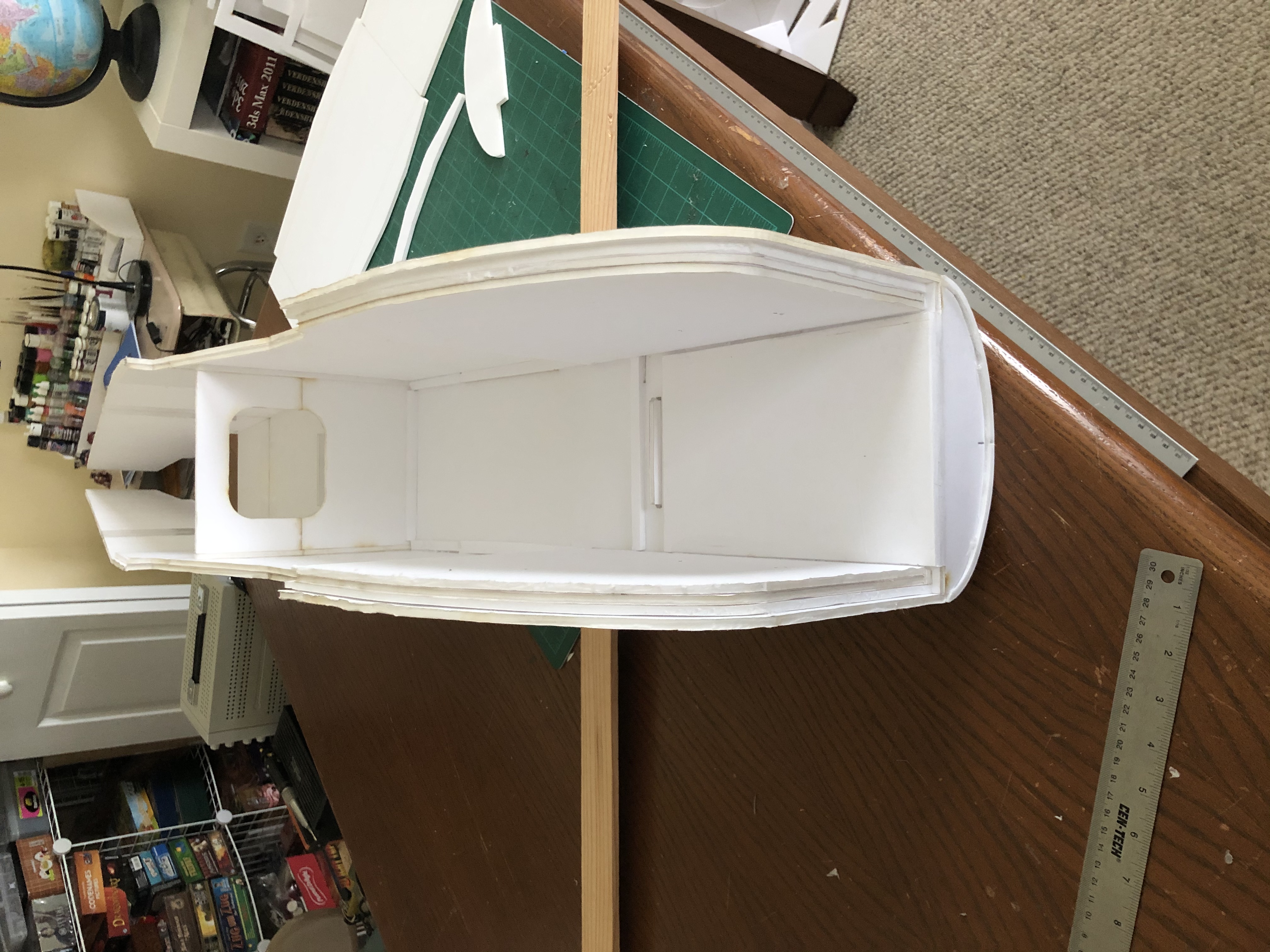

Fuselage

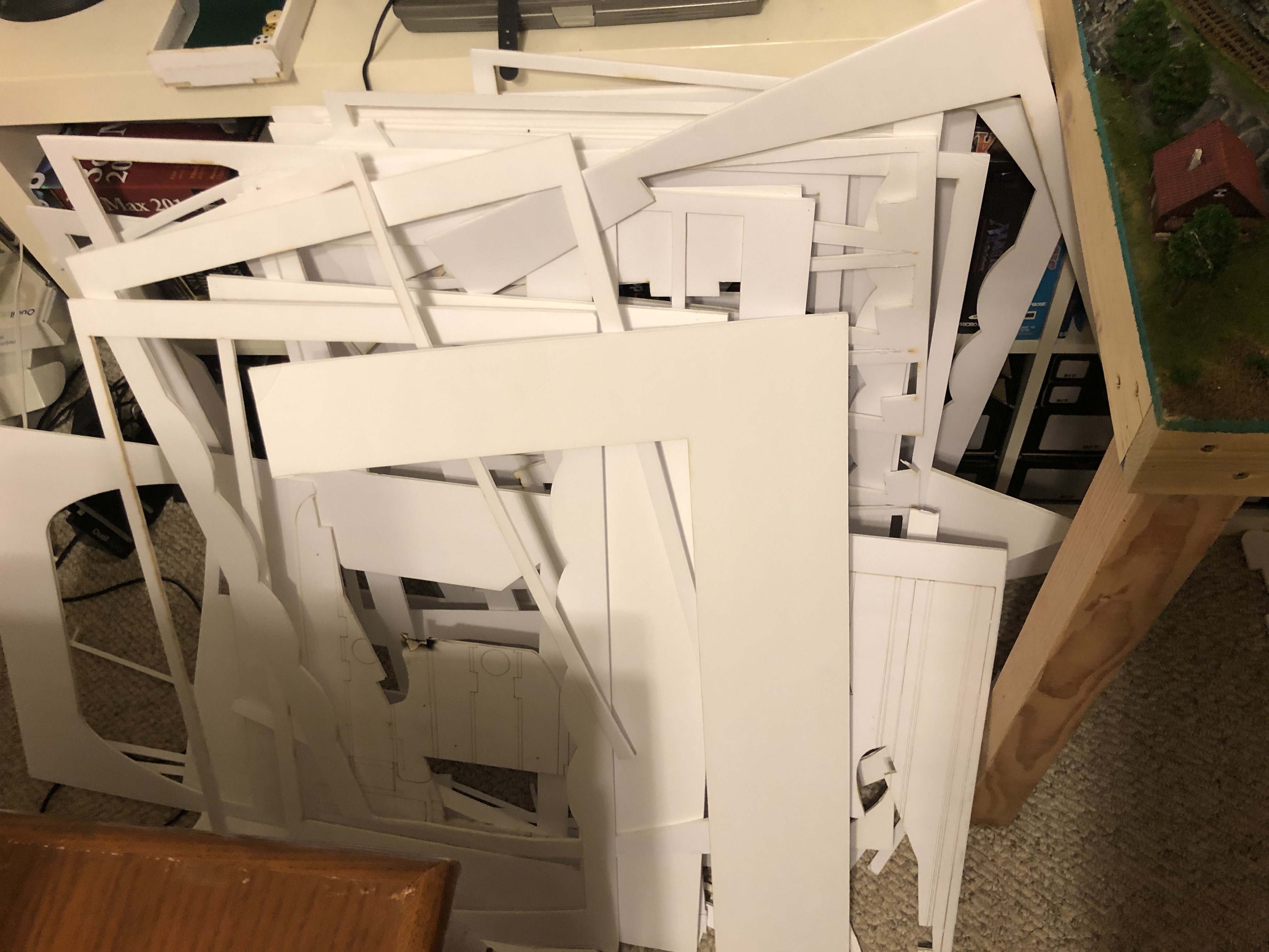

Lots of scrap foam

Under cambered wings

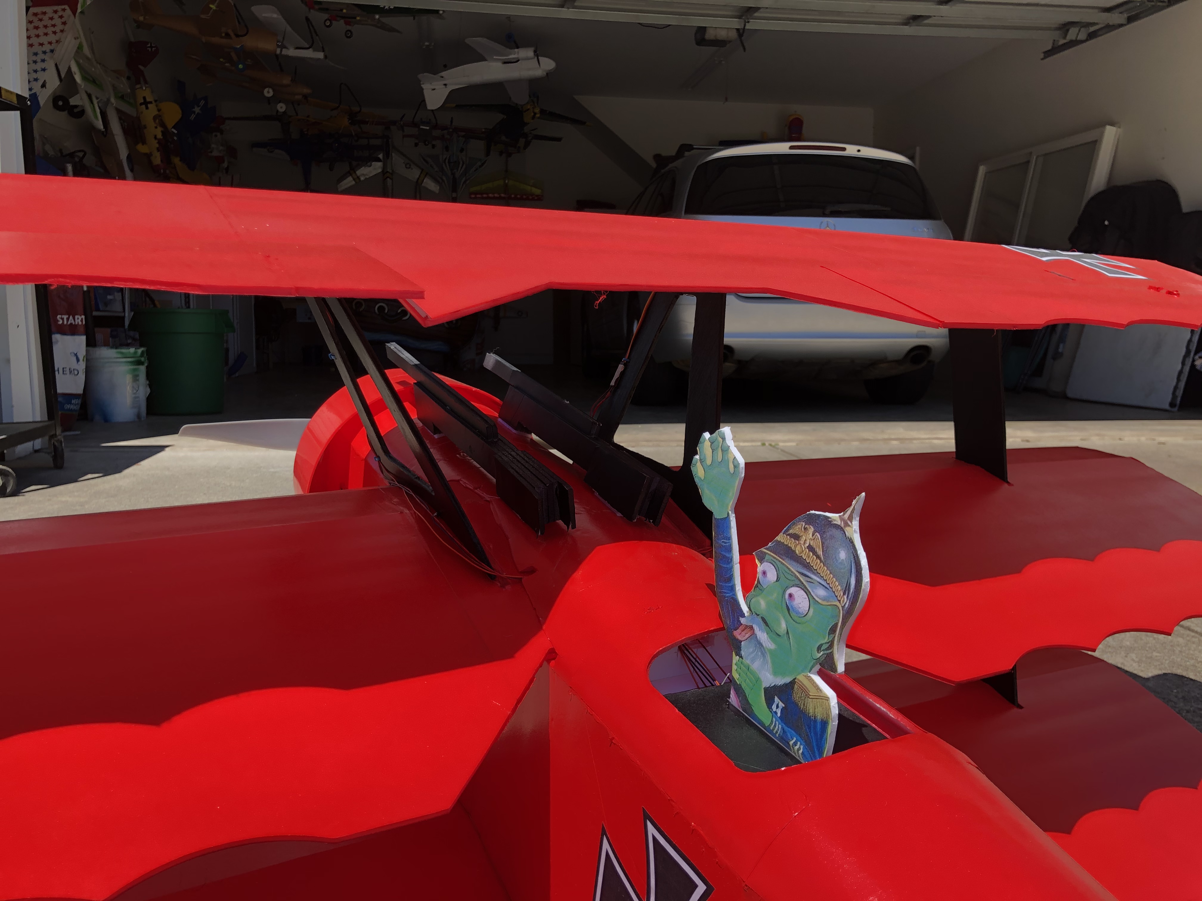

Paint scheme
The Pilot
