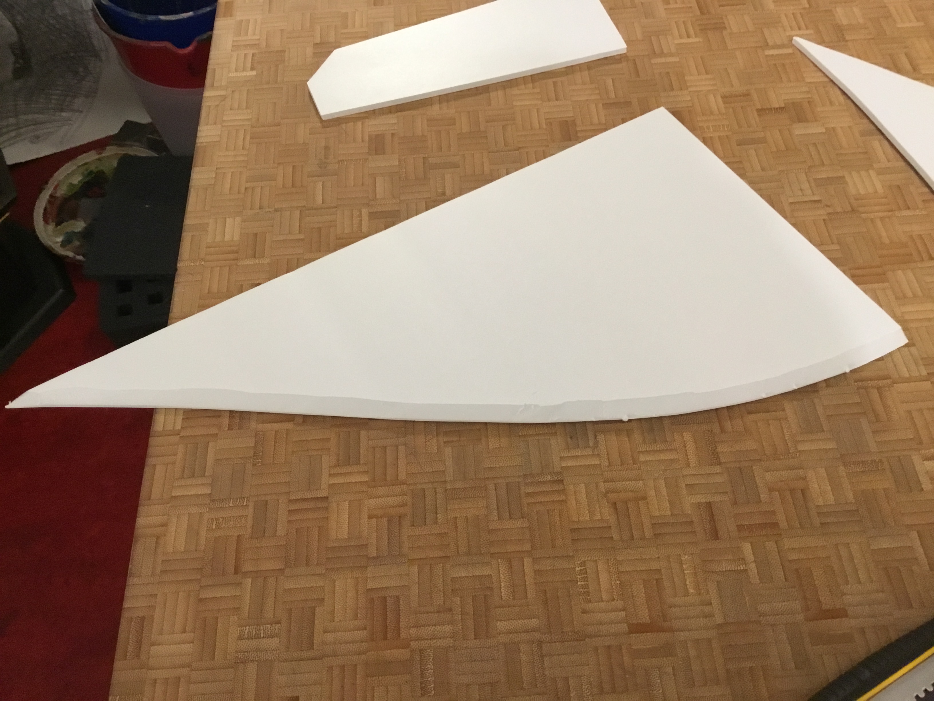

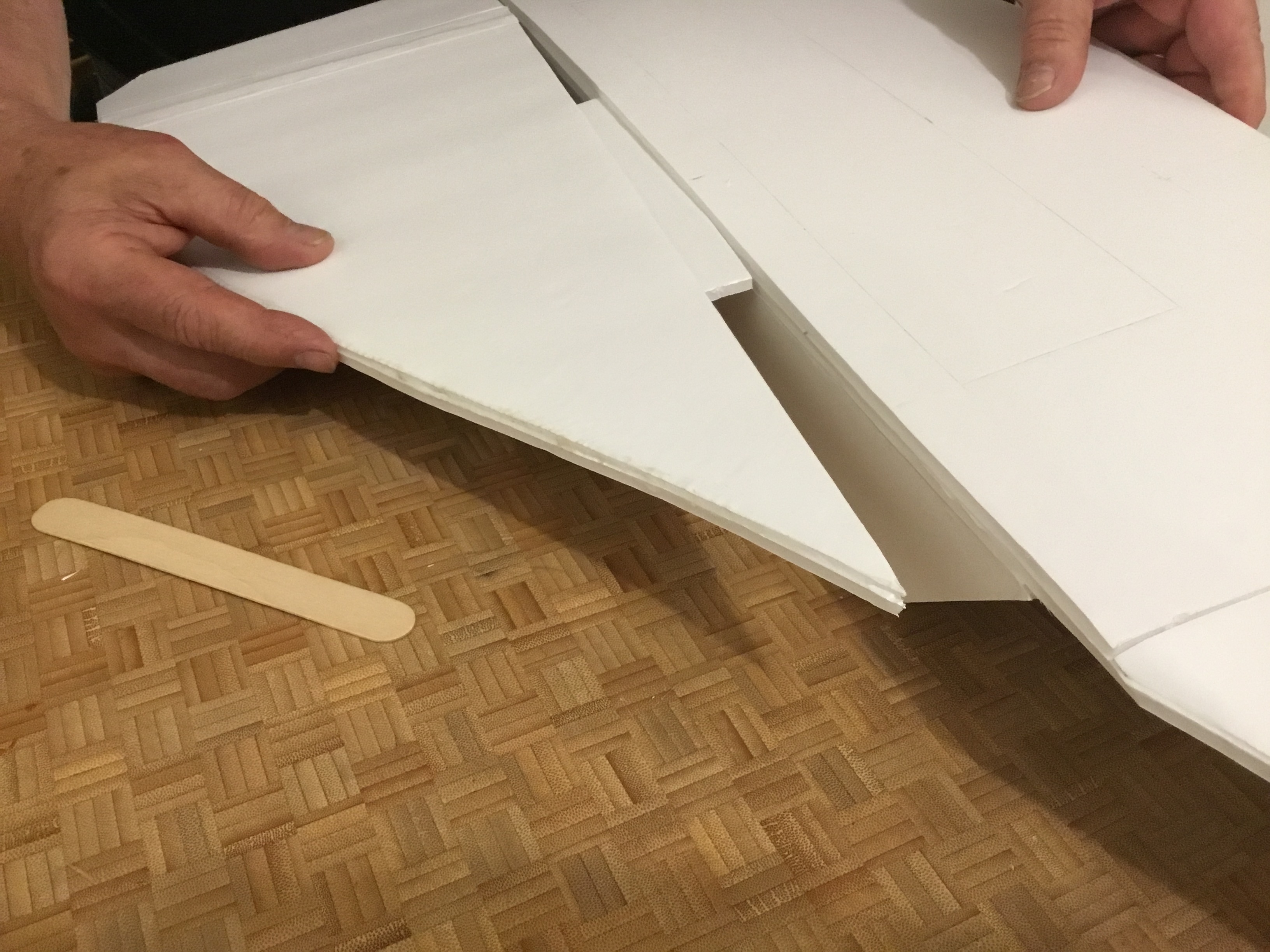

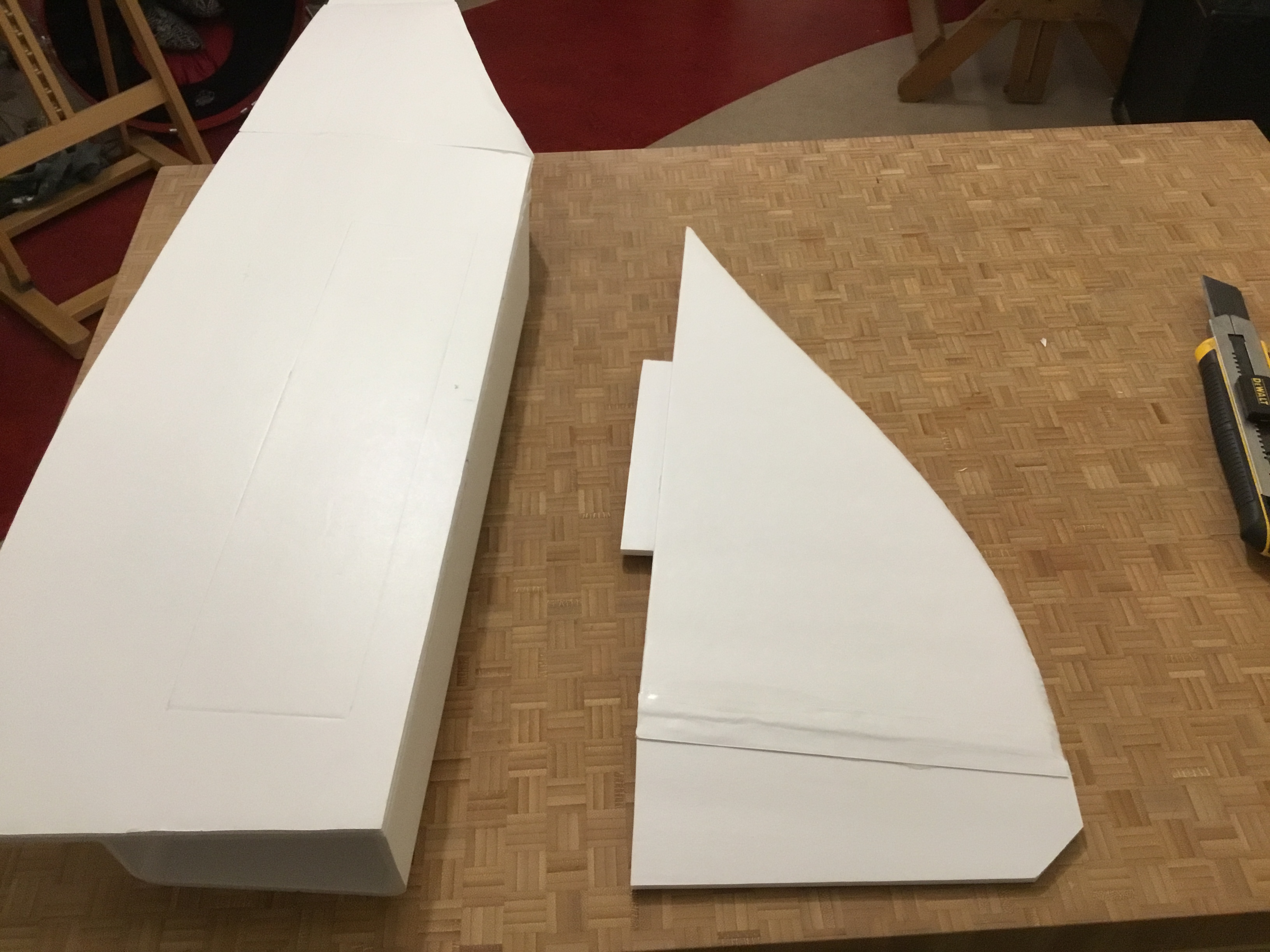

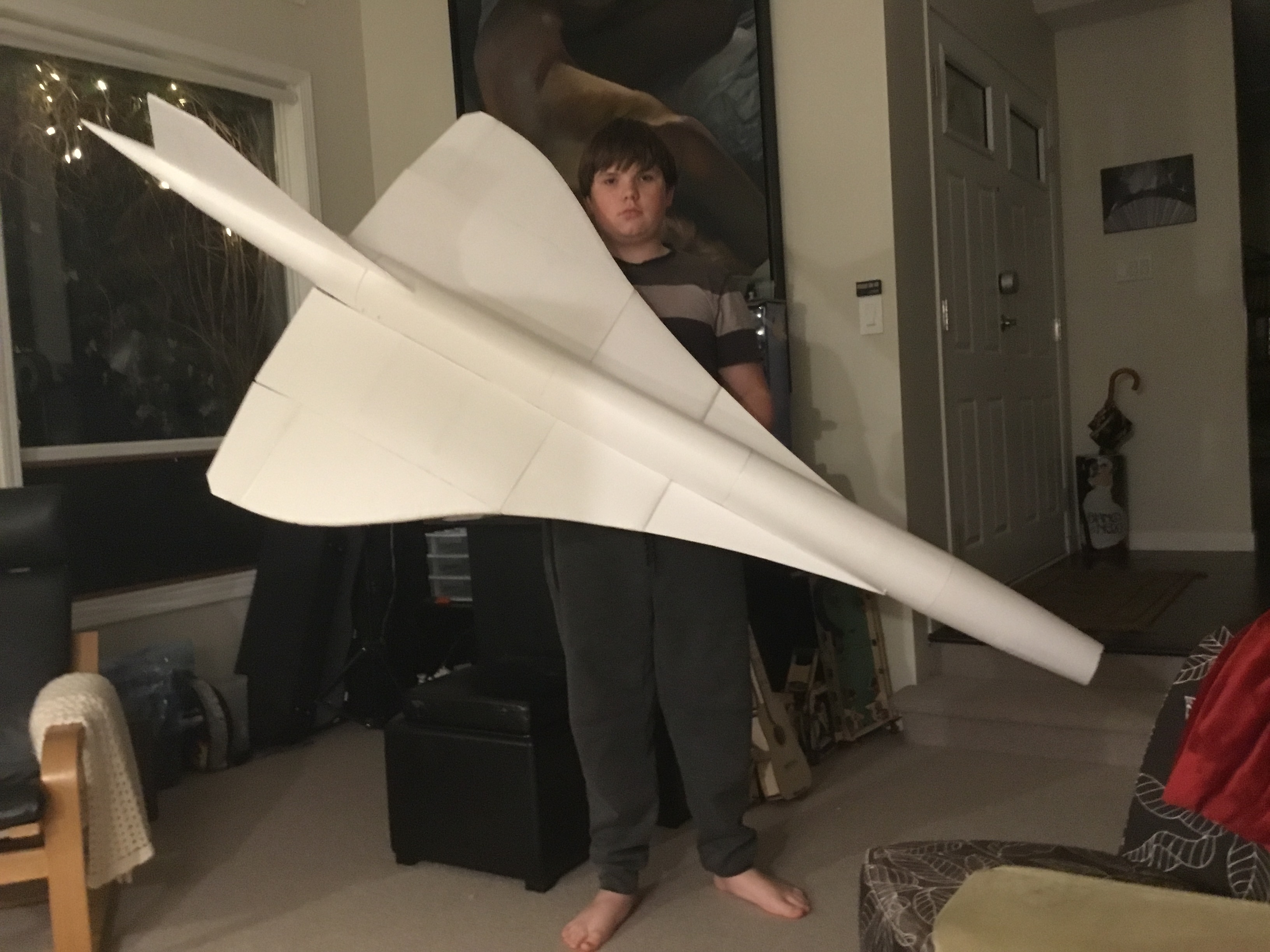

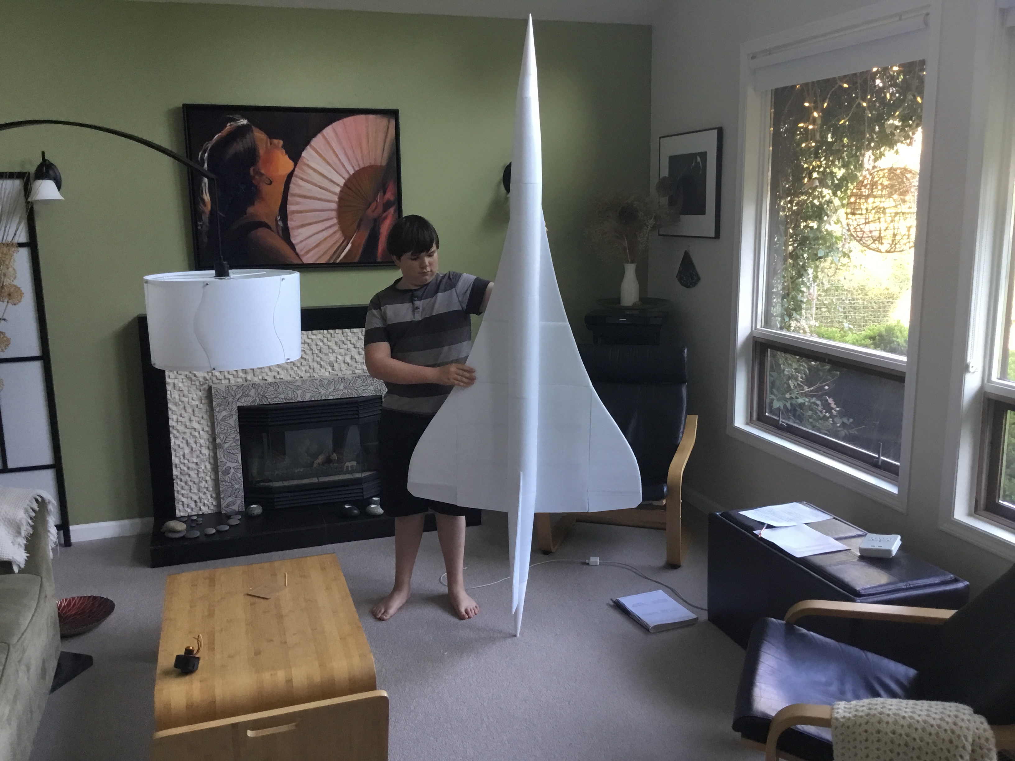

It is now 2021 and I am 14 years old. I just barely remember seeing the Concorde. But now here I am, combining my recent hobby (Radio Controlled Aircraft) with this amazing aircraft, building an eight-foot long, 1/26 scale, foam board replica of the Aerospatiale/BAC Concorde.
My grandfather and I build a lot of RC aircraft together. So far we’ve finished 20, and 3 of them have been “scratch” builds - no plans, no kit, just measurements taken from whatever photos and drawings of the planes we could find on the Internet. It is a really slow process because my grandfather and I need to engineer almost everything.
So far this project has taken around a month from start of build to finished airframe. And we still have to a few days left to go.

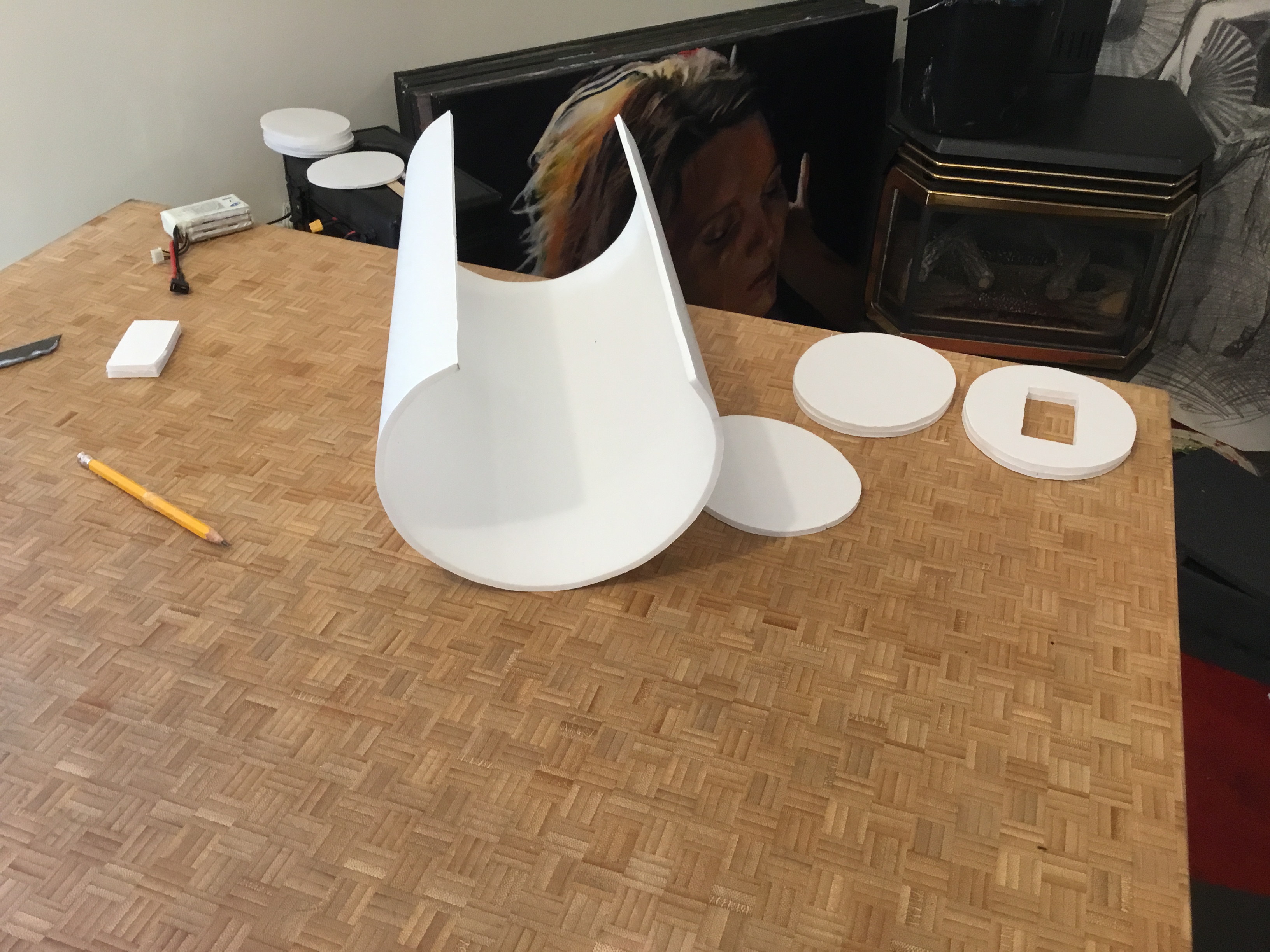

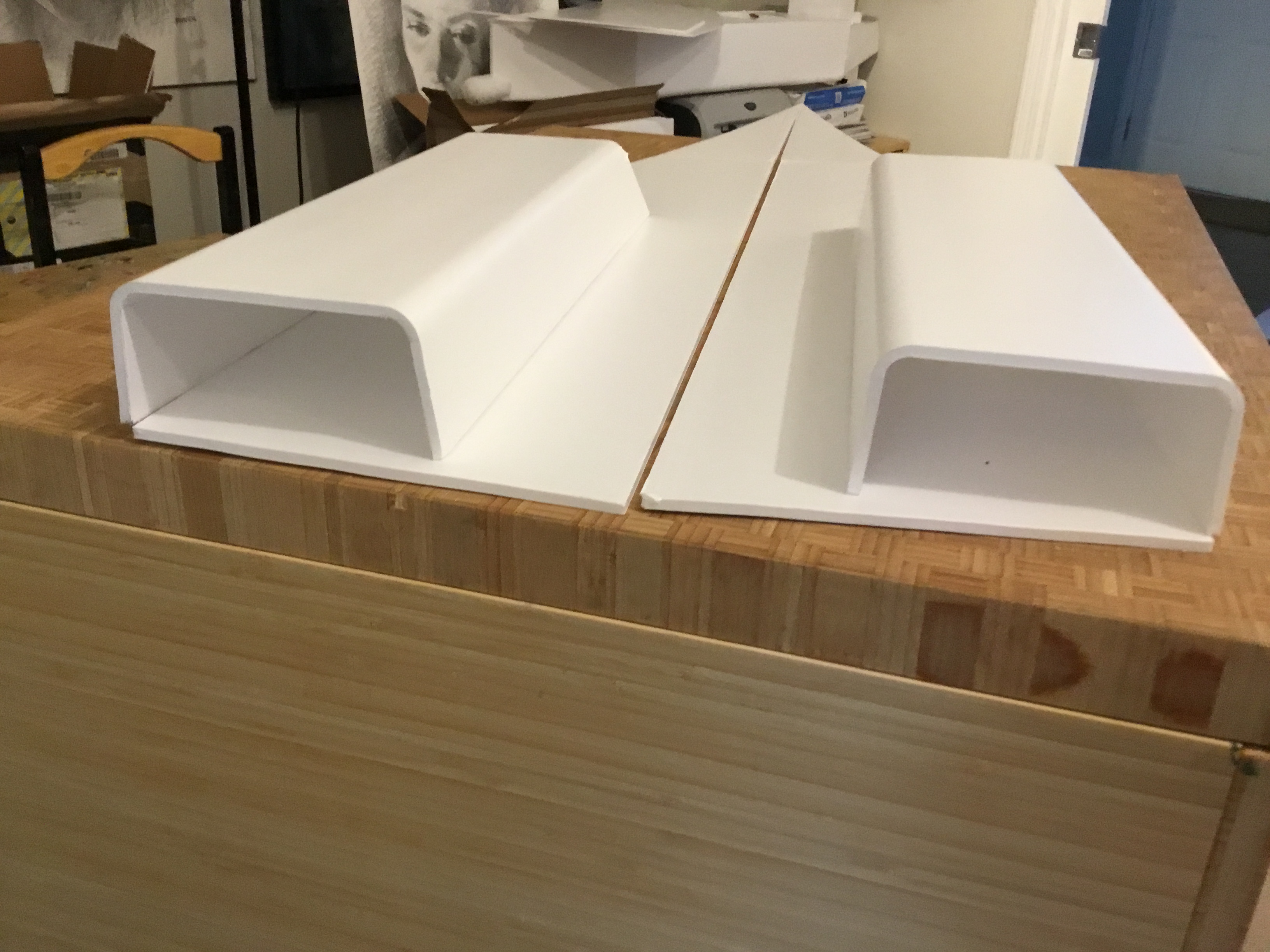

When it’s done, our RC Concorde will feature two medium sized electric ducted fans as engines, a drooping nose, and (hopefully) landing gear. We’re starting off with less of a drooping nose for the first flight because we don’t want it to get stuck in the ground when I land!

FoamyDM on June 28, 2021
That is some good work!
What motors did you put in this bird?
Sounded Like Small edfs. (30mm)
You should be proud of it.

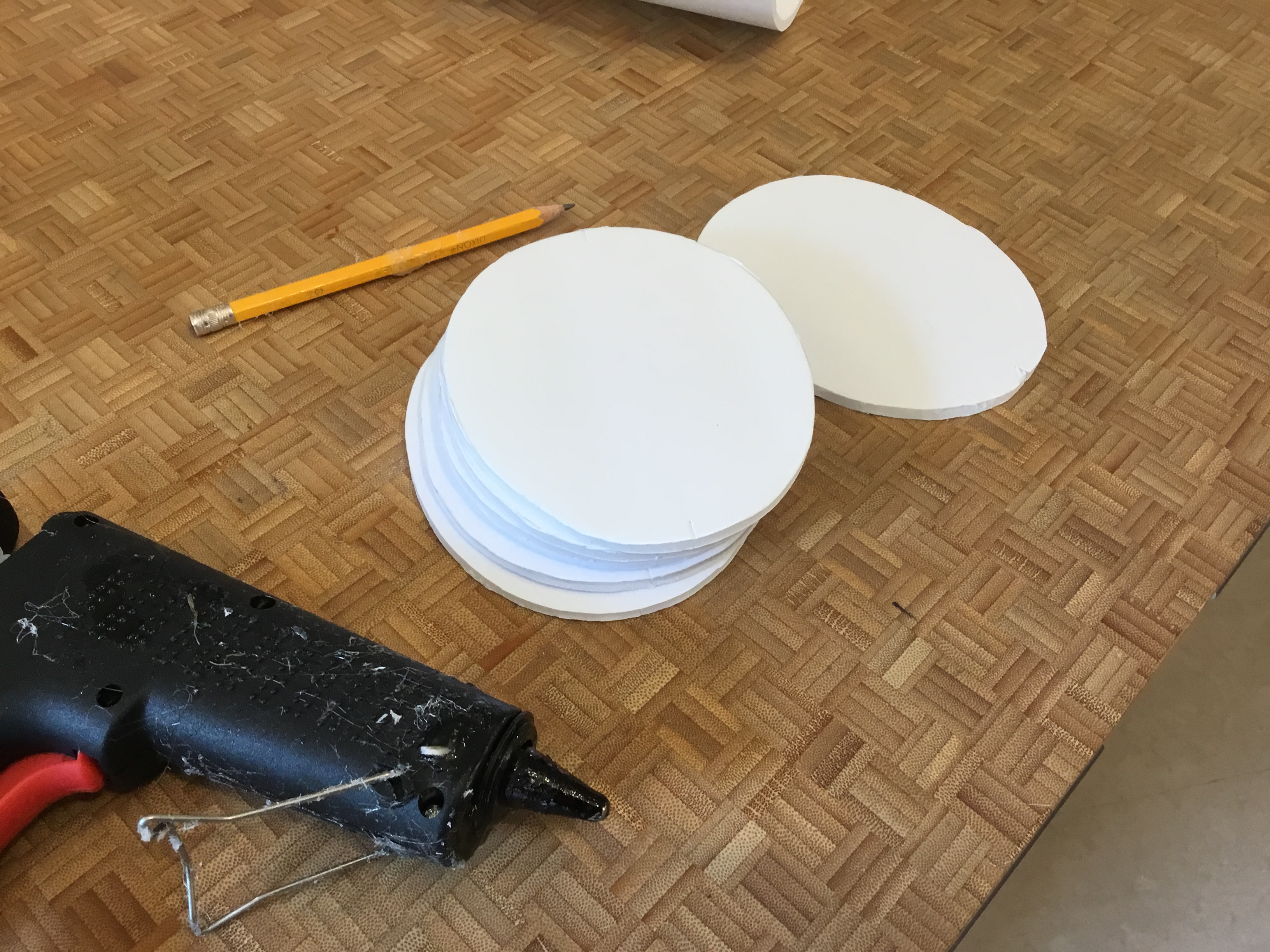

It actually has twin 64mm jets running off two 35amp ESCs with a 2200mAh 4 cell 120c
