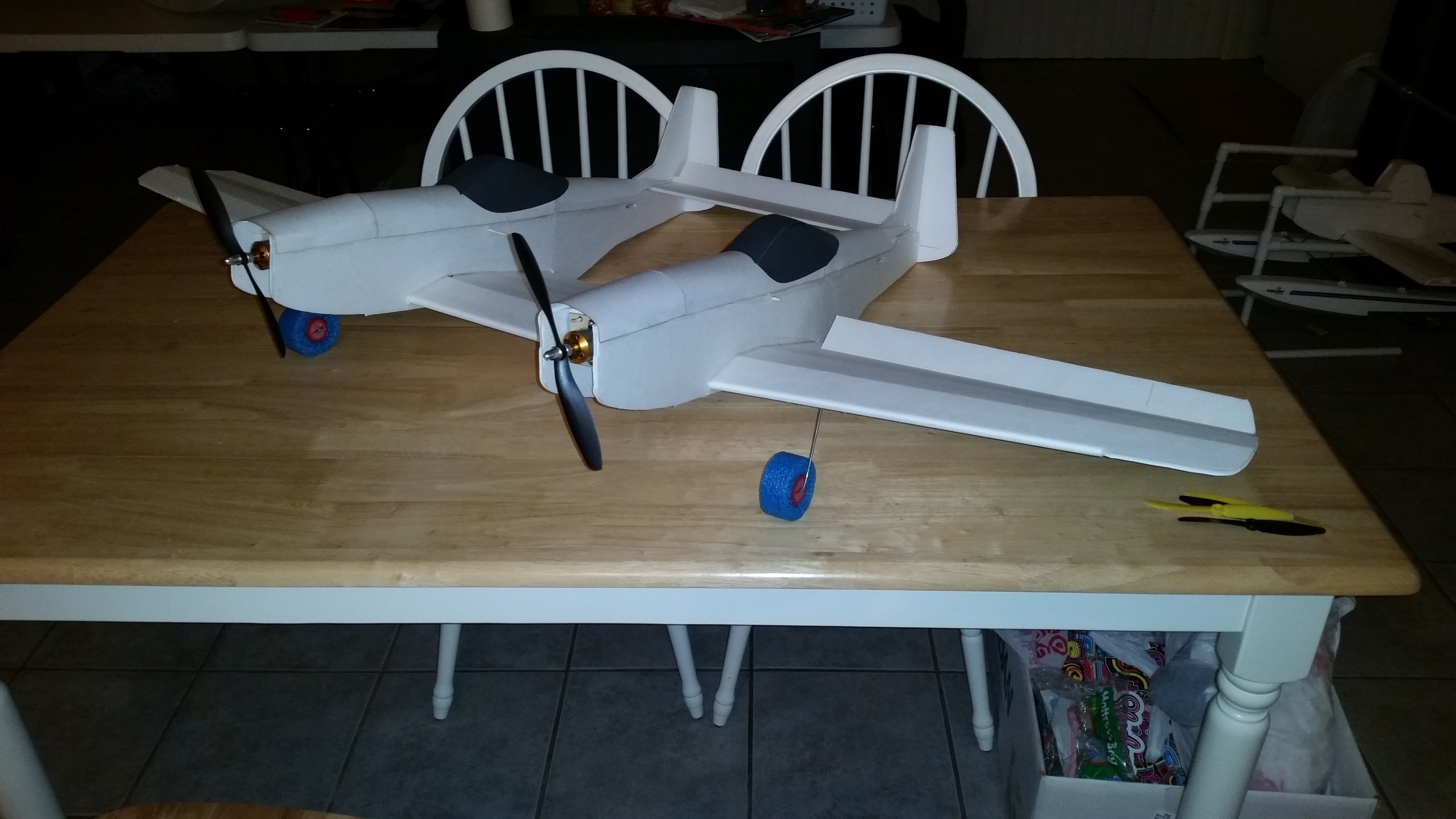

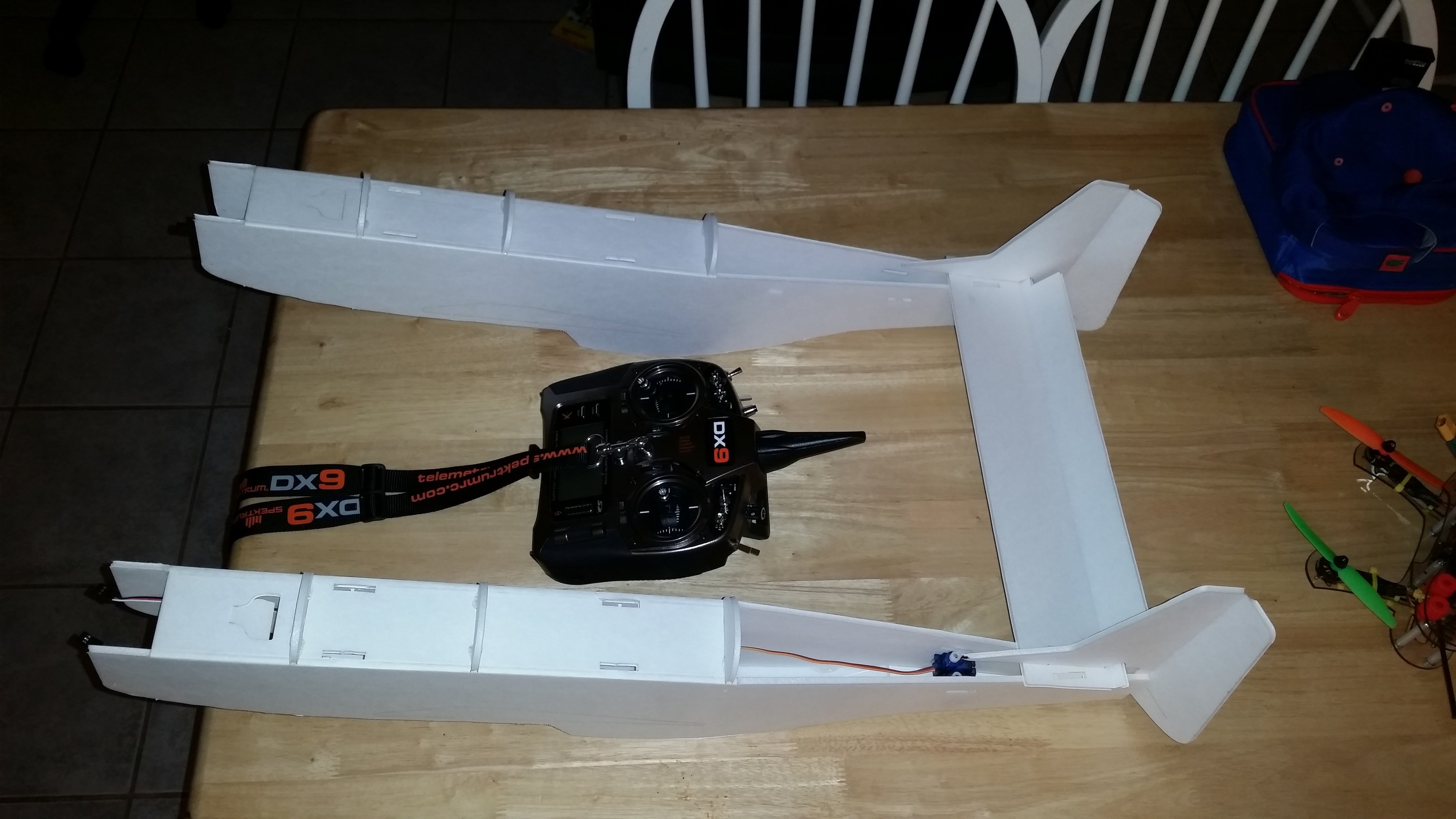

I loved the FT-Mustang so much that I wanted more.  It flew so great, straight lines, and awesome landings.  Why not twins.  I saw the FliteTest Facebook picture of theirs, that they haven't done a video on yet, and, well, here is mine.  I lengthened the ailerons, because, one thing I didn't like about the FT-Mustang, was the slow rolls.  Well, this version has NO PROBLEM with rolls.  It is super fun in "CRAZY MODE" or Differential Thrust as you will see in the video.  And, it still has all the wonderful qualities that the FT-Mustang had, with MORE POWER (Grunt, Grunt).
Electronics:
(2) 2212-10 suppo motors
(2) hobbyking plush 18A Escs
(2) 8x4 props
(2) 2200mah 3cell batteries wired in parallel (kinda) (one to each ESC)
FREE PLANS: Twin Mustang Plans - Dropbox

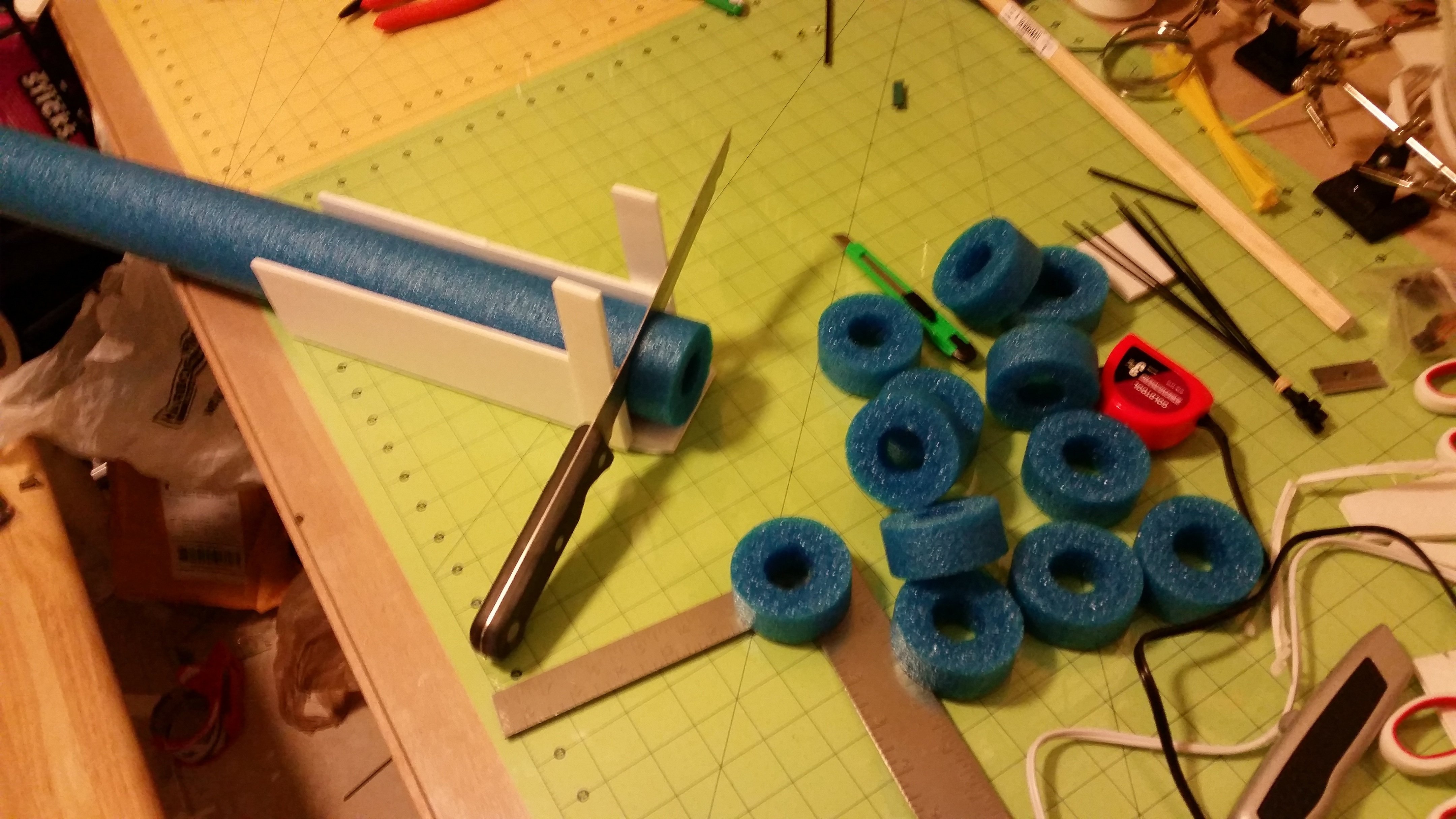

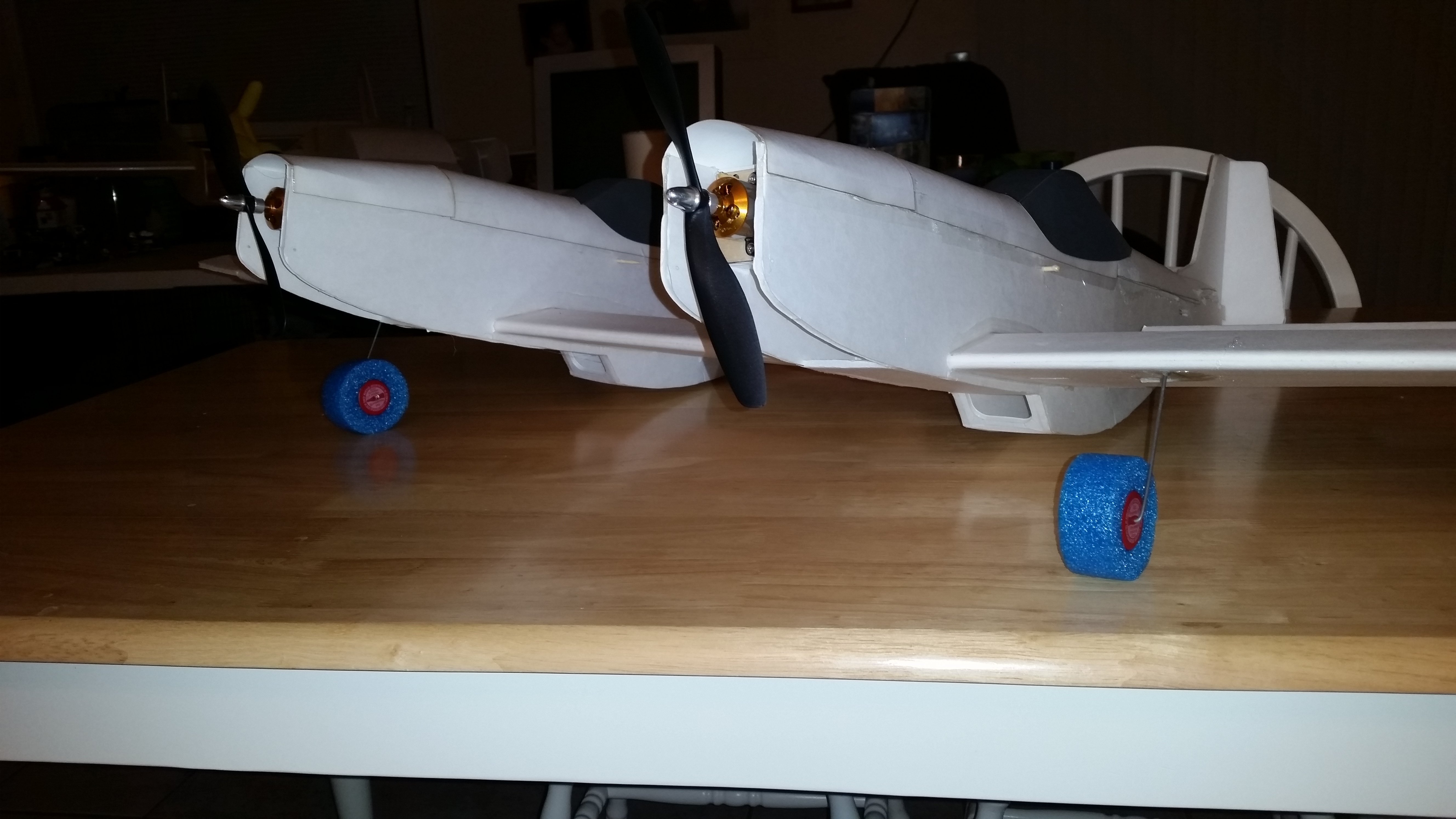

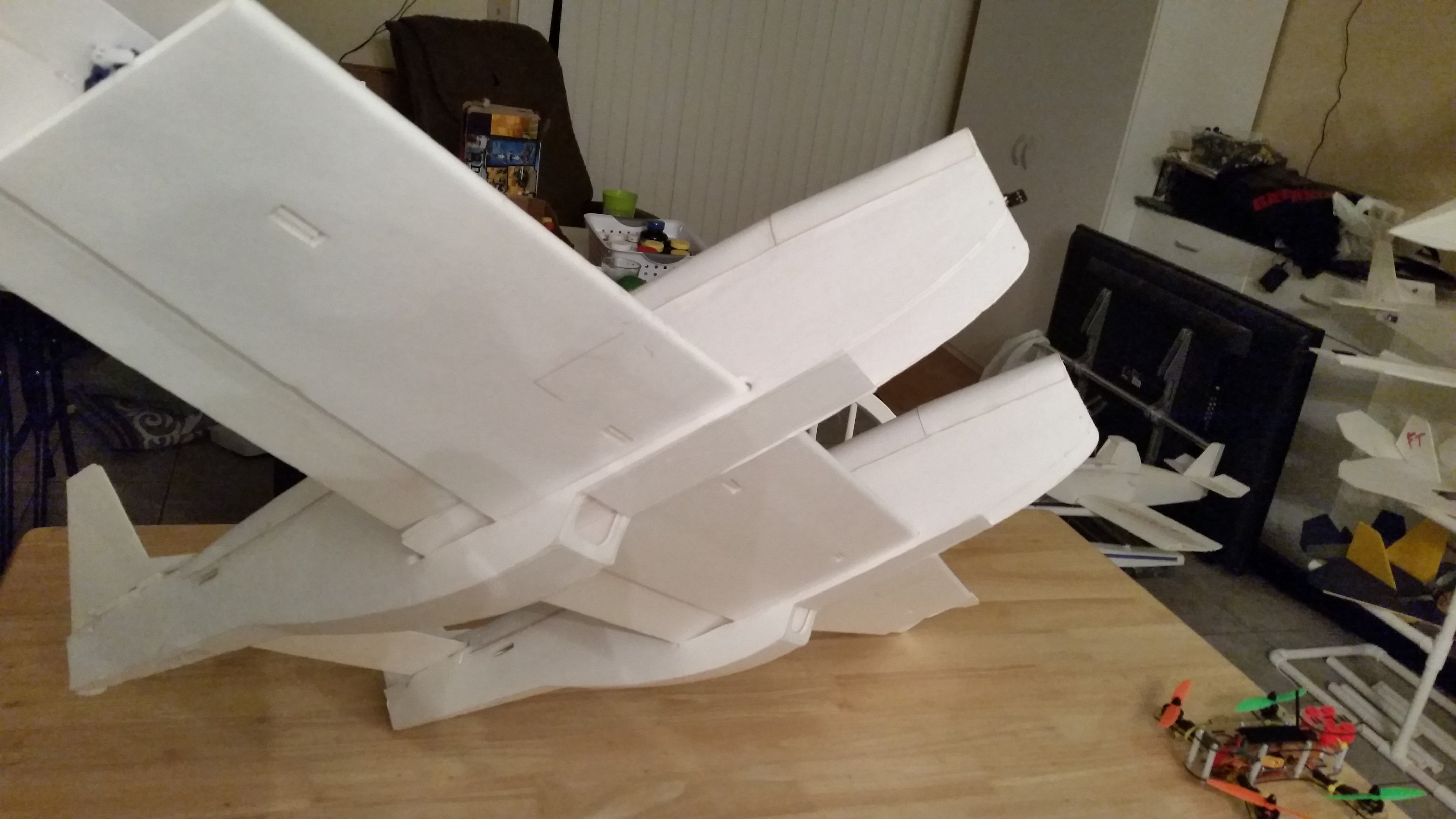

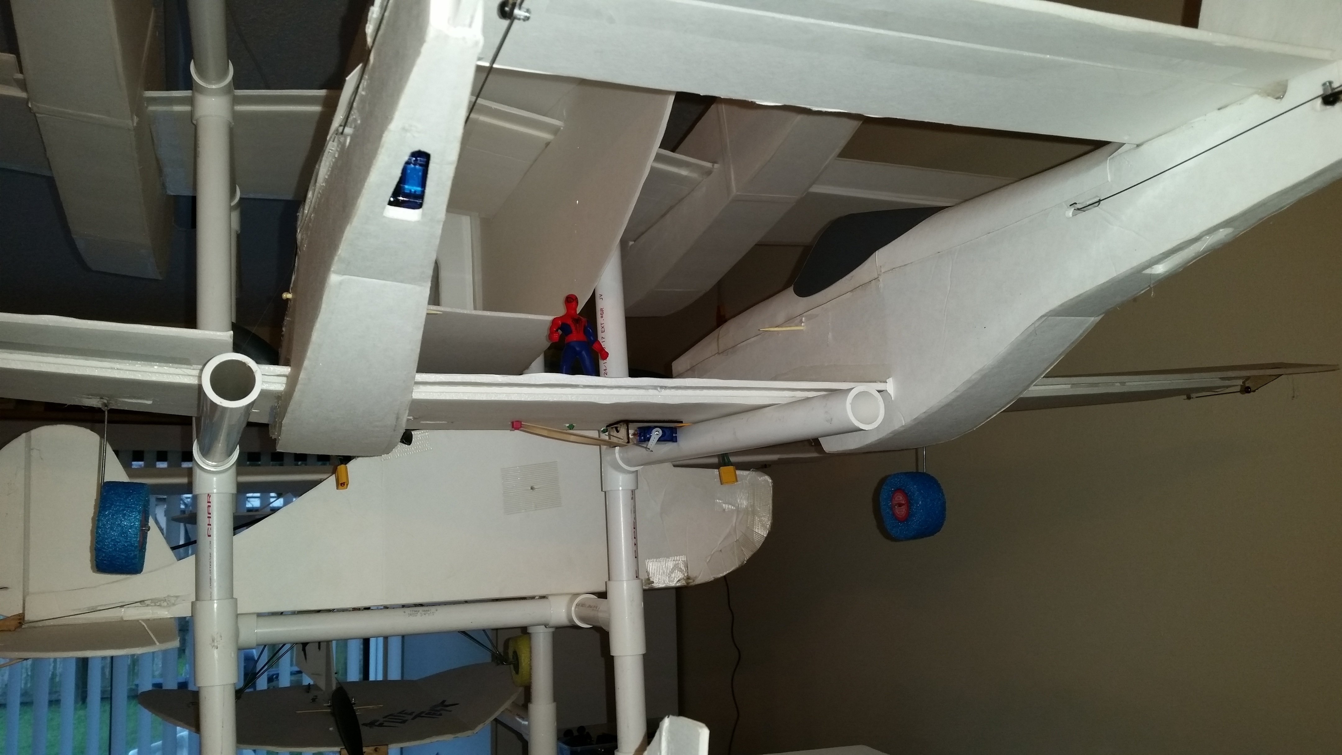

Here are some photos from my build:

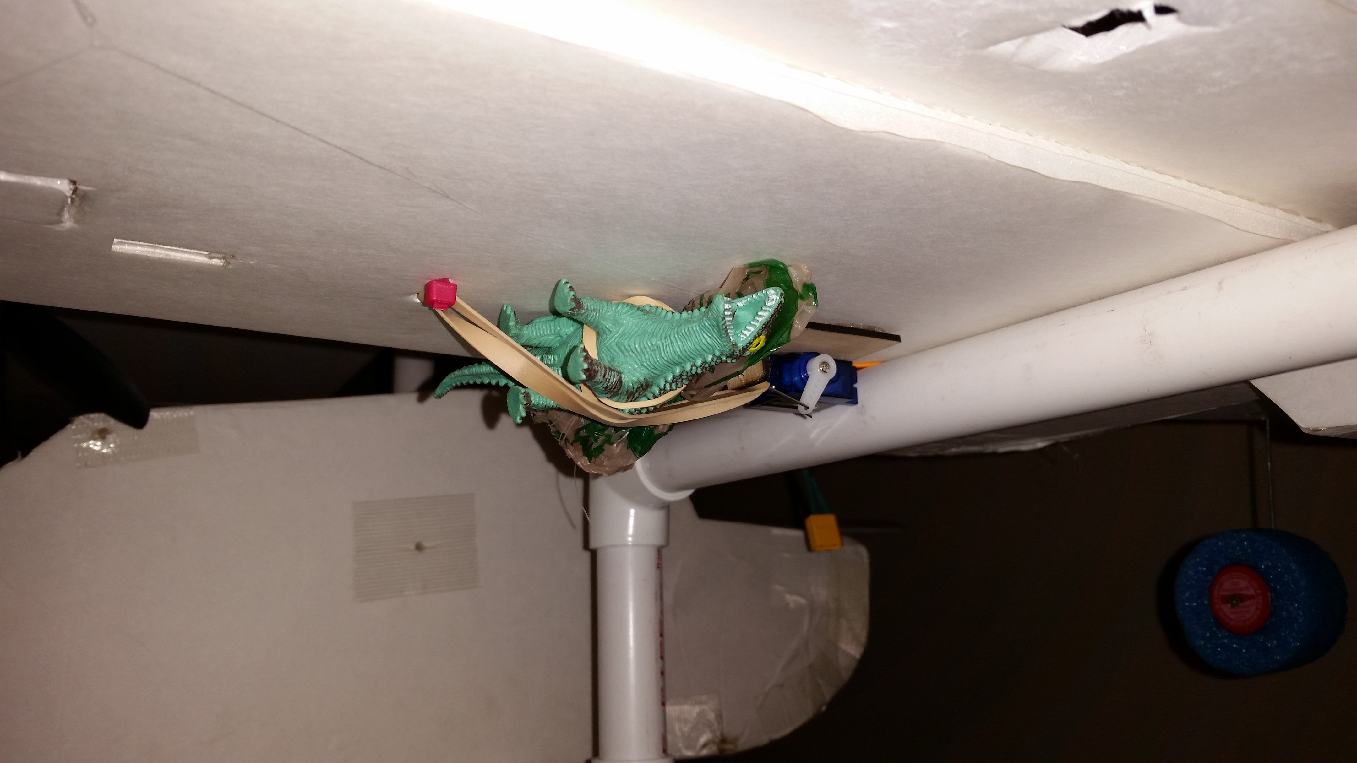

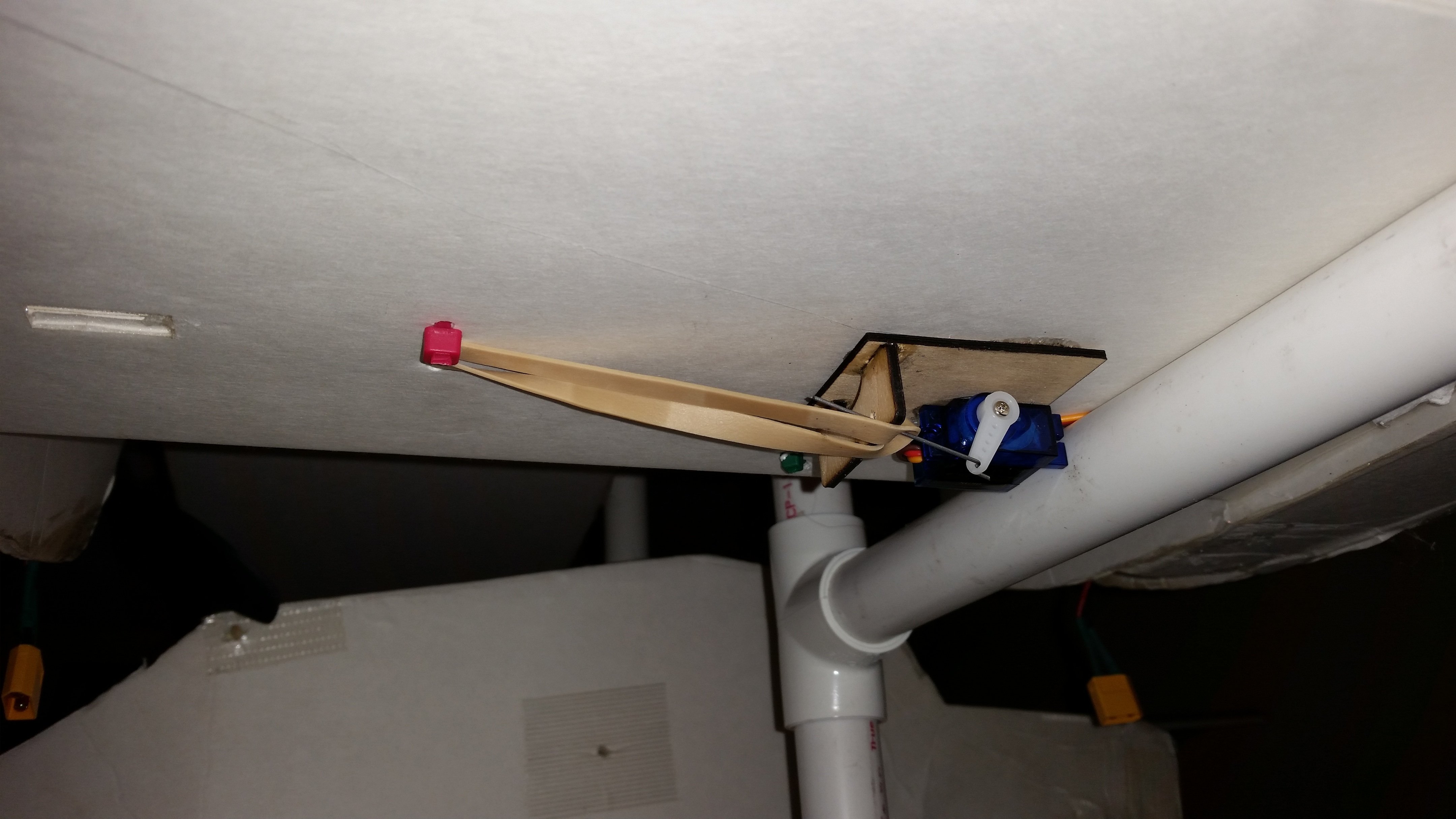

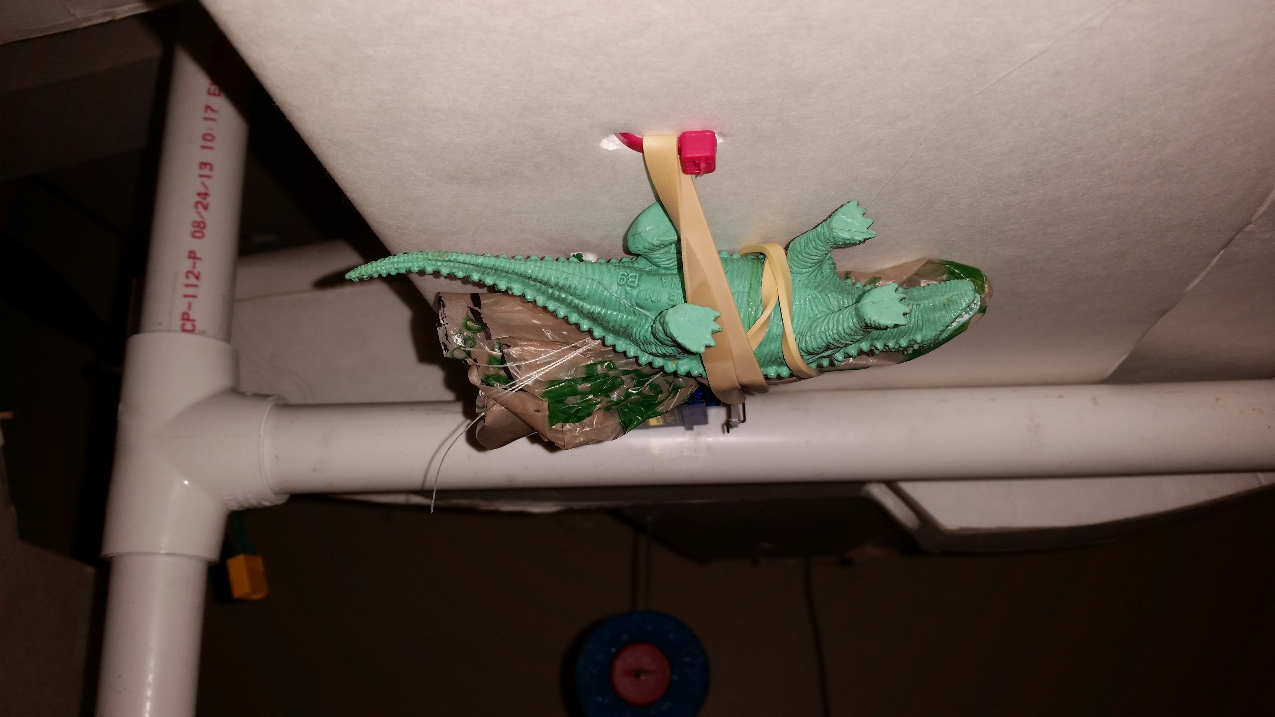

And, thanks to FliteTest, I will have some future fun with this awesome plane, since it proved that it can carry a load with NO problem.
I went digging through all of my daughter's toys and found a few to play with.
DINO DROP.  I will post an article later on how to make a quick parachute from a grocery bag, some tape, rubber band, and some string.
