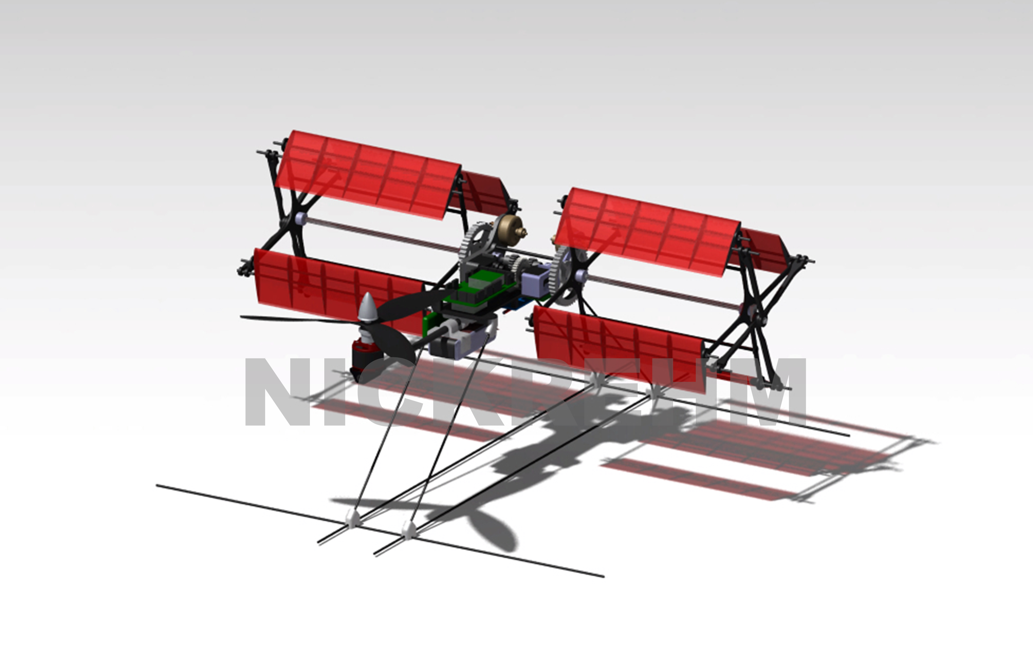

The cyclo in the above video is one that I built, every structural part custom designed, 3D printed, and machined. It runs two 1800kv outrunners geared down to something like 4:1 with a 1300mah 4s, with the separate nose rotor to counteract the torque of the cyclorotors. Flight controllers seemed to be the bottleneck in cyclocopter research prior to recent development (nowadays, you can practically fly anything with a standard flight controller and a little coding know-how).
Here's a CAD render of that vehicle and some pics of the assembly:

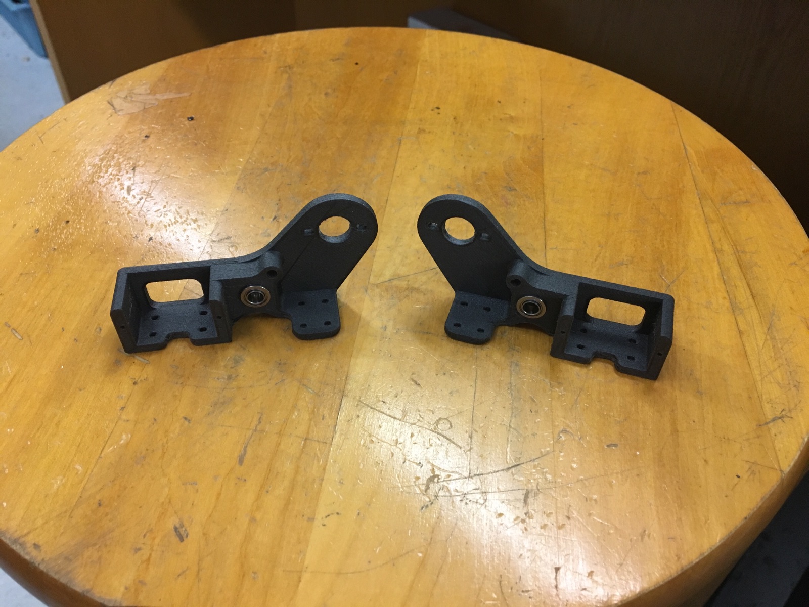

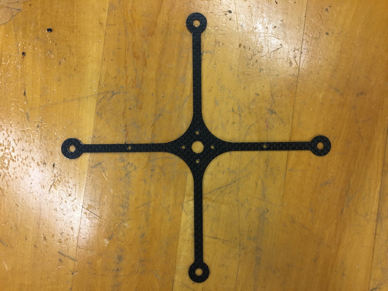

| Motor and phasing servo mounts with bearings for the rotorshaft. | Rotor 'endplate' to support the blades. | Main vehicle mounting frame. | Motor mount assembly. Note that the rotorshaft is actuated by the phasing servo; the actual rotor rotates around this shaft on bearings. | Complete rotor assembly. |
