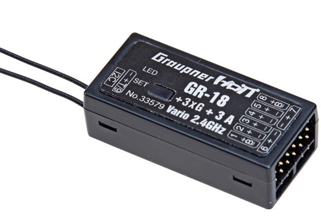

5. Graupner HoTT GR-18 2.4 GHz 3xG+3A+Vario w/Telemetry (9 Ch.)
The new Graupner GR-18 FC/receiver combo is a gem among flight controllers.  It combines a flight controller with a full-range 9-channel receiver that has built-in telemetry and diversity antennas.  Programming couldn't be easier: just read the directions on the transmitter screen and pan/tilt the unit accordingly.  You don't even have to worry about the way you orient this on your copter; as long as you have plugged in all the wires correctly and have it facing right side up, you will have gratifying experience.  This receiver also has an auxiliary port for a GPS module, available here.
The price is also quite reasonable for what you get: the FC/receiver unit is $100 and the GPS module is $70.  If you compare this to something like a DJI Naza or an EagleTree Vector, the price is quite a bit lower, plus it includes an advanced built-in receiver.
Of course, the downside to buying one is that you do have to have a Graupner HoTT radio.  You can actually buy a complete Tx/Rx package with the MZ-12 transmitter and this receiver from Graupner for $200.  If you're getting into the hobby, this just might be the best option for you.  You can hit the ground and run with this package as it is already pre-tuned and includes all the radio components that you need.

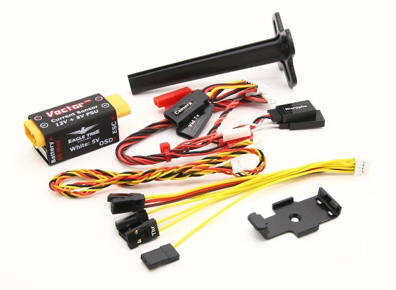

6. EagleTree Vector Flight Controller + OSD
The Vector FC combines all the equipment that you need for autonomous flight into one package.  It includes a flight controller with a GPS system for navigation, an OSD (on-screen display) for live telemetry transmission on your FPV monitor, and several sensors that measure various parameters while you're flying.
To complete an LRS (long-range system) setup with this unit, you'll need a camera with a live video link, a UHF (ultra-high frequency) receiver and, of course, your aircraft!  Note that the Vector can be used on fixed-wing aircraft as well as multirotors.
Programming is easily done through a computer interface.  This is an excellent choice of flight controller as it gives you all of the benefits of an OSD without the hassle of hunting down every component separately.  The quality is very comparable to that of the DJI Naza.
