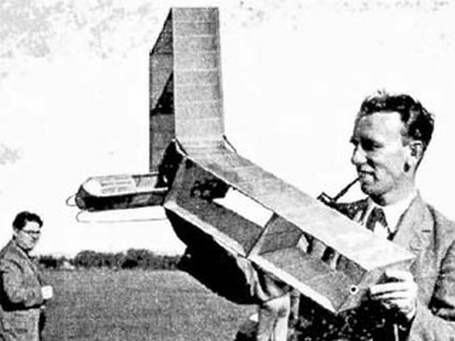

and if you are so inclined to join the spirit, but don't have a pipe, or smoke like me. Click Here for a PDF to print one to mount to DTFB.
