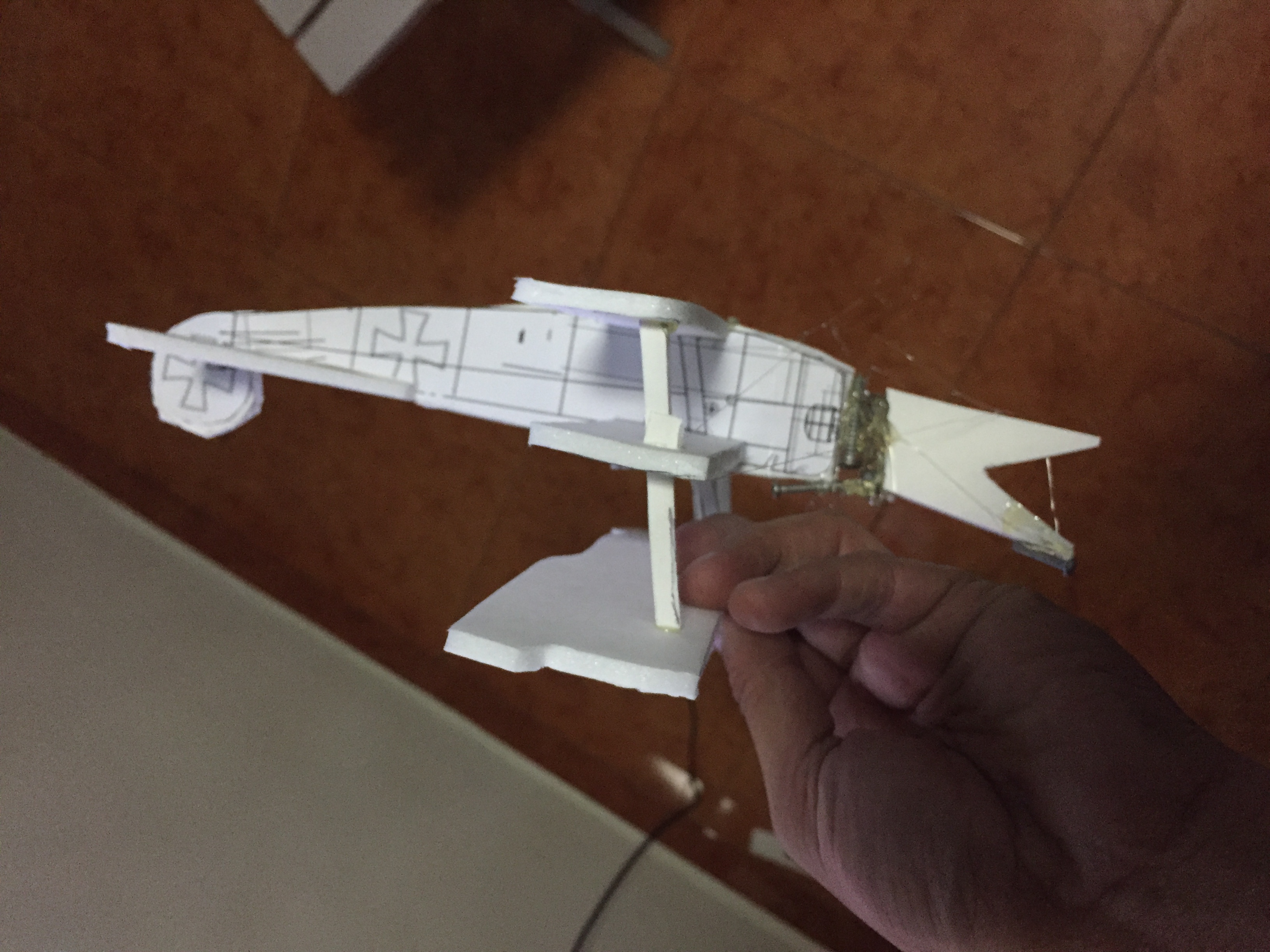

Specs:
wing span 27 inches
Lenght: 24 inches
battery: 3s 2200ma
controls: ailerons-flaps/elevator/rudder
aileron-rudder mixing
motor: ntm 1200 kv/30 amp esc
servos: turnigy 9gr
wings: foamboard score and fold

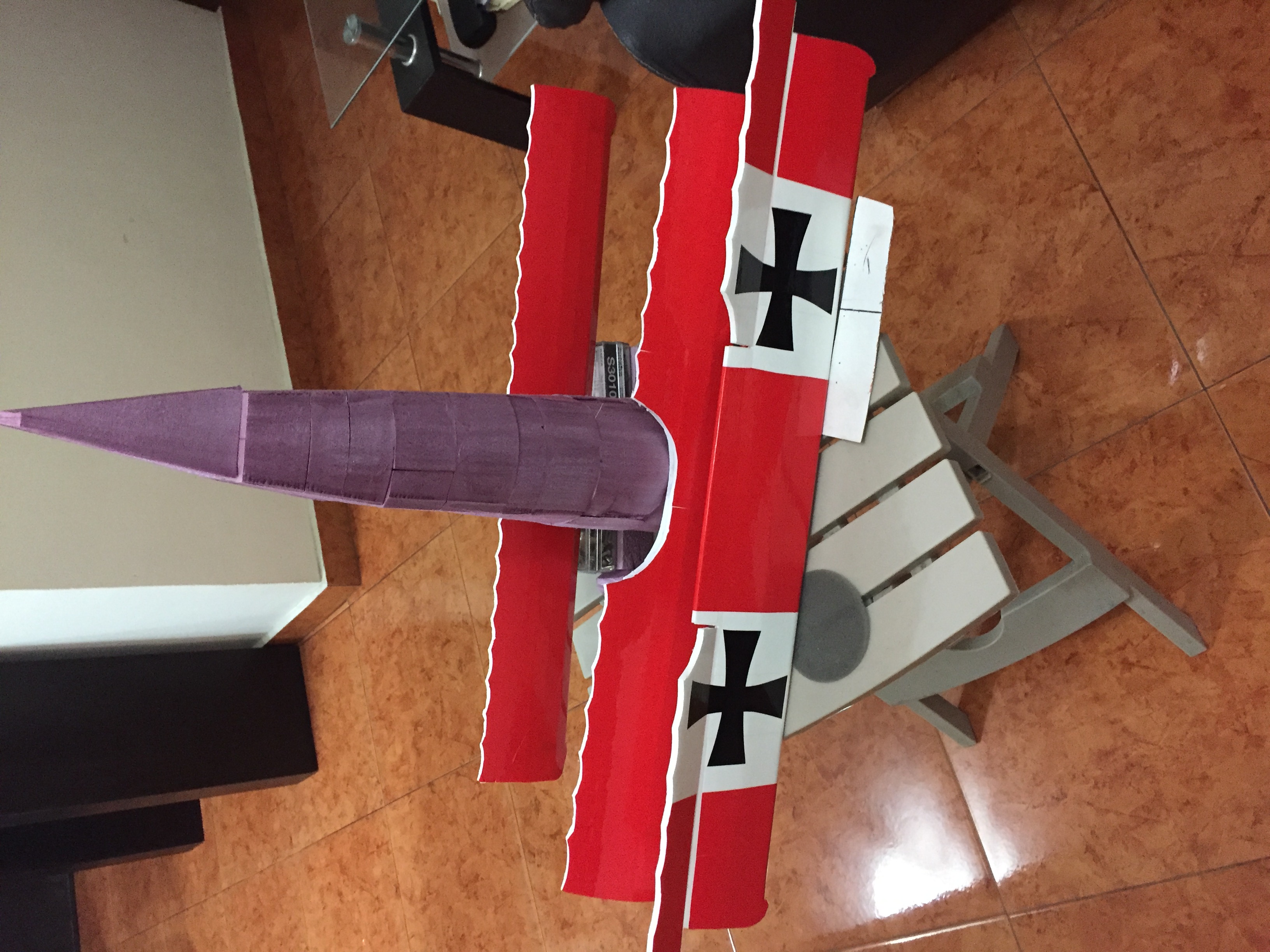

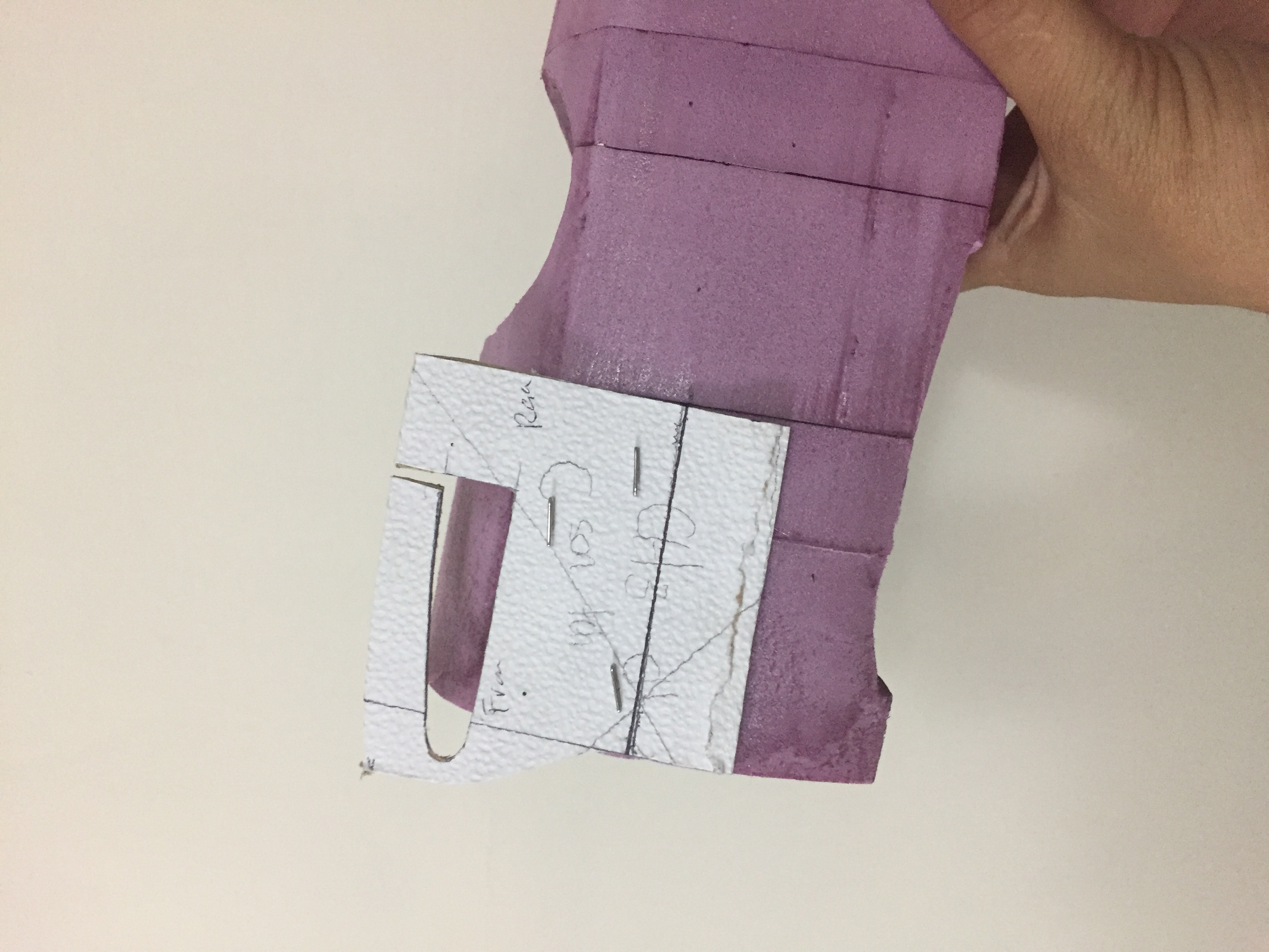

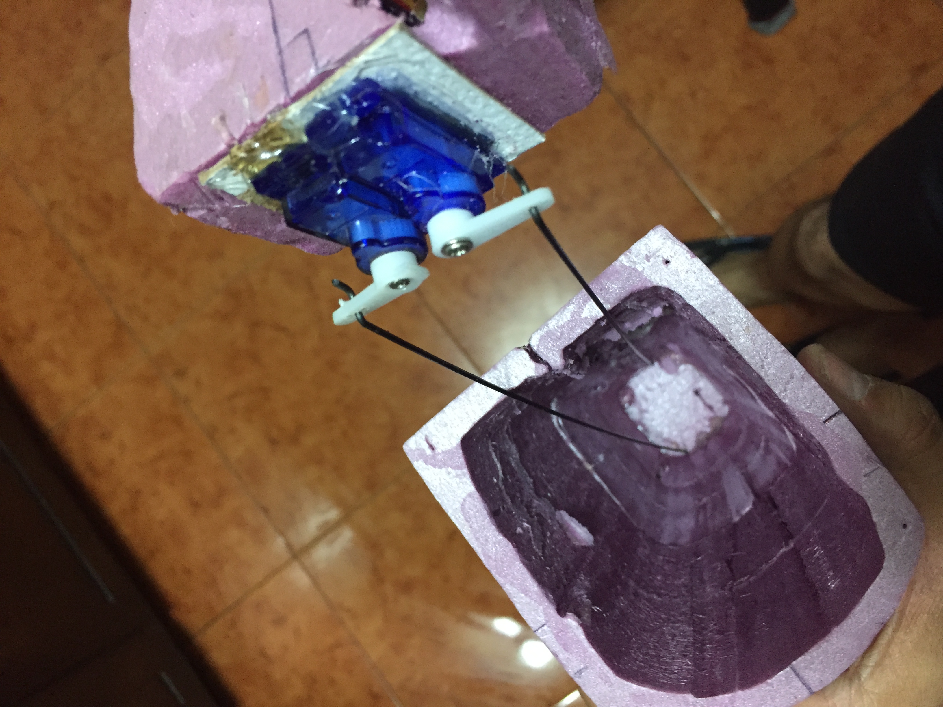

fuse: 2" pink foam

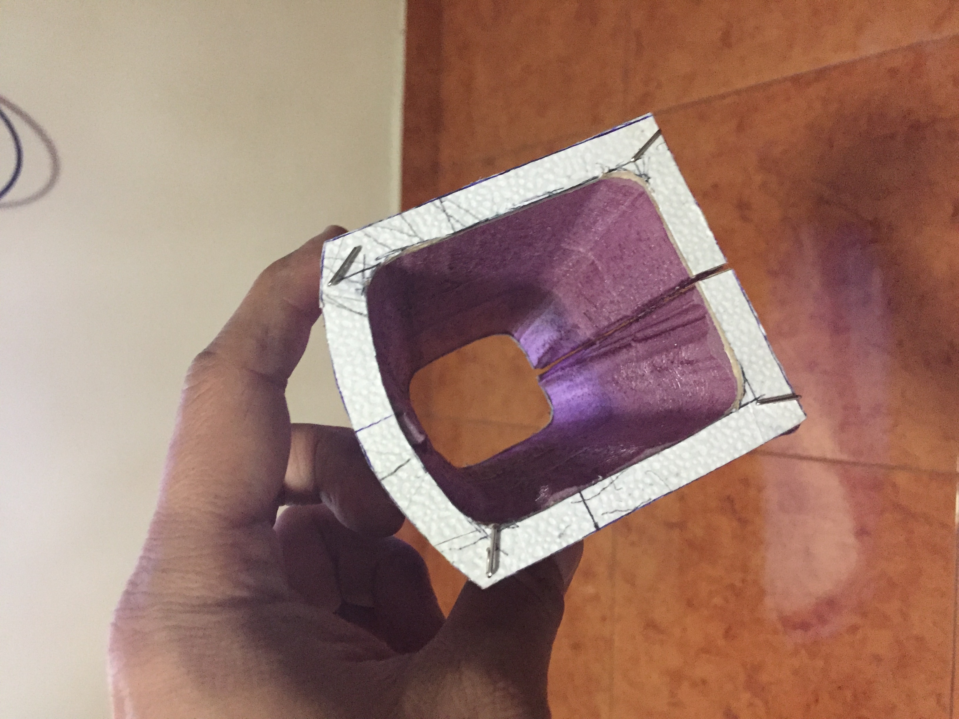

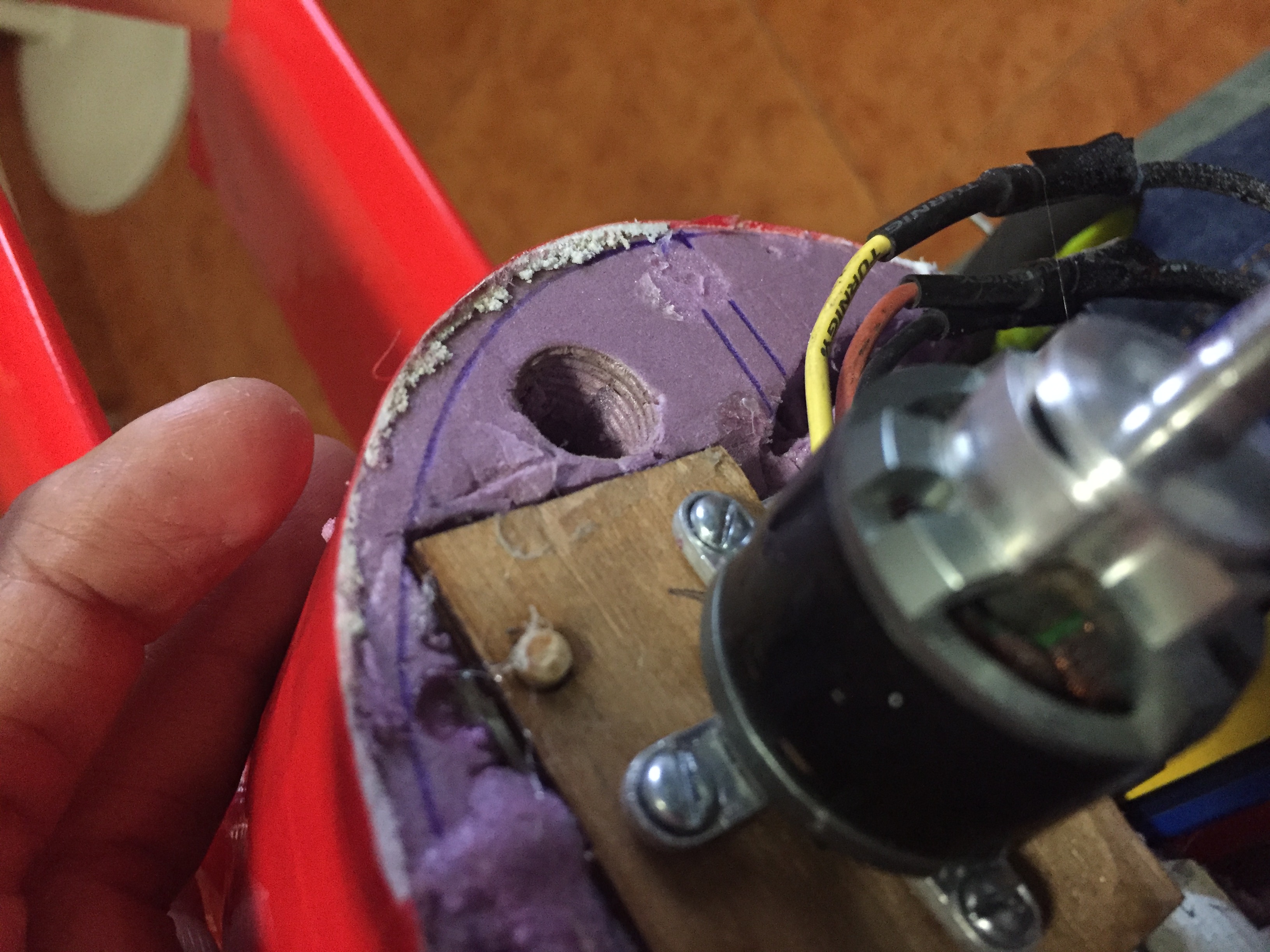

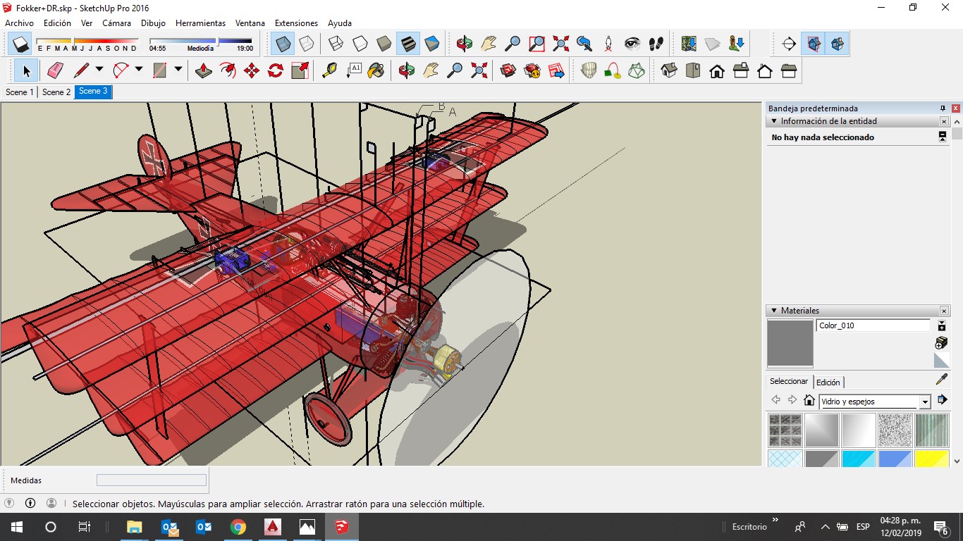

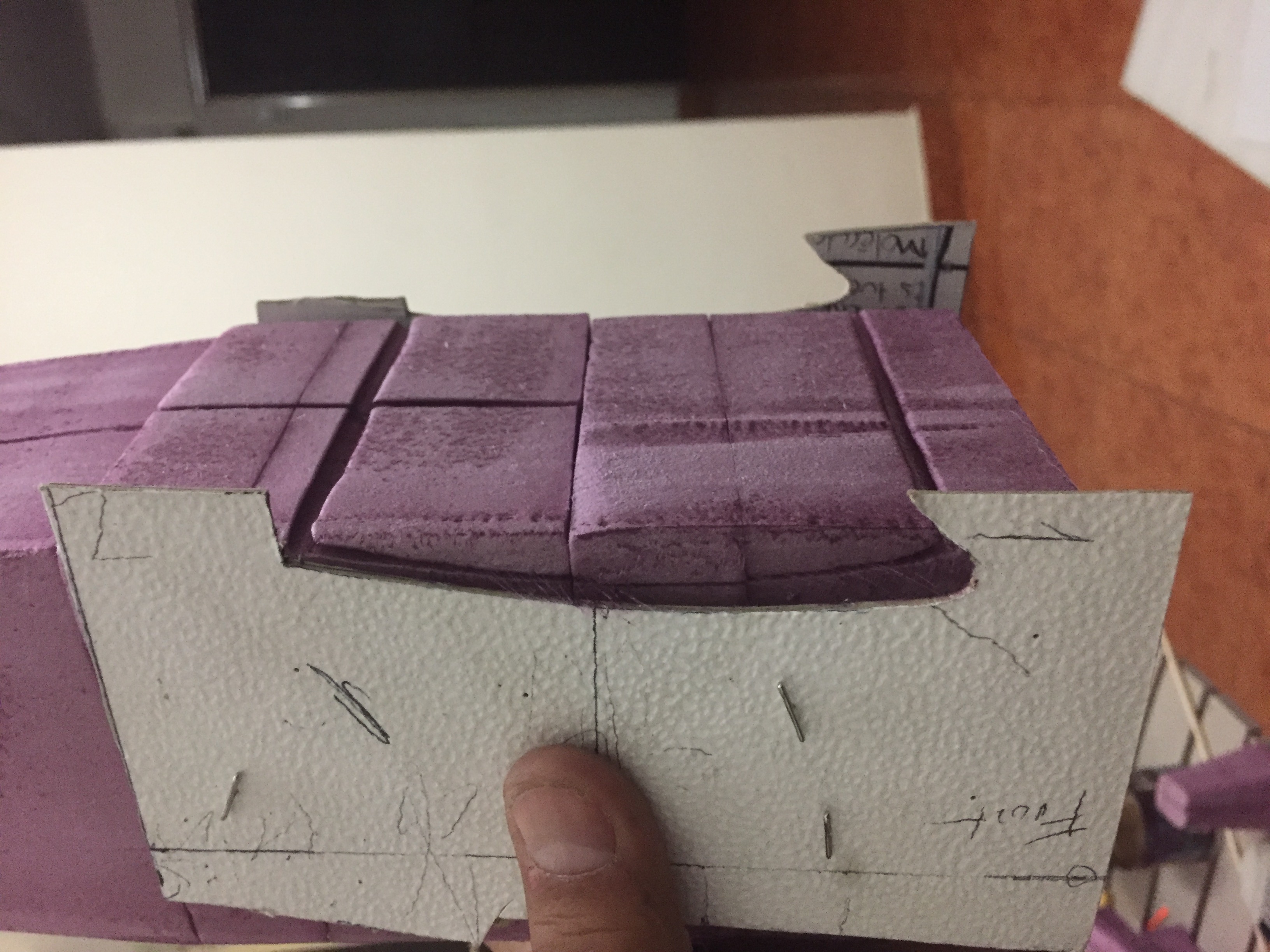

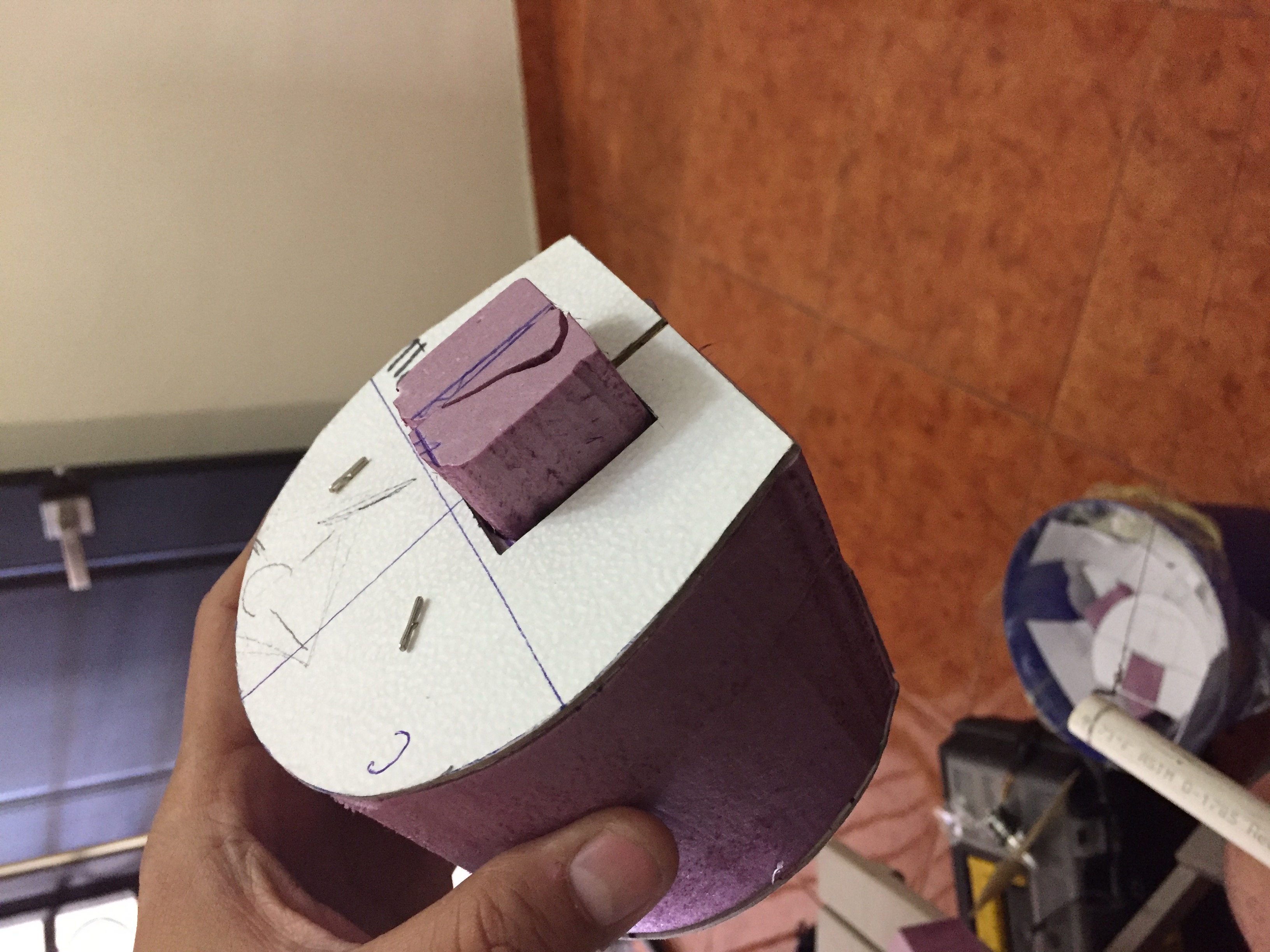

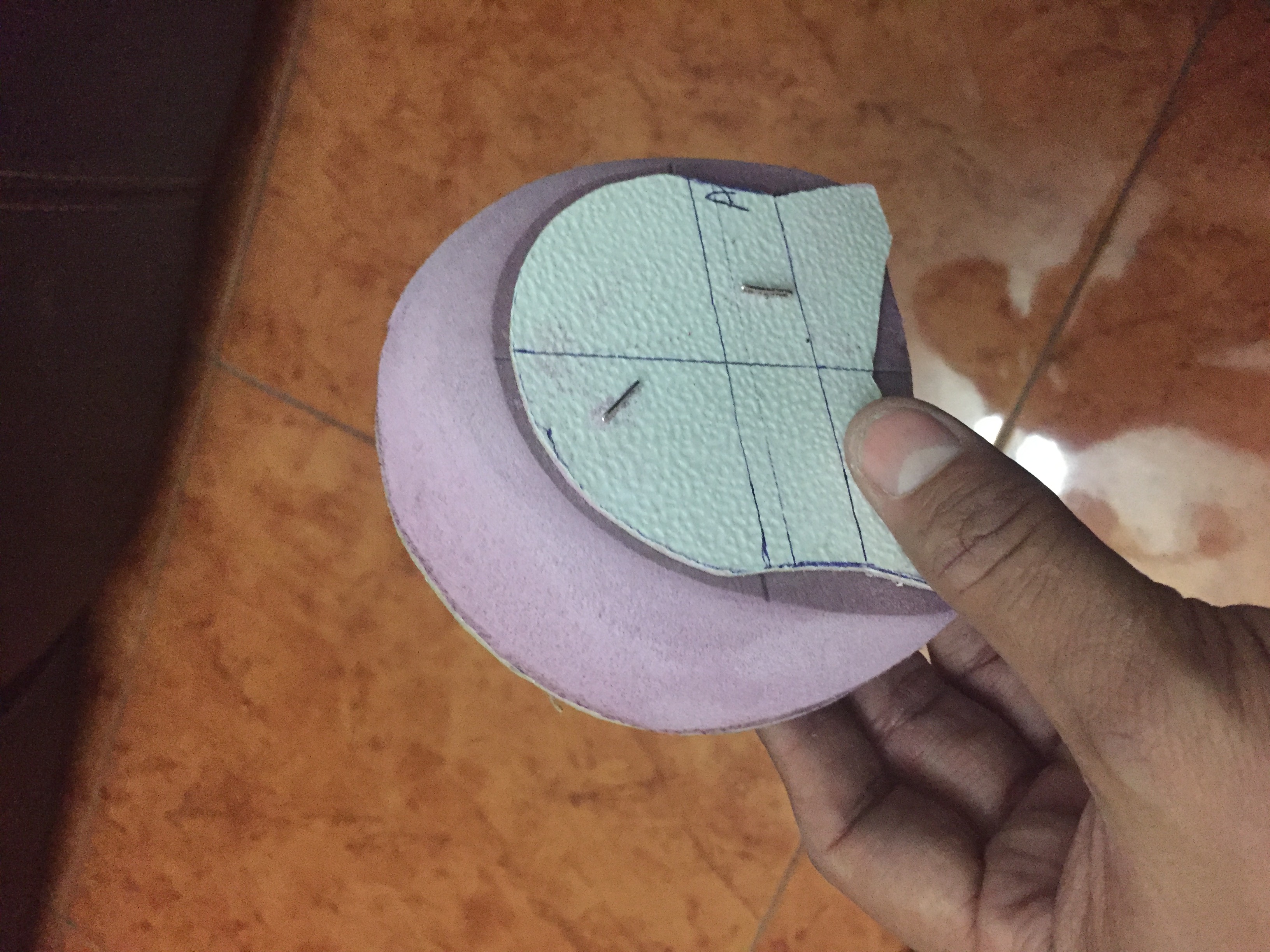

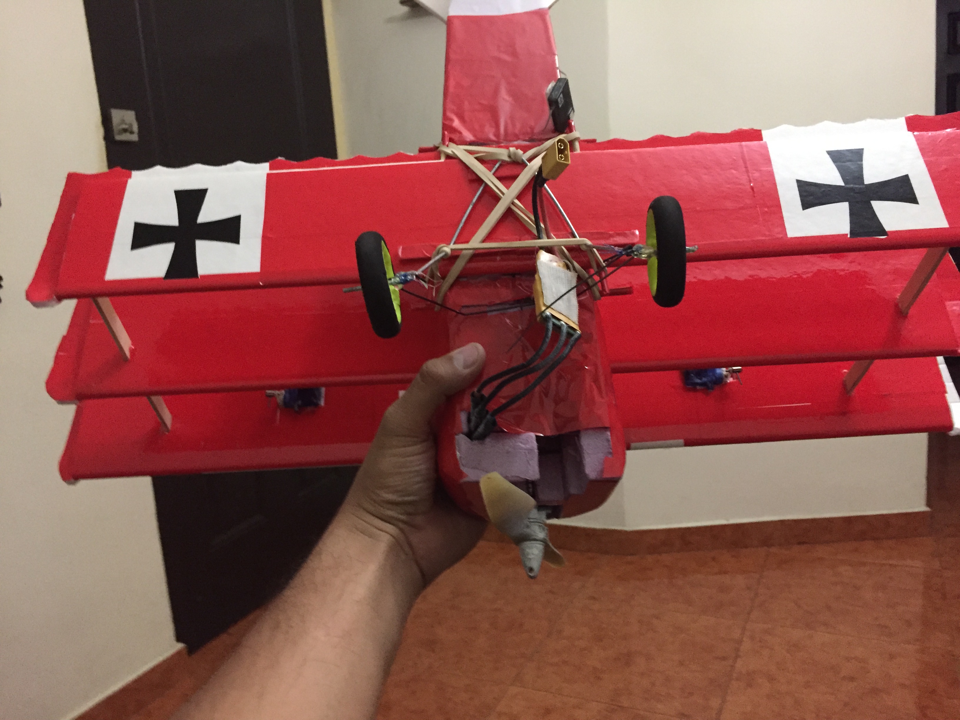

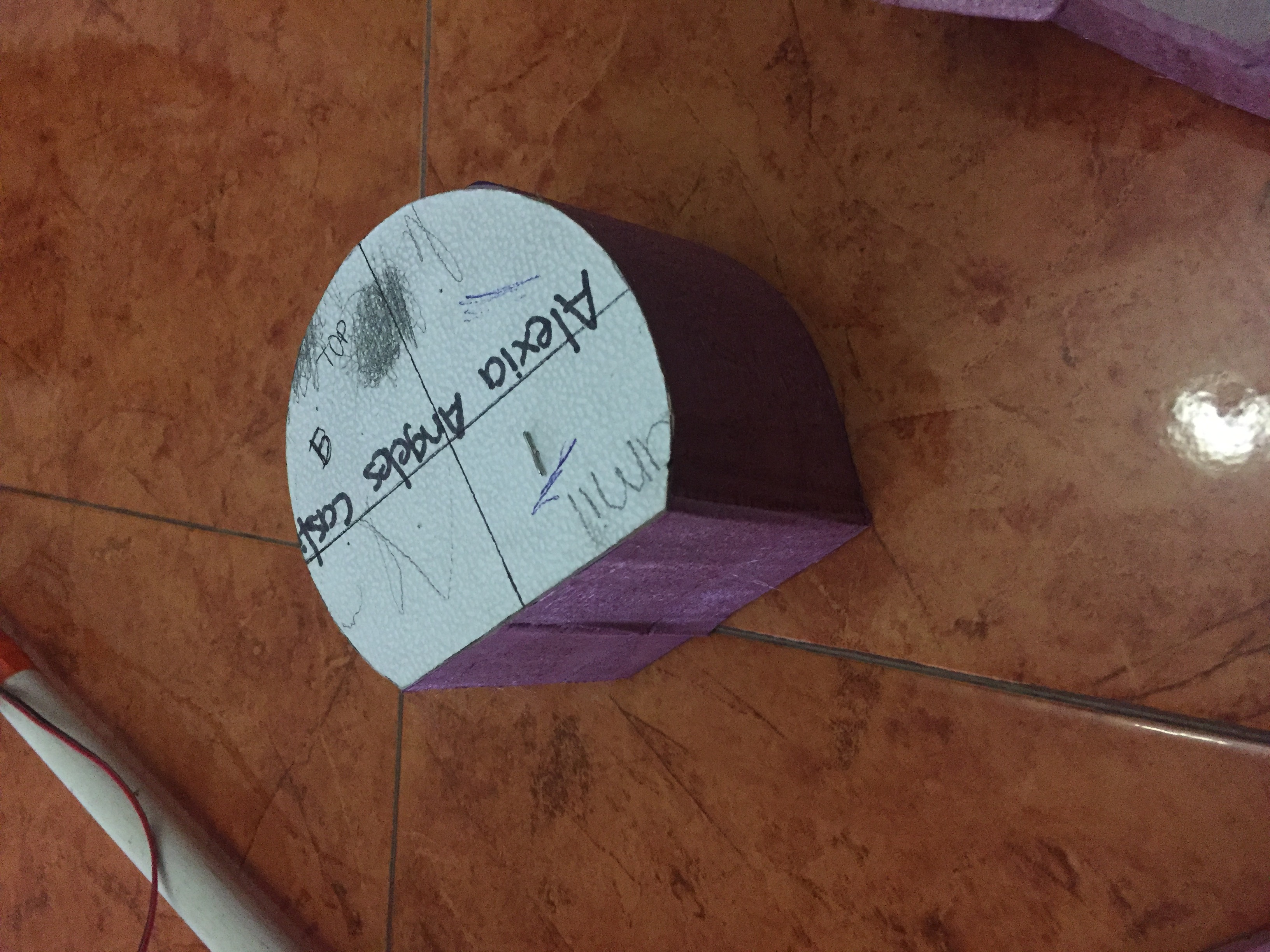

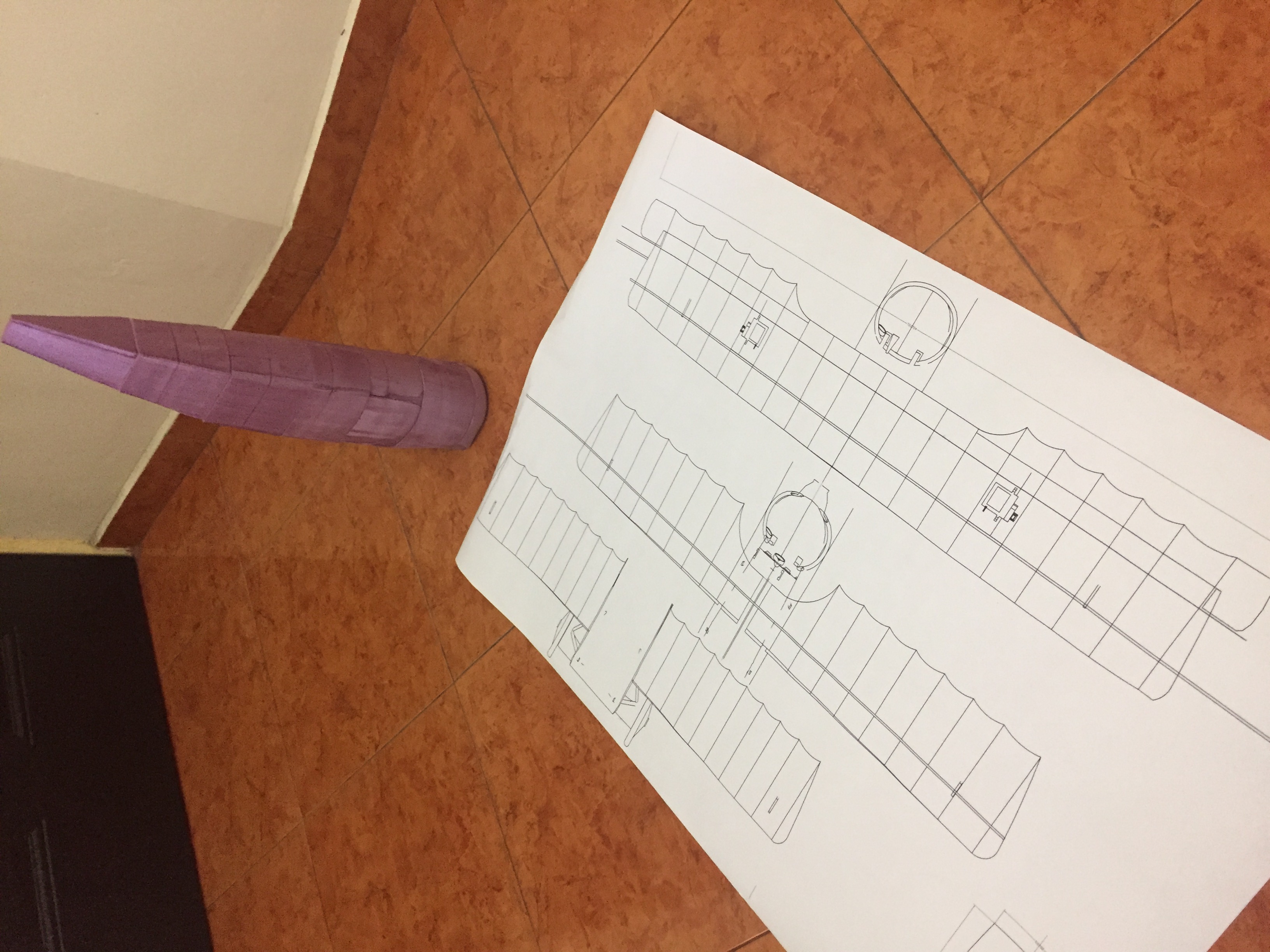

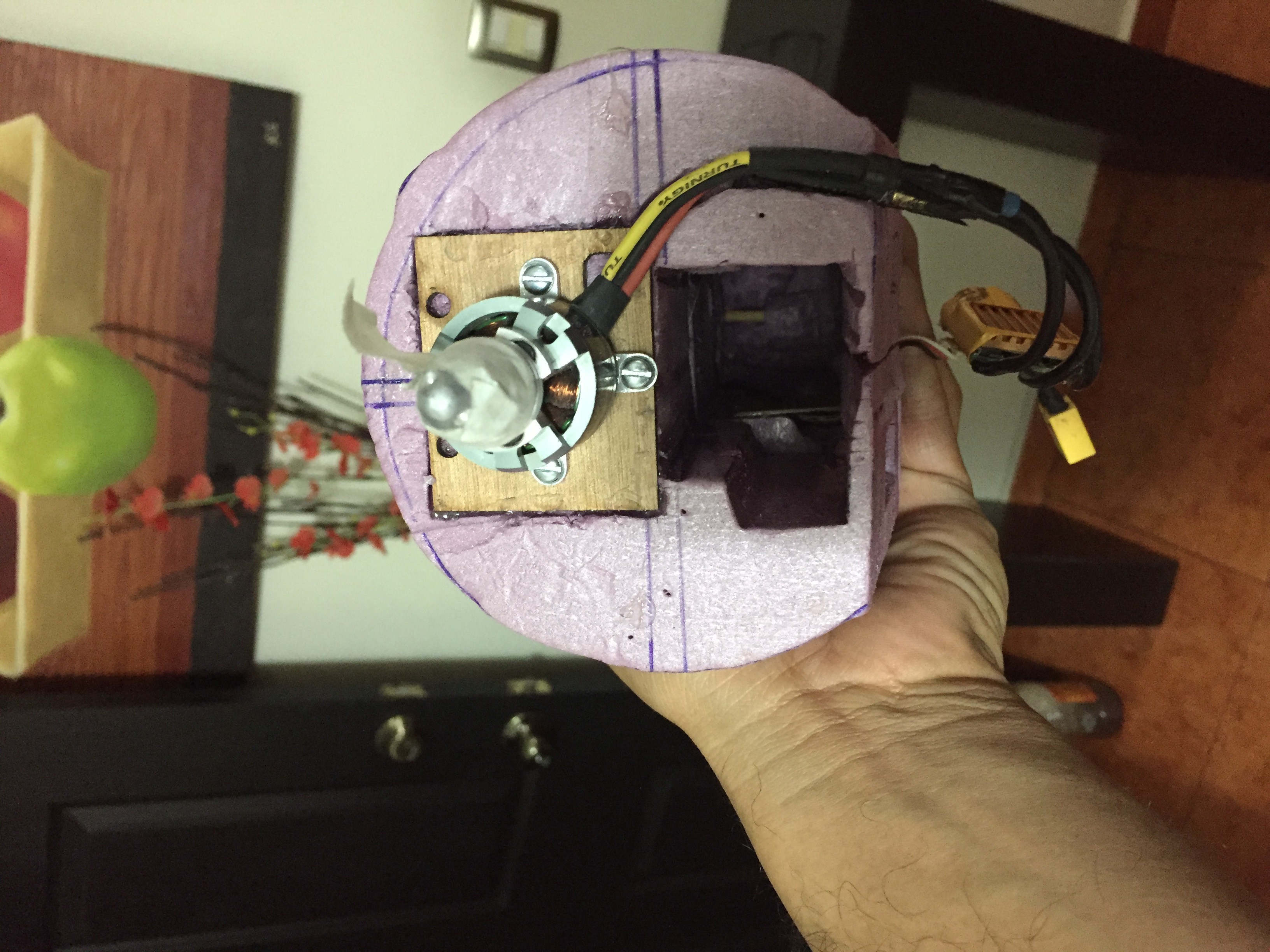

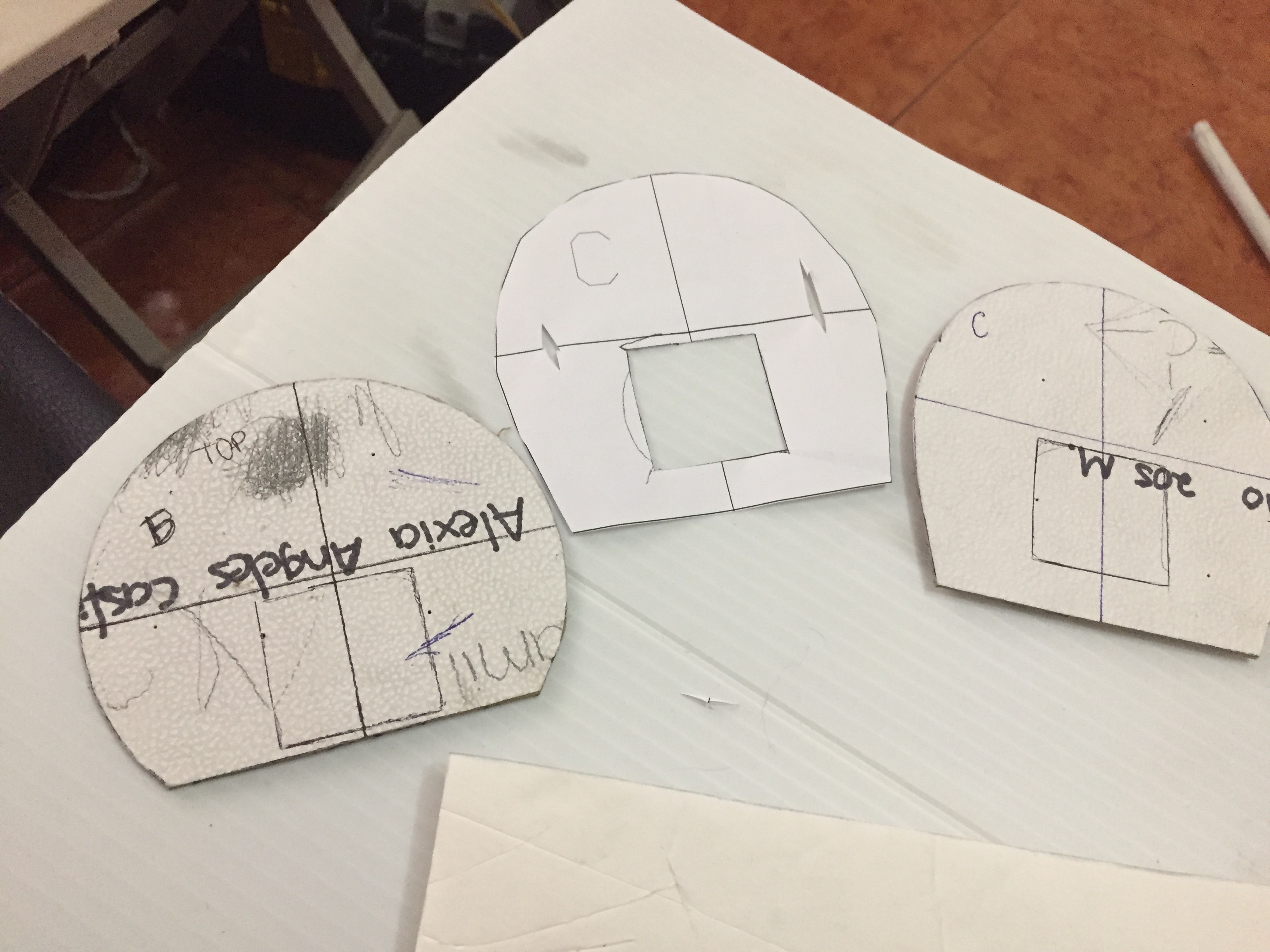

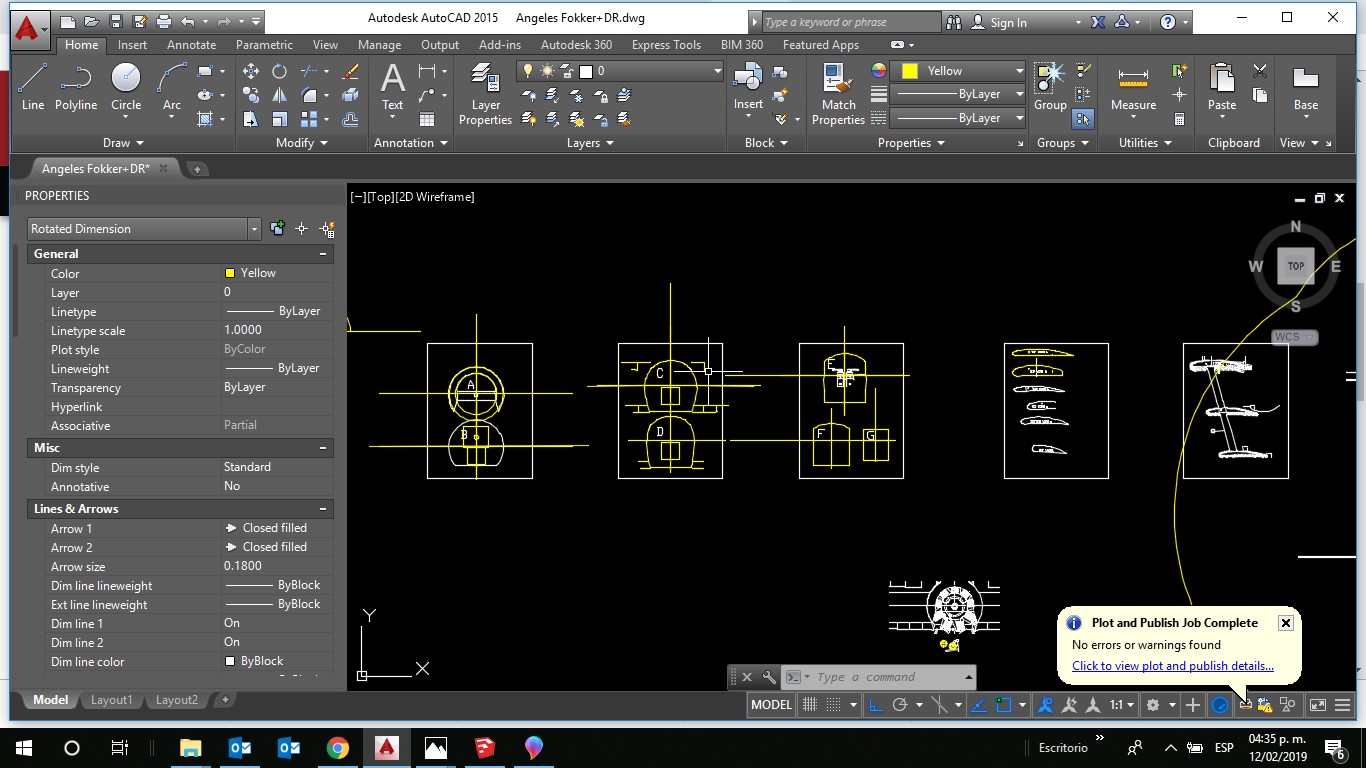

New project Fokker dri, i have a old ntm 1200 kv motor, have colored sealing tape, so i download a sketchup fokker and escaled to a 9 inch prop, place electronics and export templates to cad
printing, cutting, sanding, glueing...

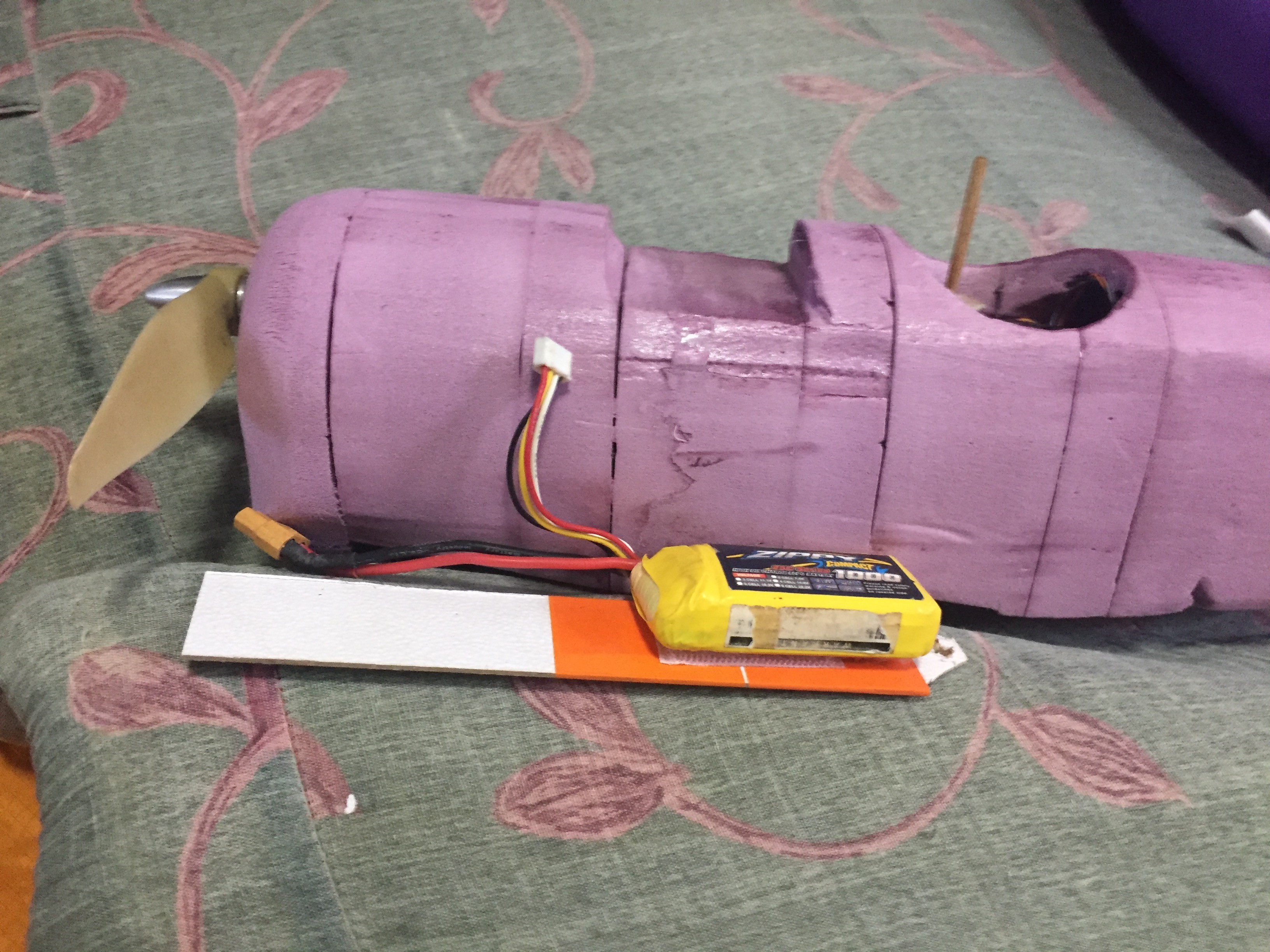

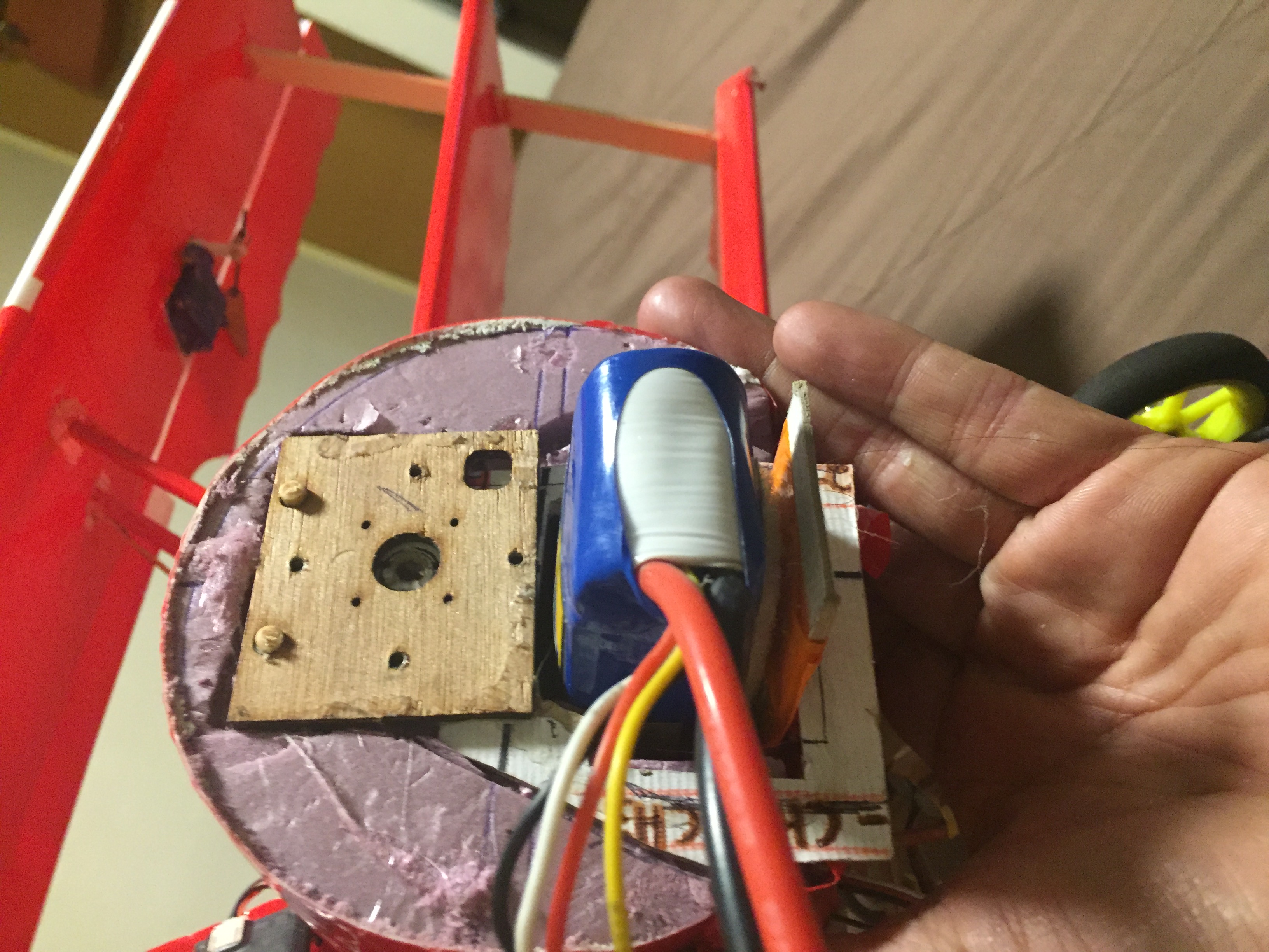

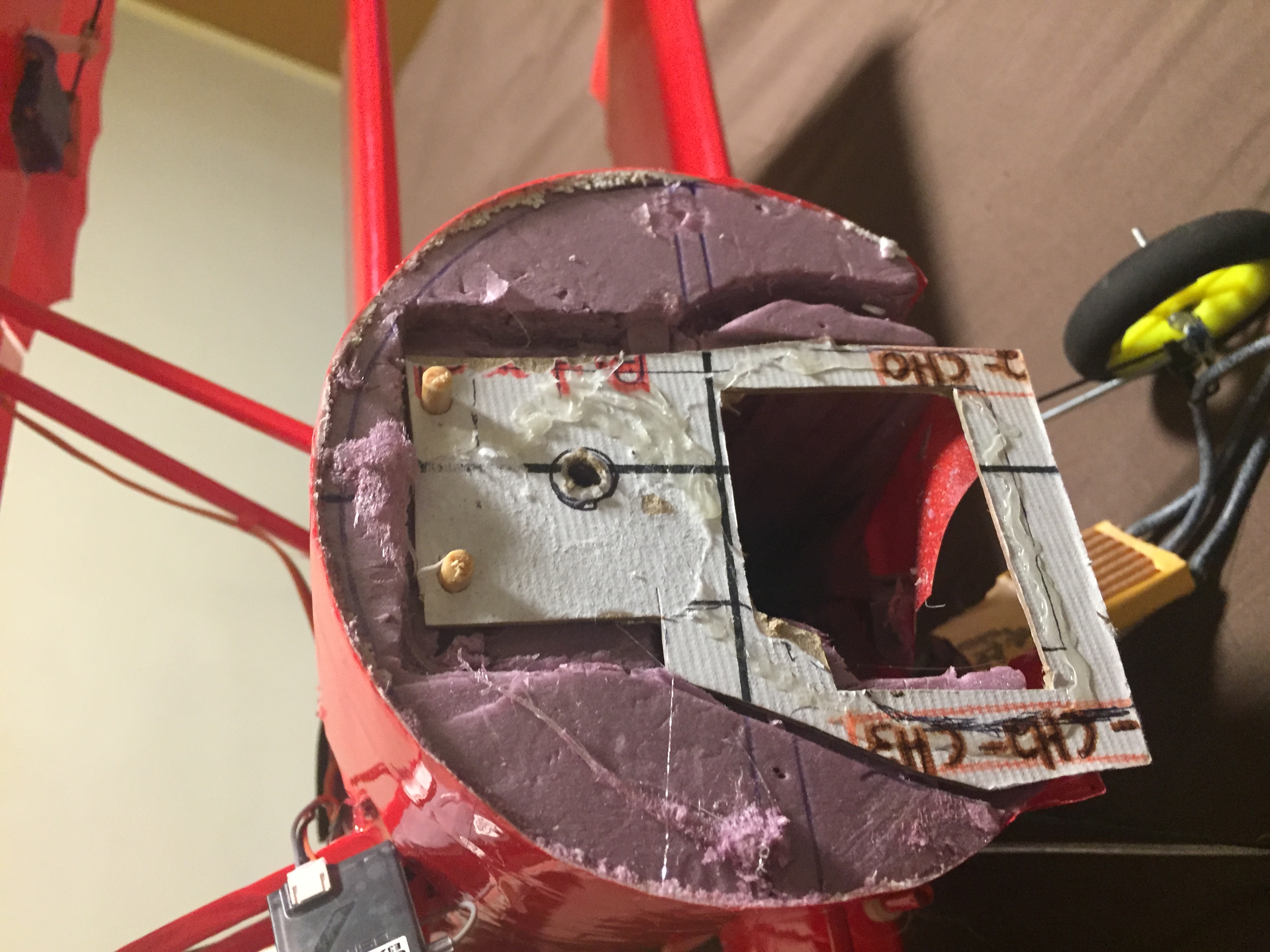

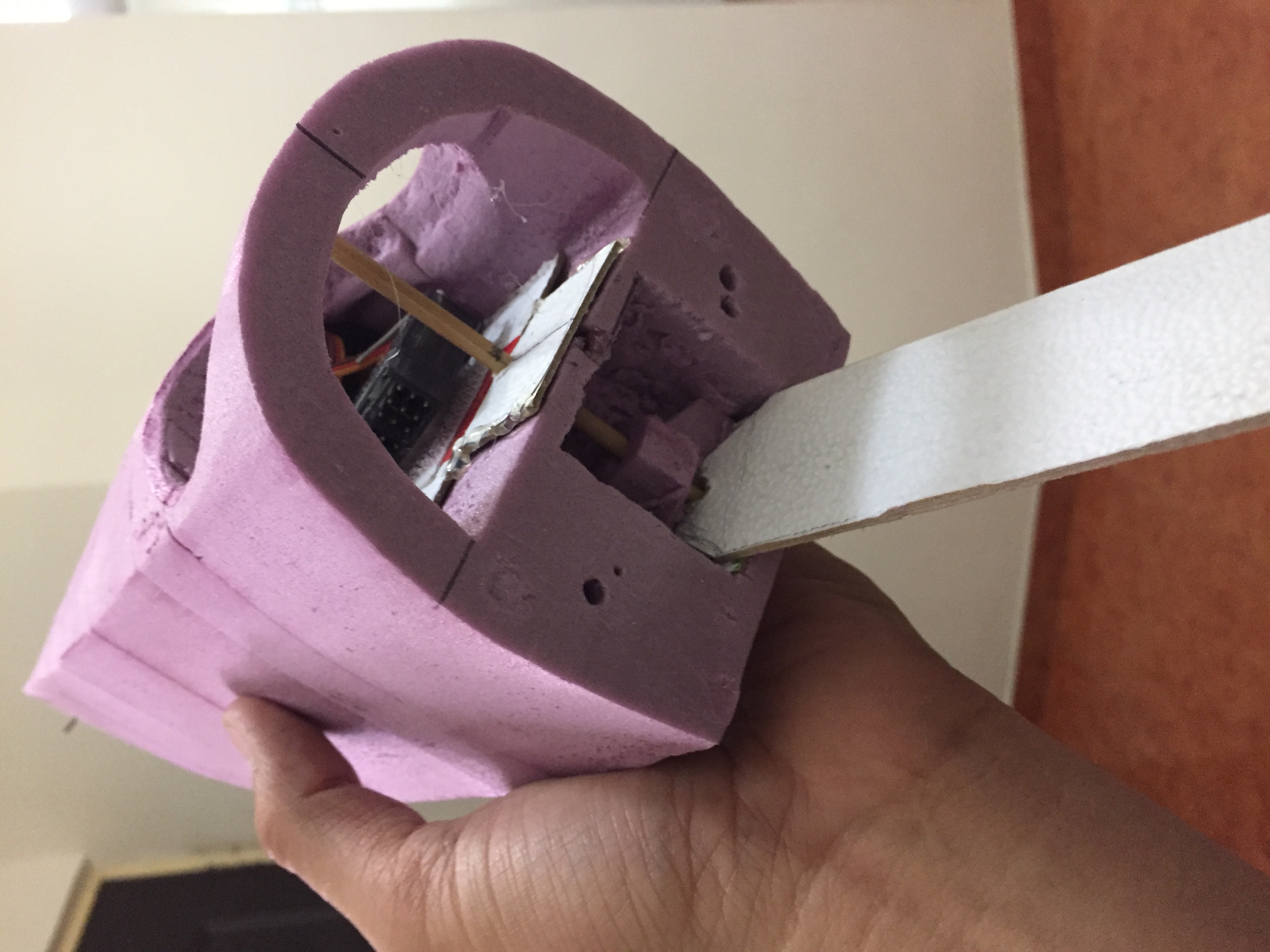

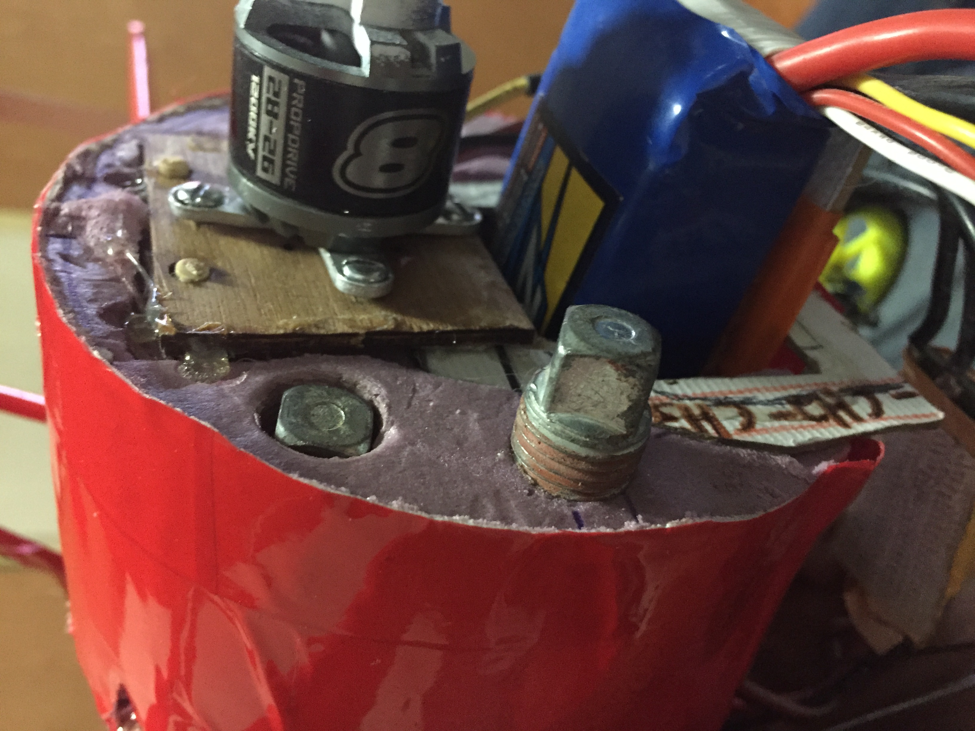

battery compartment
battery locking mechanism

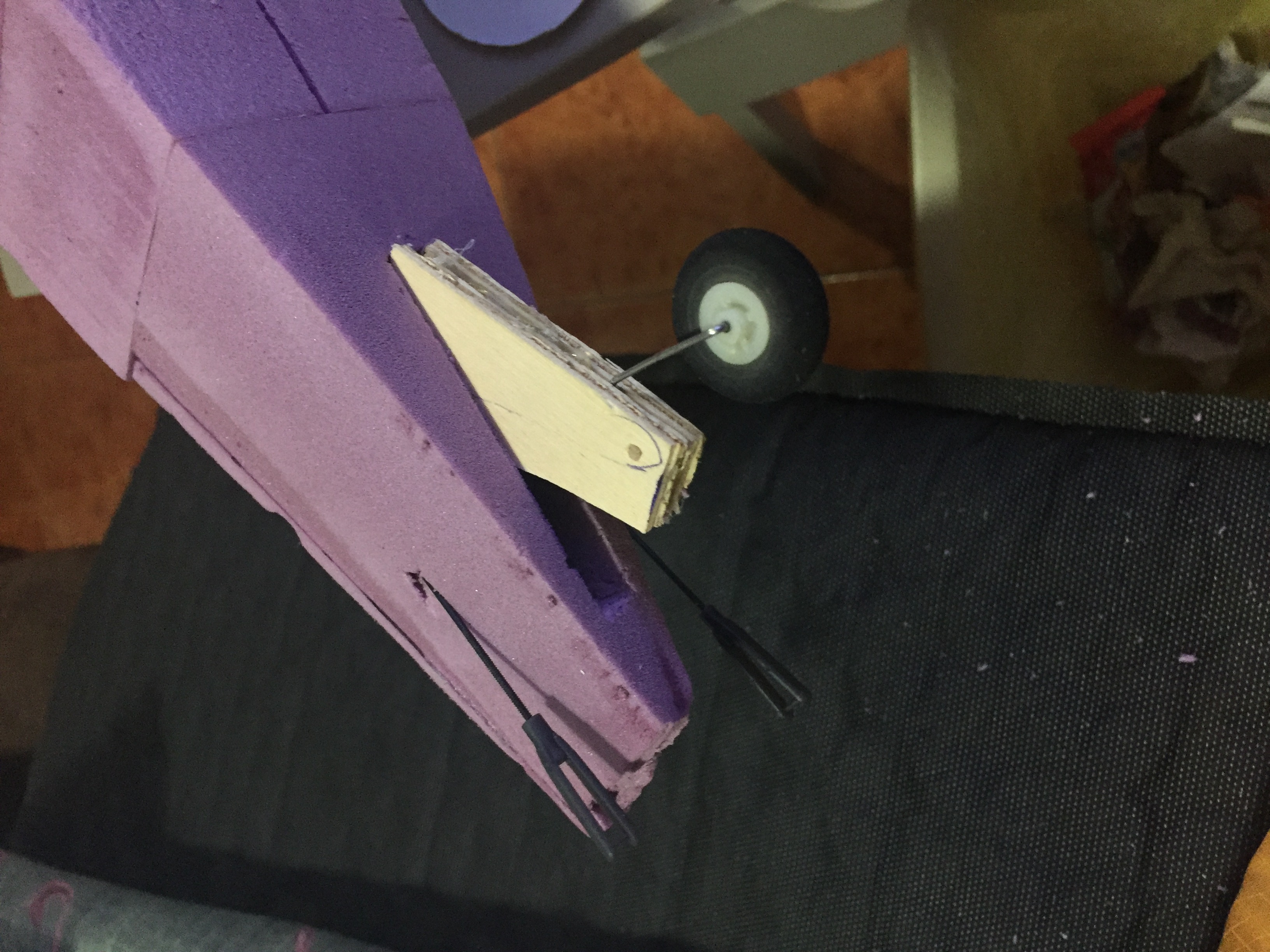

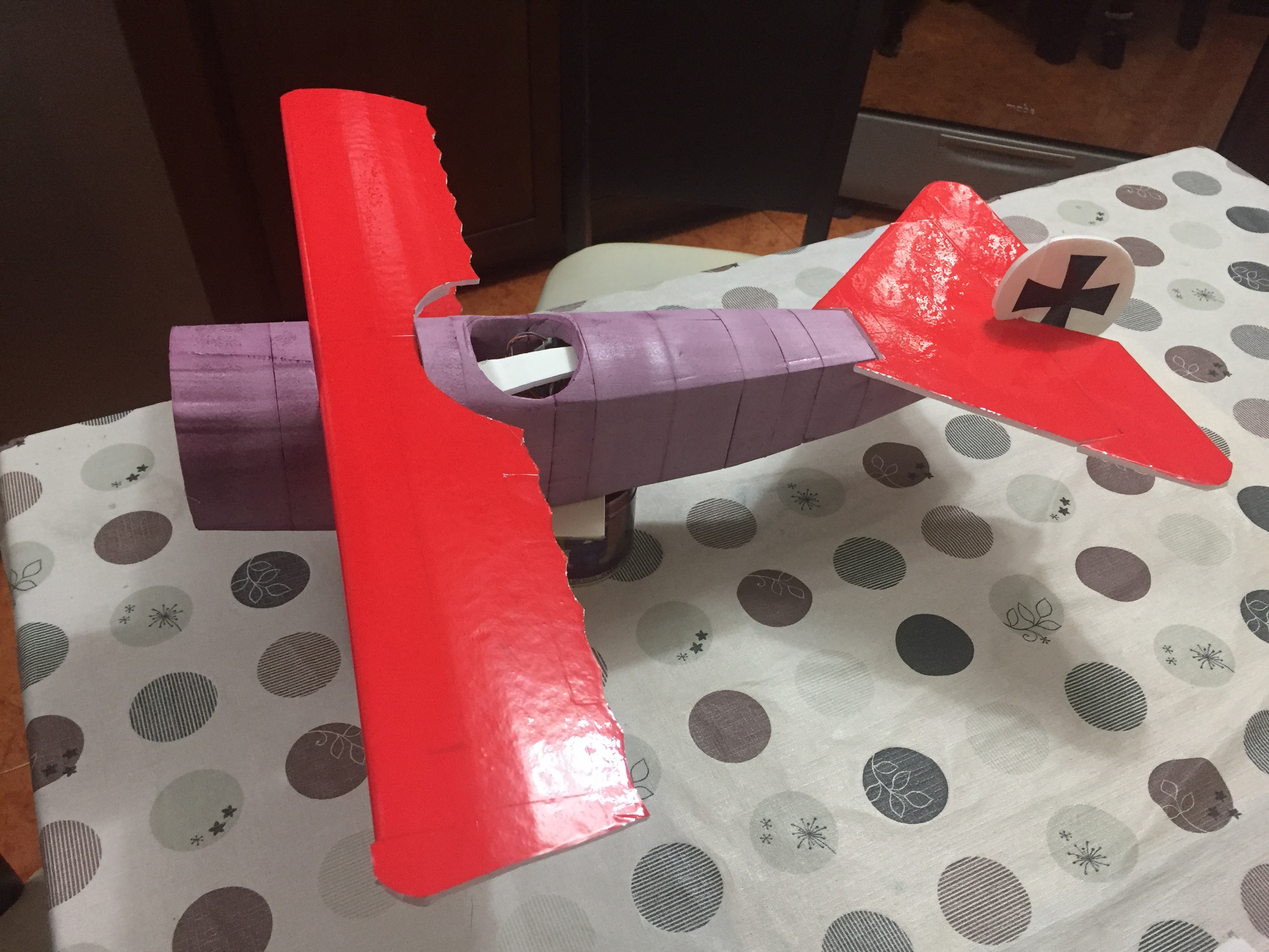

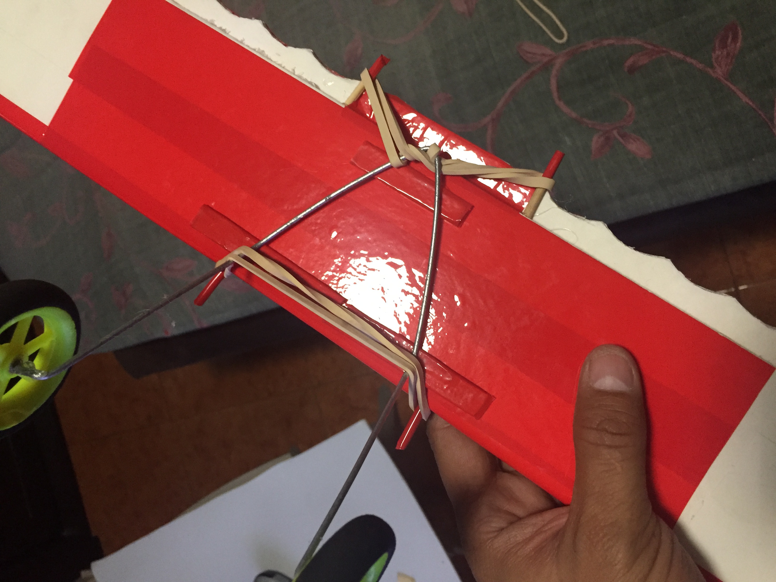

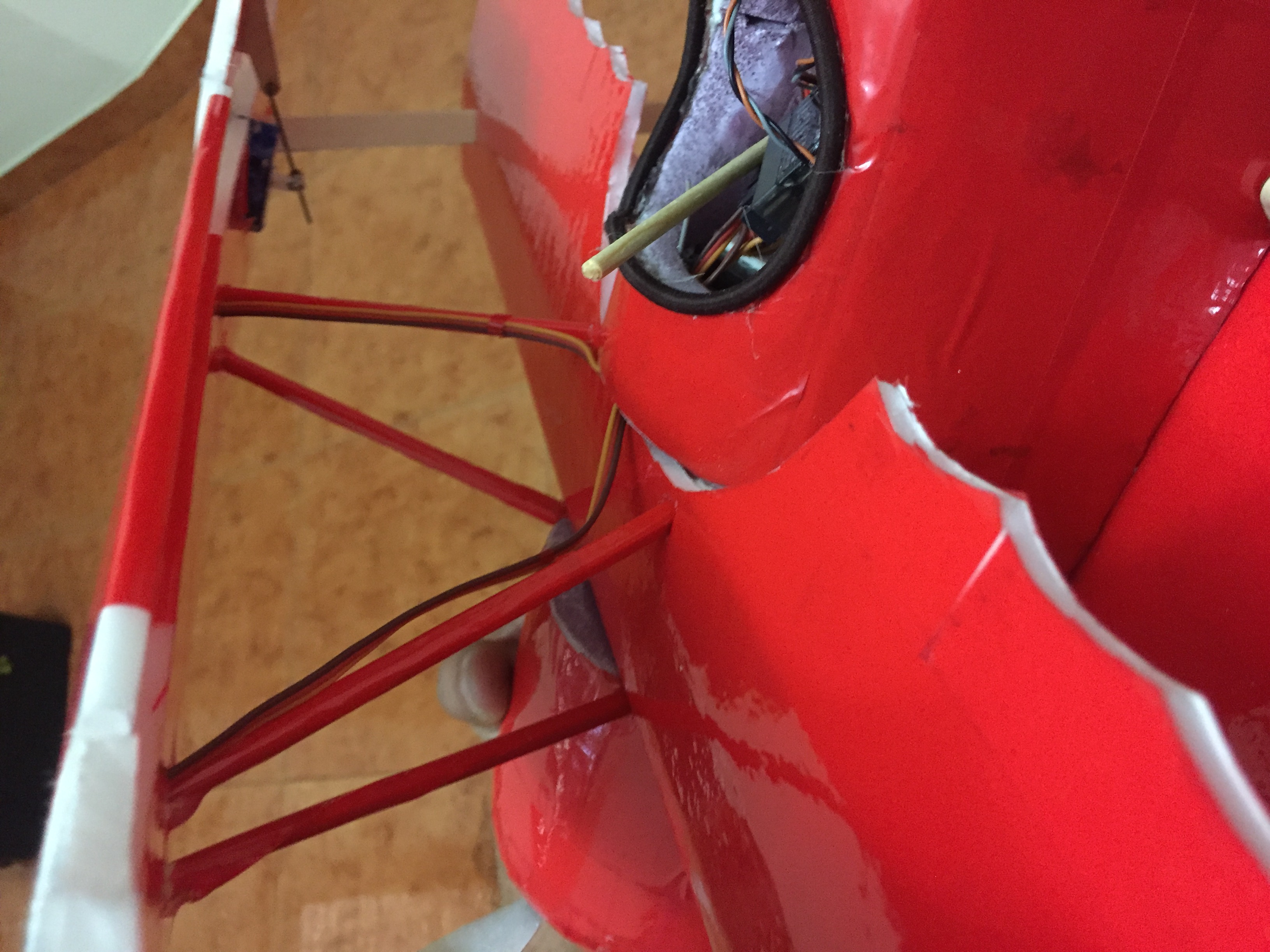

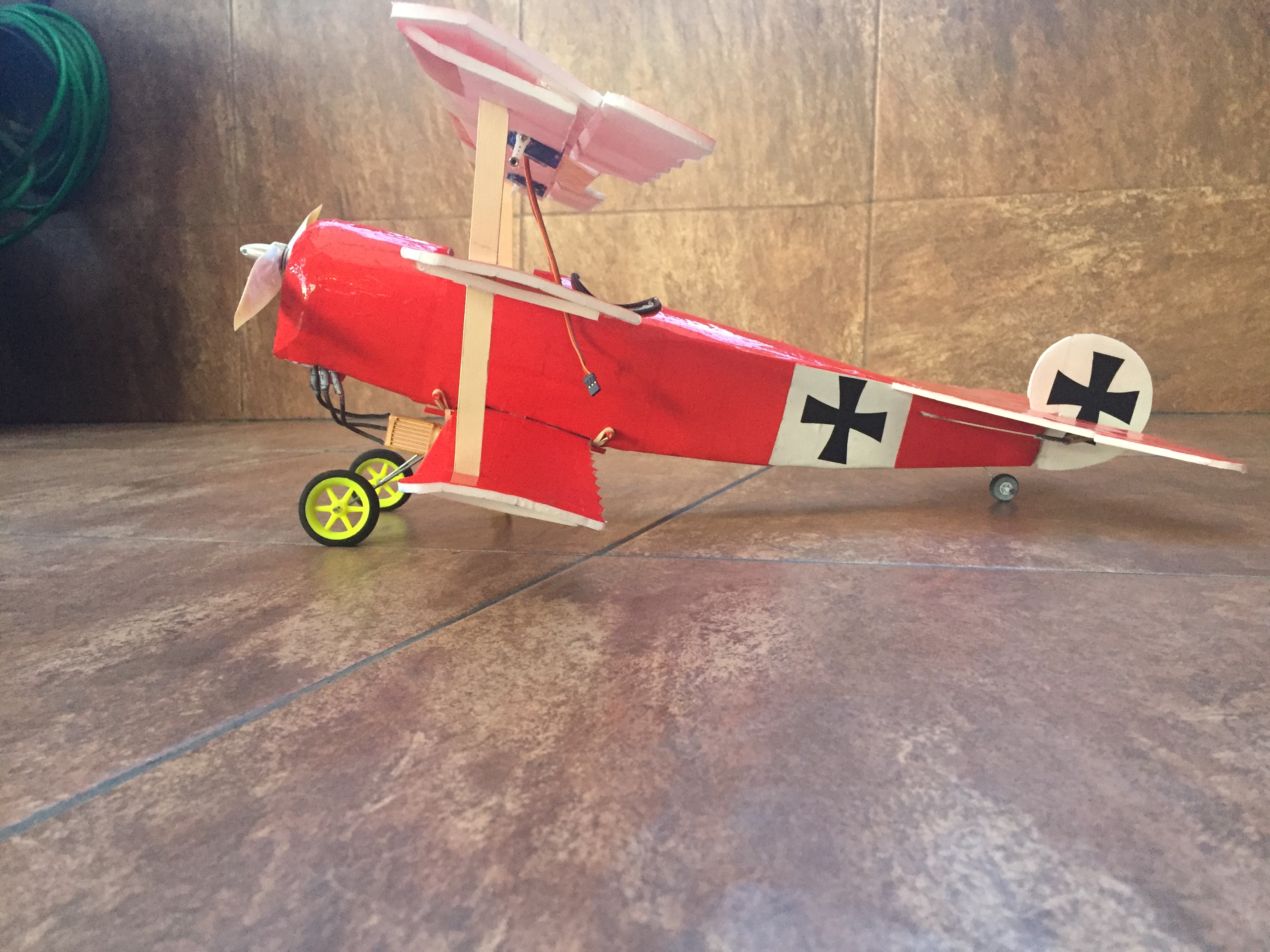

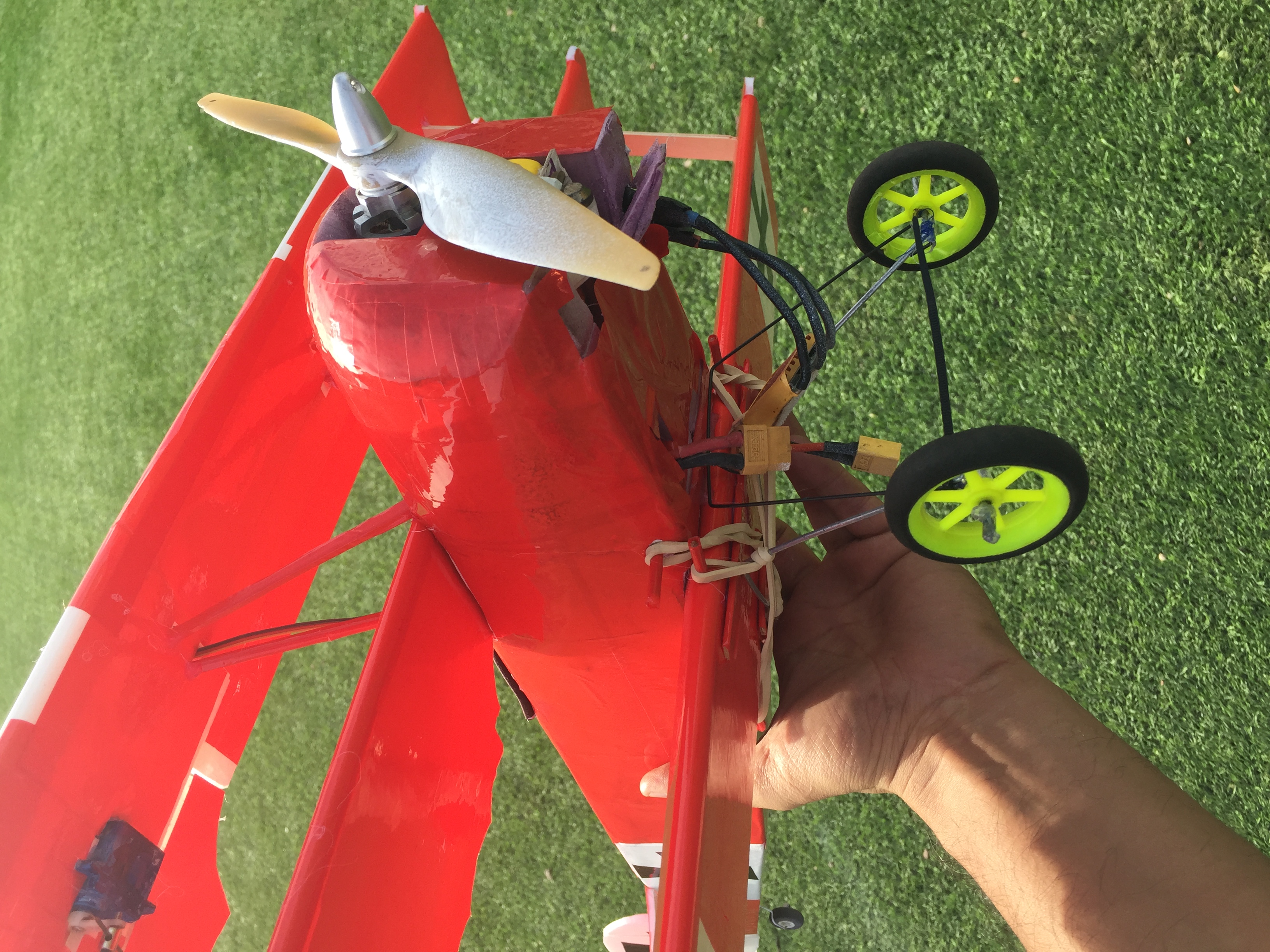

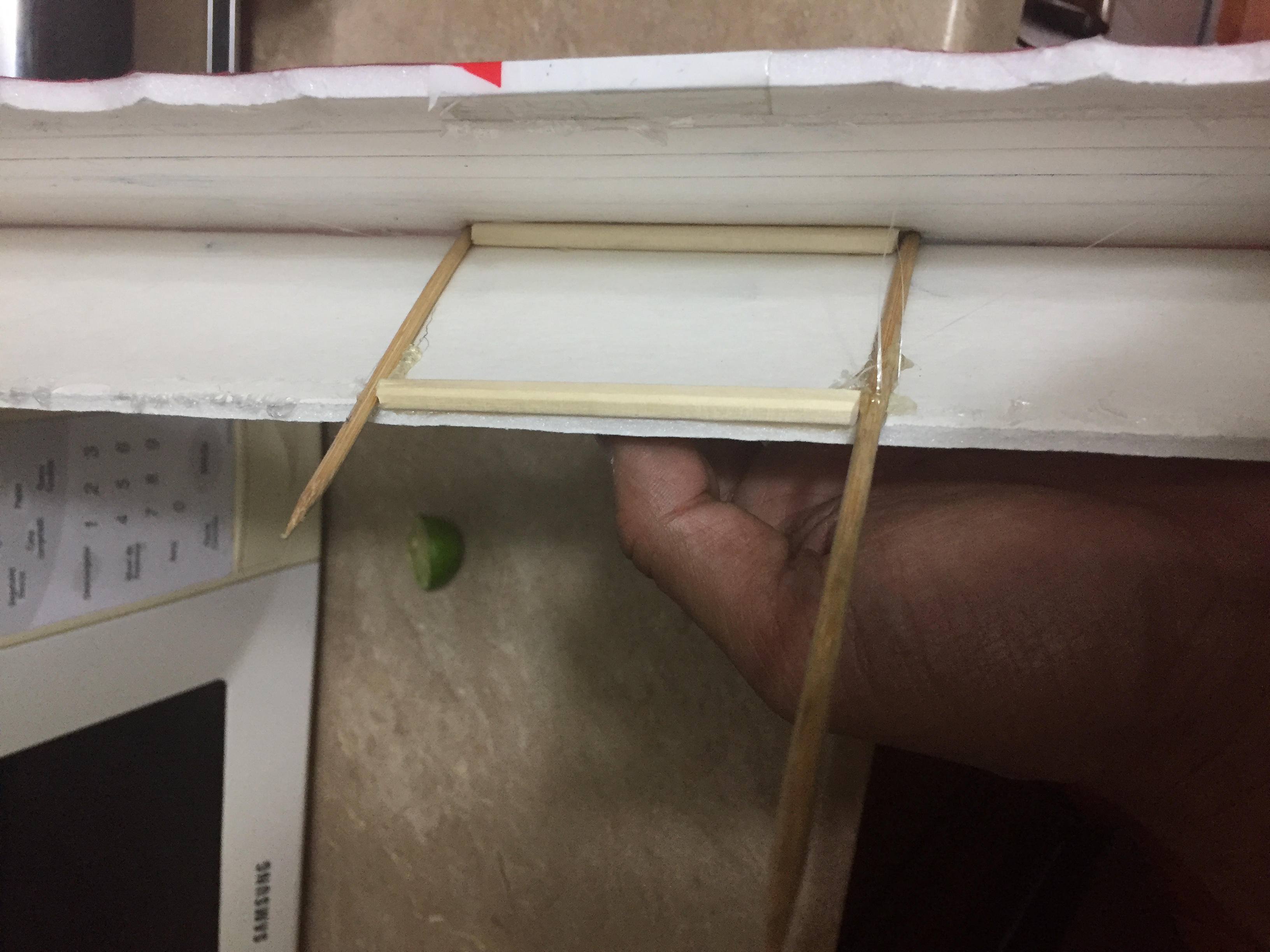

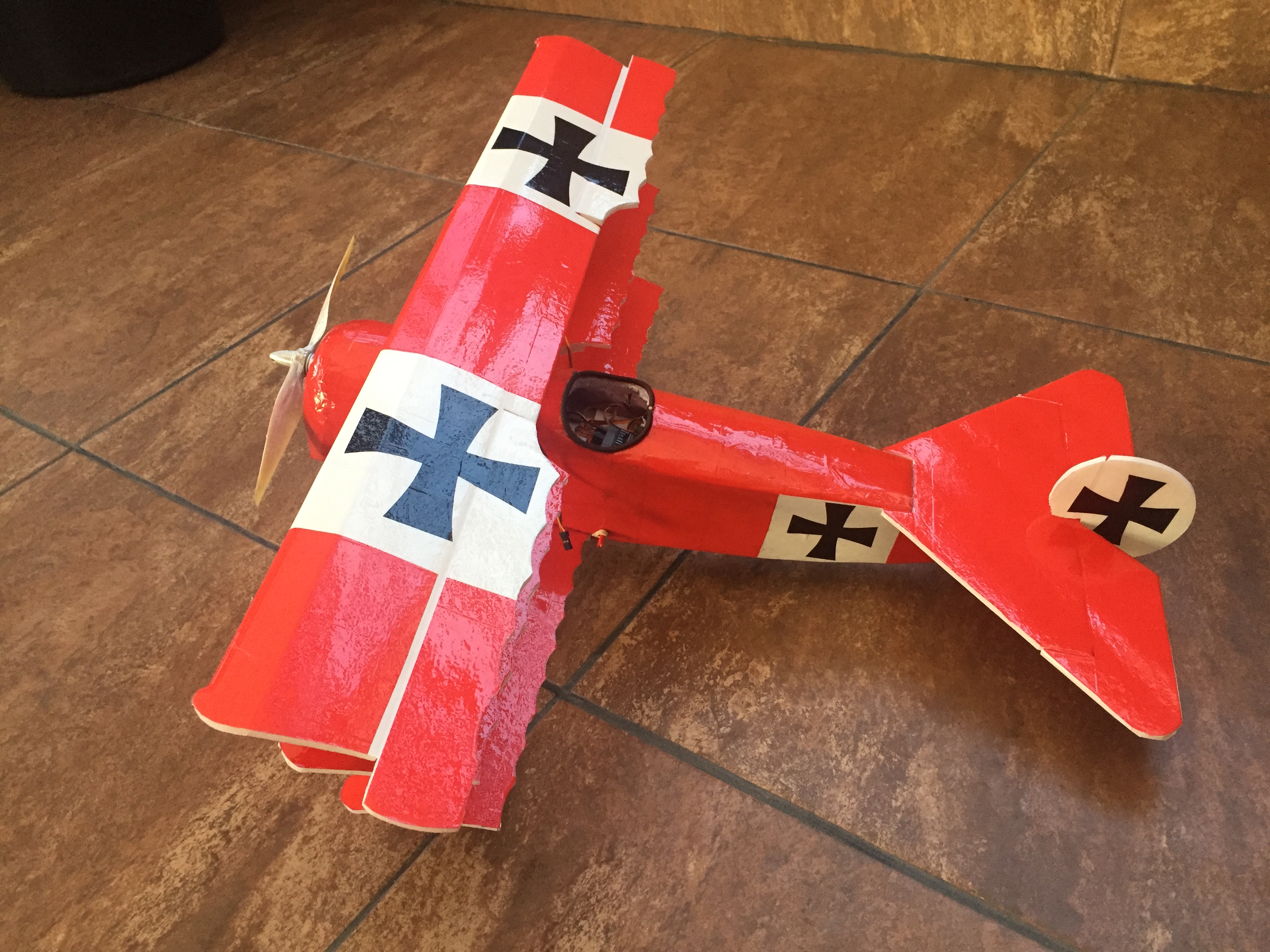

for landing gear..used some BBQ Skewers and sushi sticks , inside the wing, botton of the wing some popsicle sticks

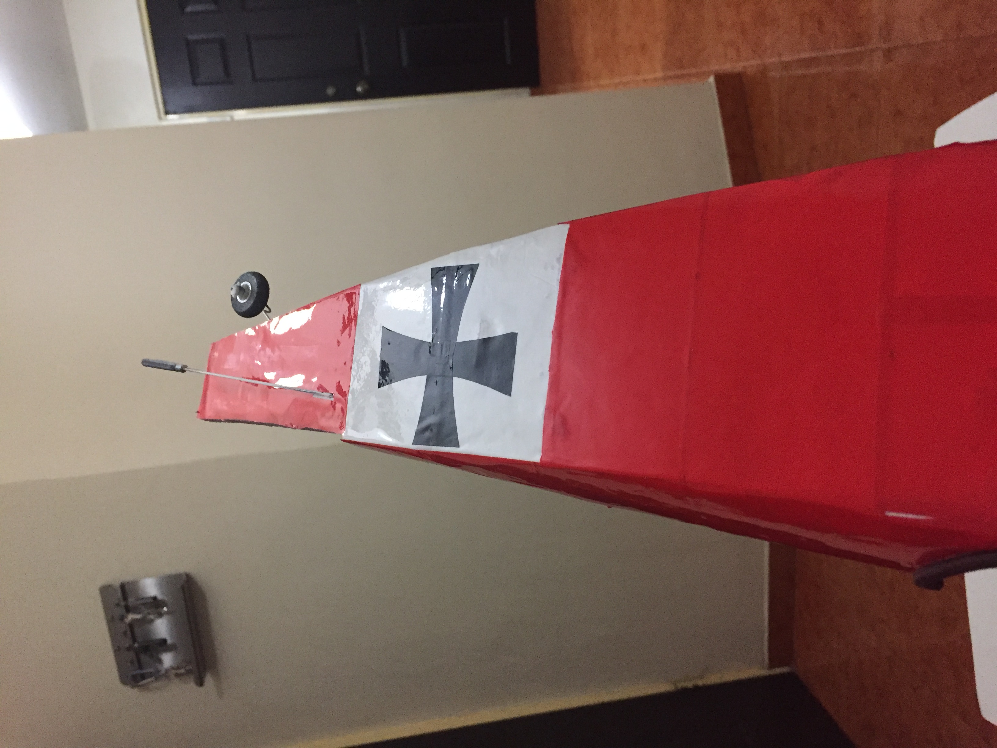

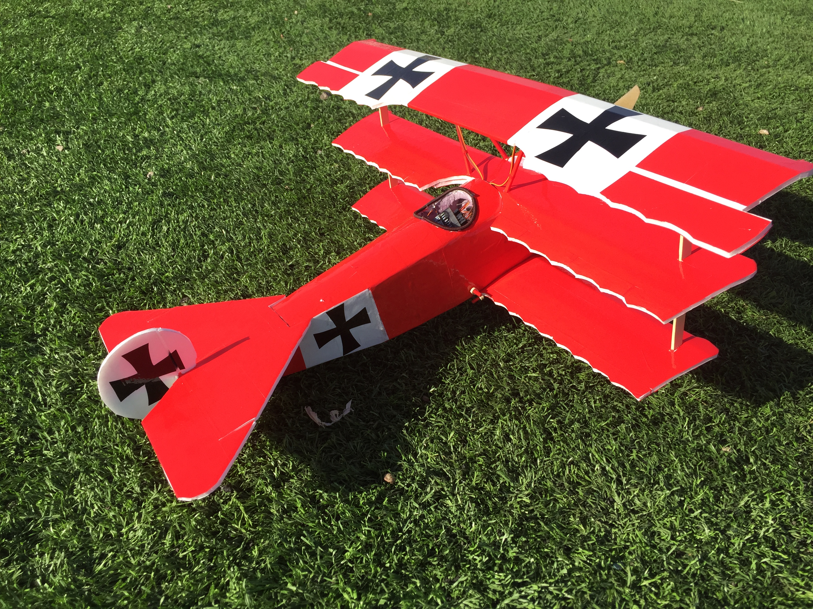

for the skin i use colored packing tape

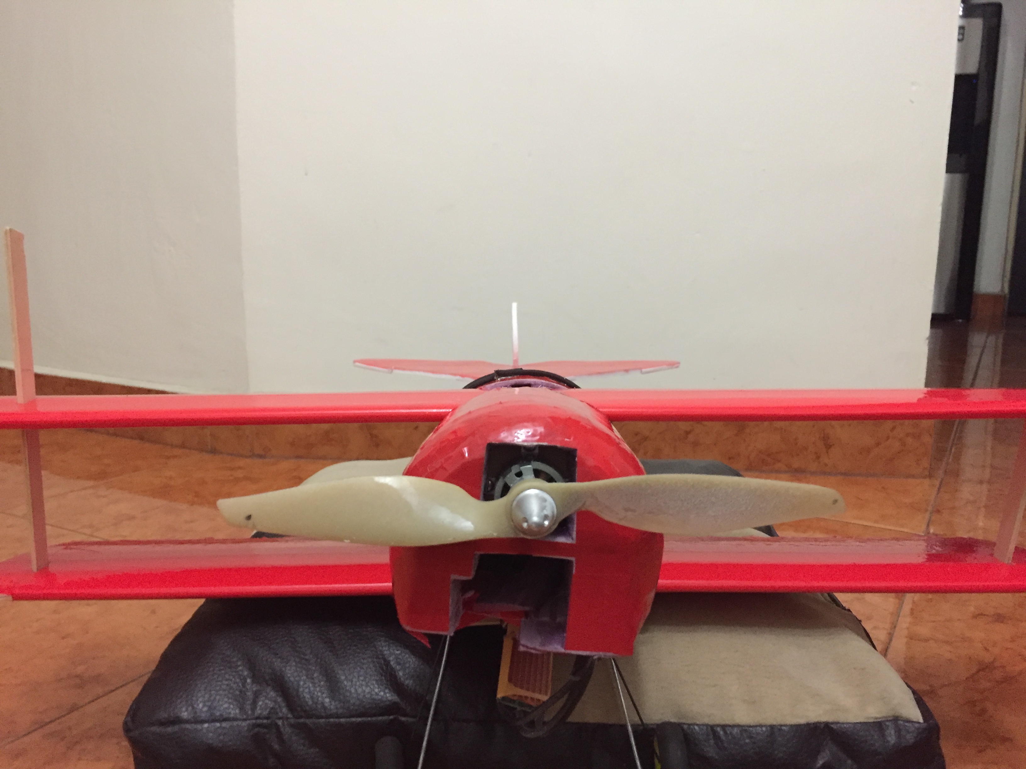

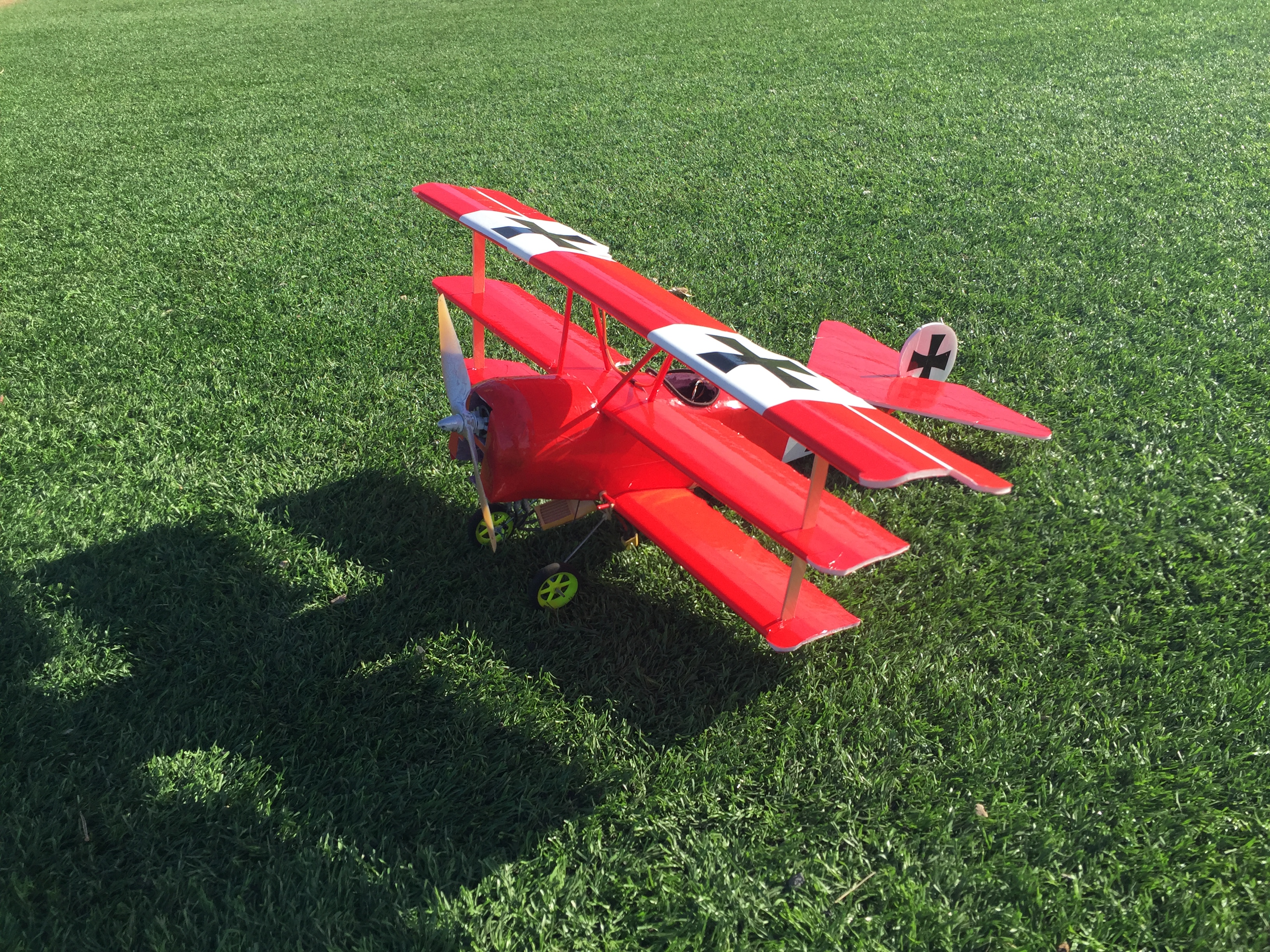

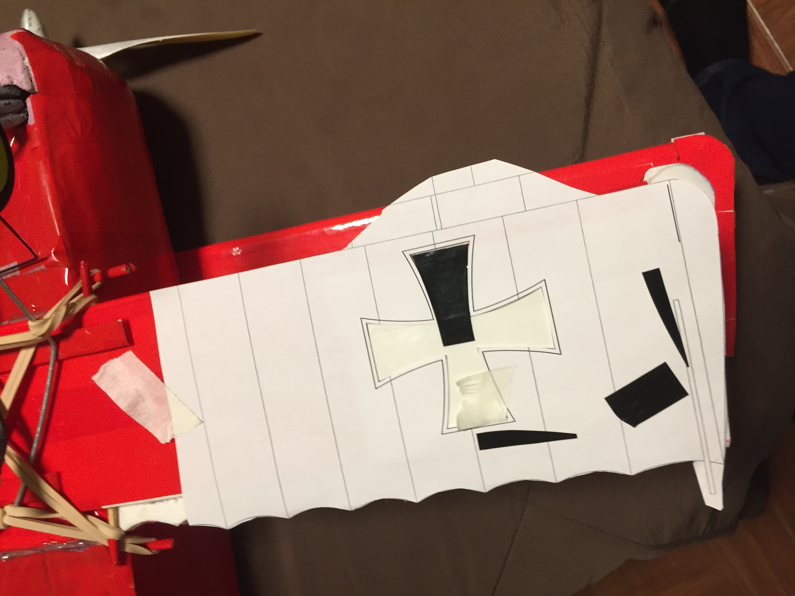

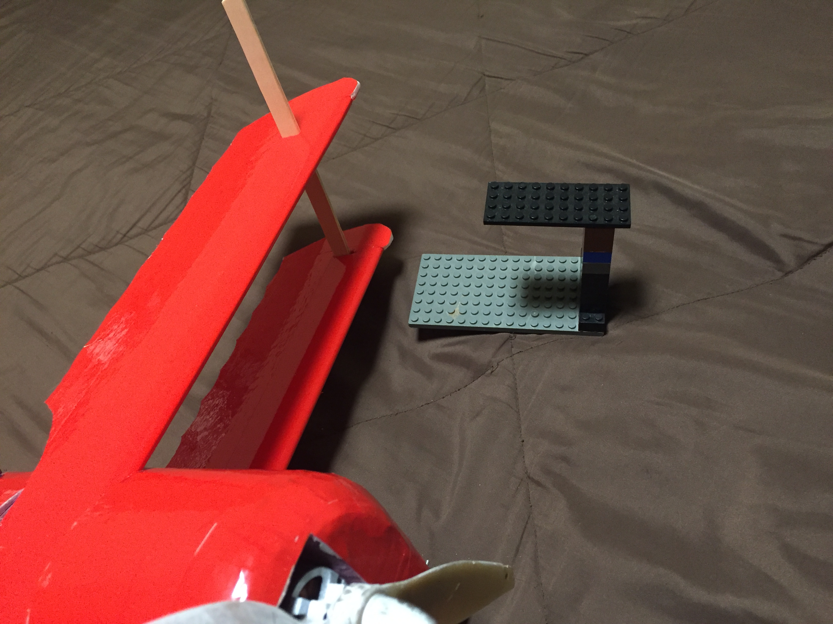

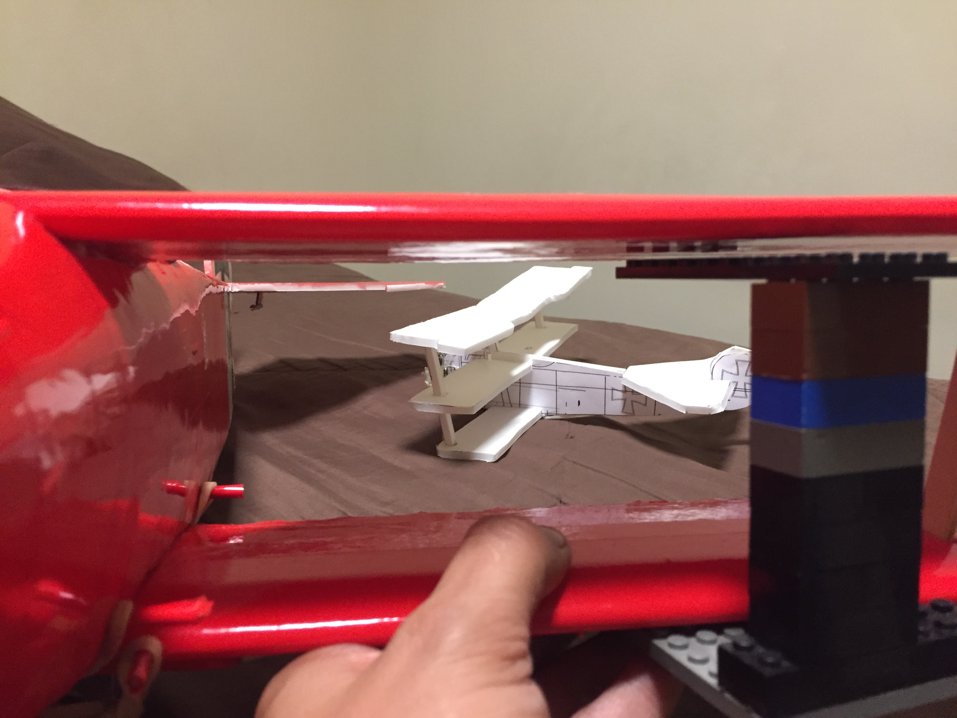

wings assembly, first i glue tail and rudder, then middle wing, makin aligned with elevator for the bottom wing i used some legos to make a parallel guagefinally the top wingcg testing...bottom decalsadding some nose  weight
