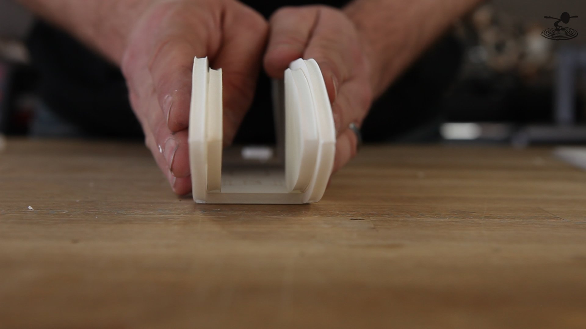

Both noses feature doublers, to help reinforce and strengthen the plane for any situation. With this, a beginner should be able to take a few hits and continue flying, if they didn't break a prop of course.

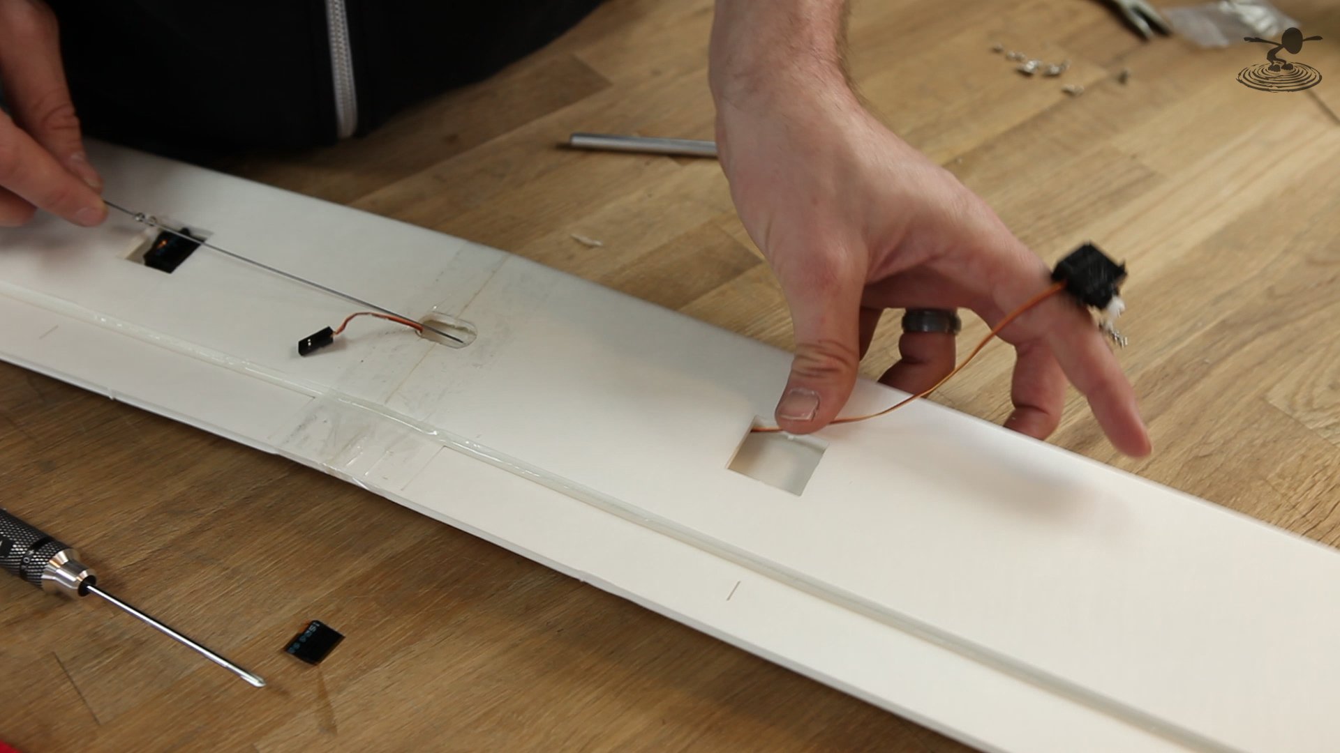

Be gentle when forming your wing. You shouldn't have to force it to much, and be patient with the glue.
Use some spare wire to feed the servos through the wing after its closed up.
