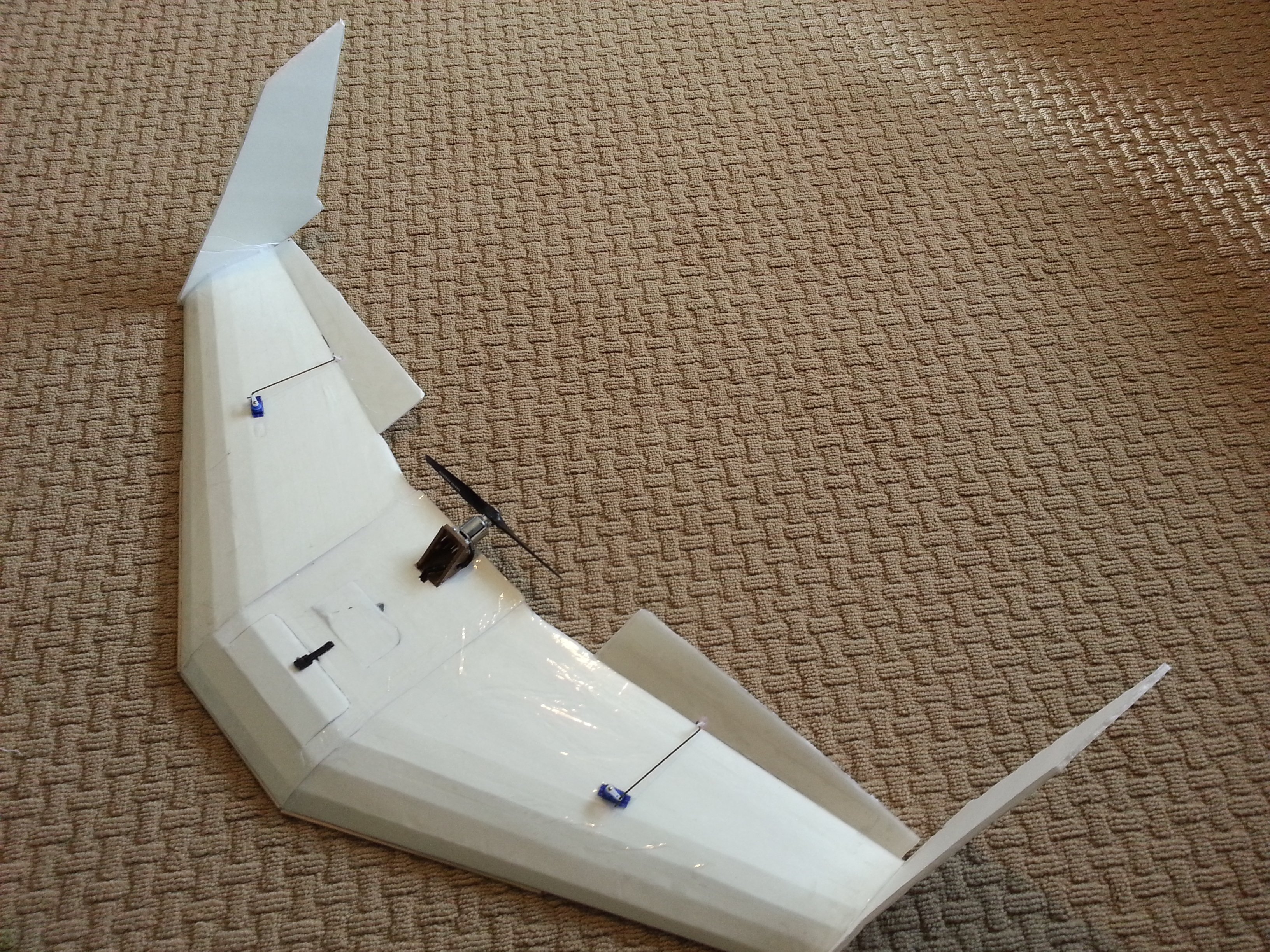

My first sucessful flight was with a FT Versa Wing, but I later realized that I wanted something bigger and even more versa(tile). After a few days of wondering what I was going to make next, I stumbled upon the FT Blunt Nose Versa. The BN Versa is bigger, and can carry more supplies and equipment. Later that week, I started the quick and simple build of the FT BN Versa.

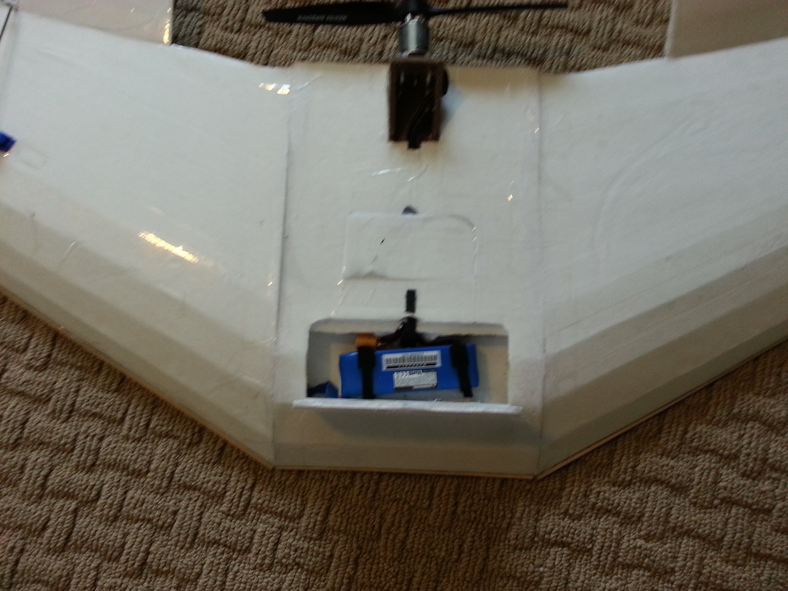

- Always secure the battery inside of the plane by using pieces of velcro to hold it down. If your battery flies out during flight,it will result in a damaged battery and plane.
- Mount your servos on top of the plane. Mouting them on top will prevent them from being damaged during a hard landing or crash.

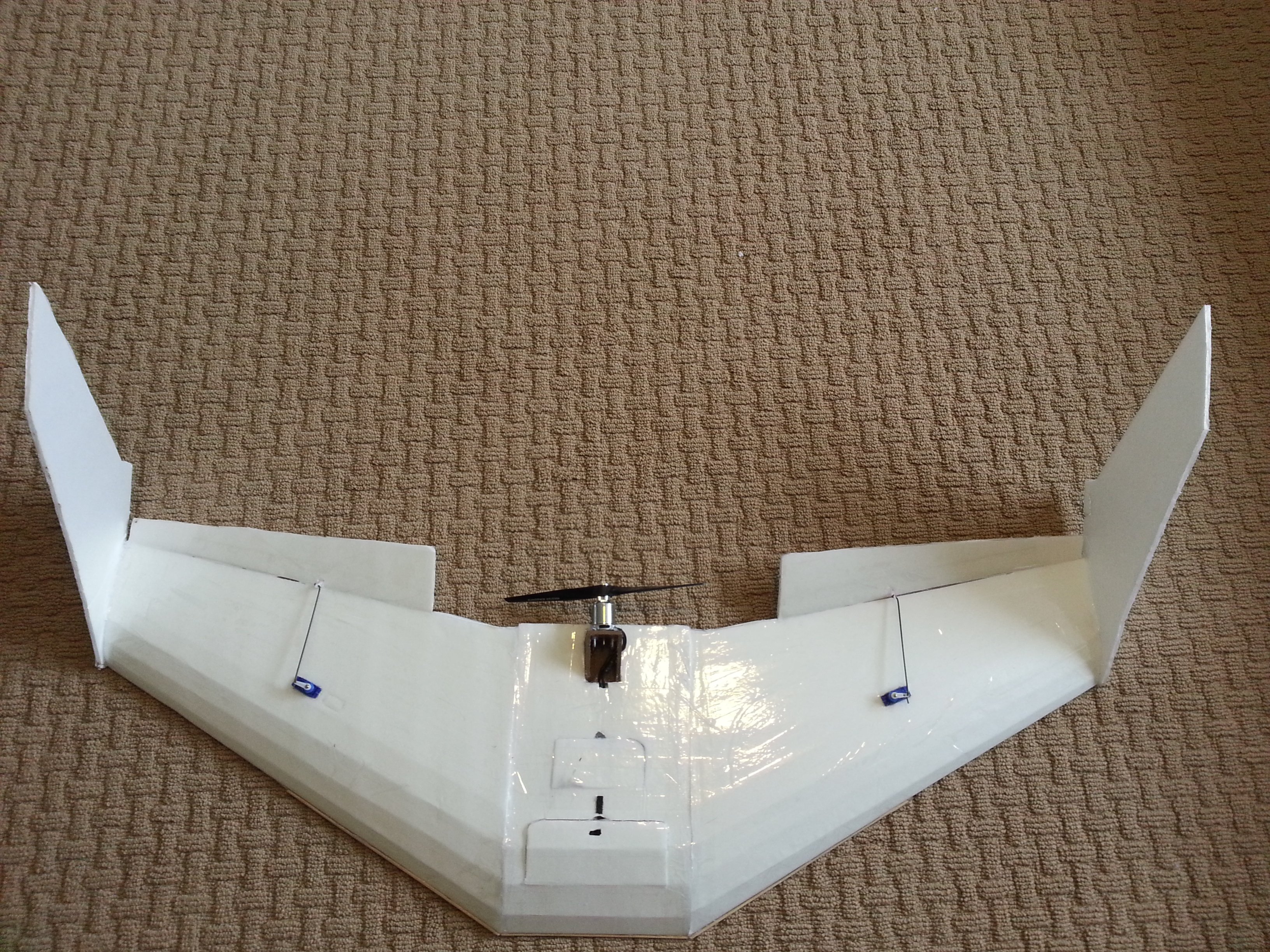

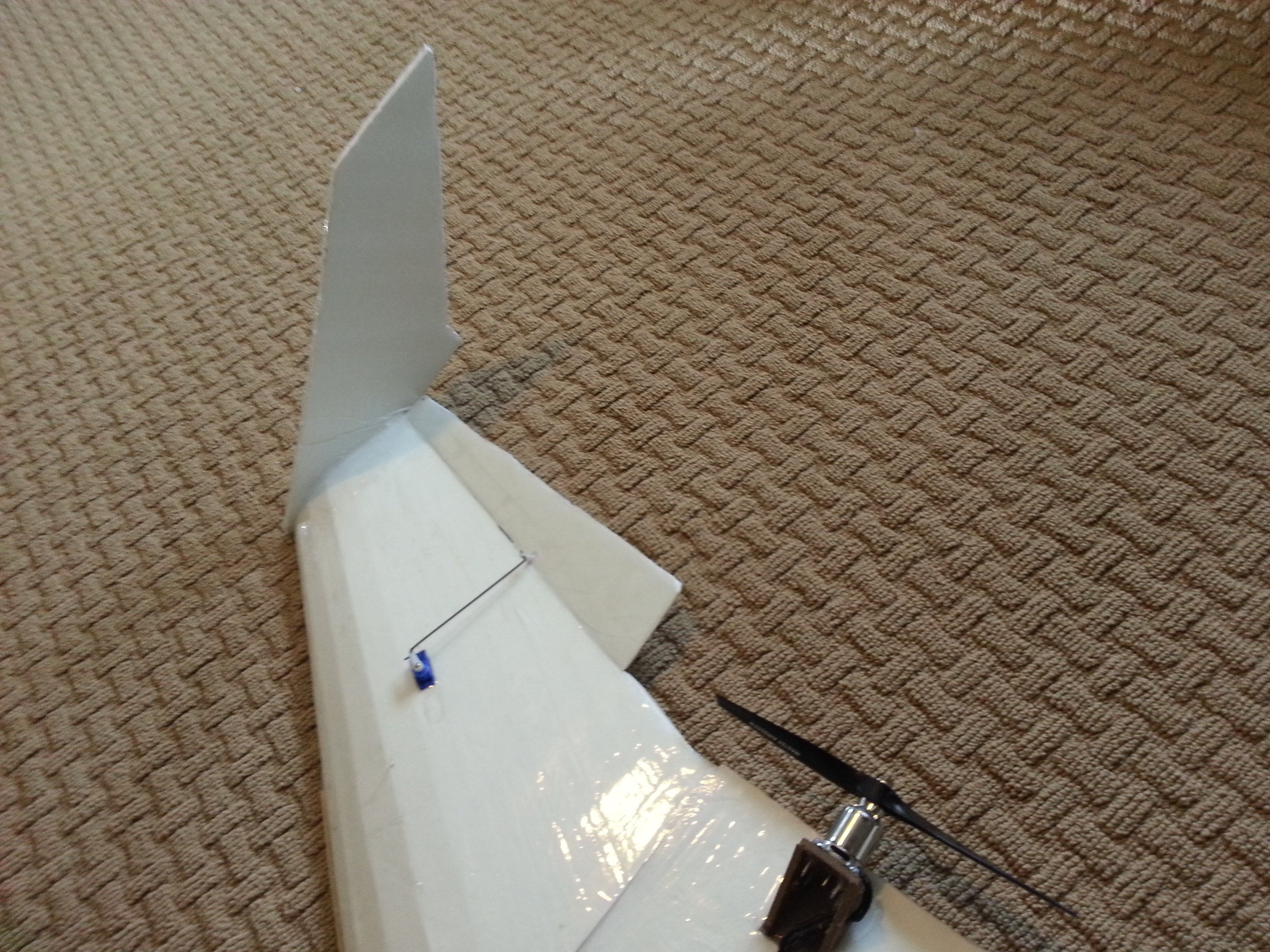

- Make sure that the winglets are parellel when installing them. Uneven winglets could cause unstable and unpredictabll yaw during a turn.

- Since the Blunt Nose is bigger than it's little brother, the FT Versa Wing, it should have bigger winglets. I used Red20RC's winglets on my FT BN Versa. These winglets are amazing, they are extremely simple to build, and are very affective when flying the BN Versa. You can find the plans for Red20RC's winglets here.

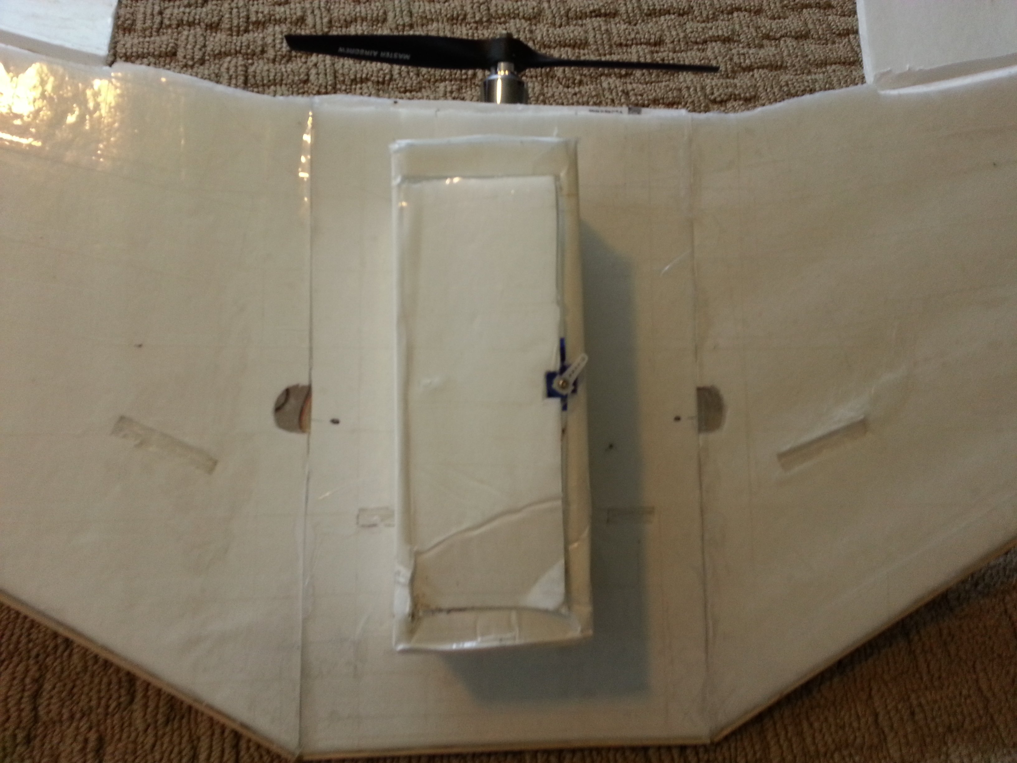

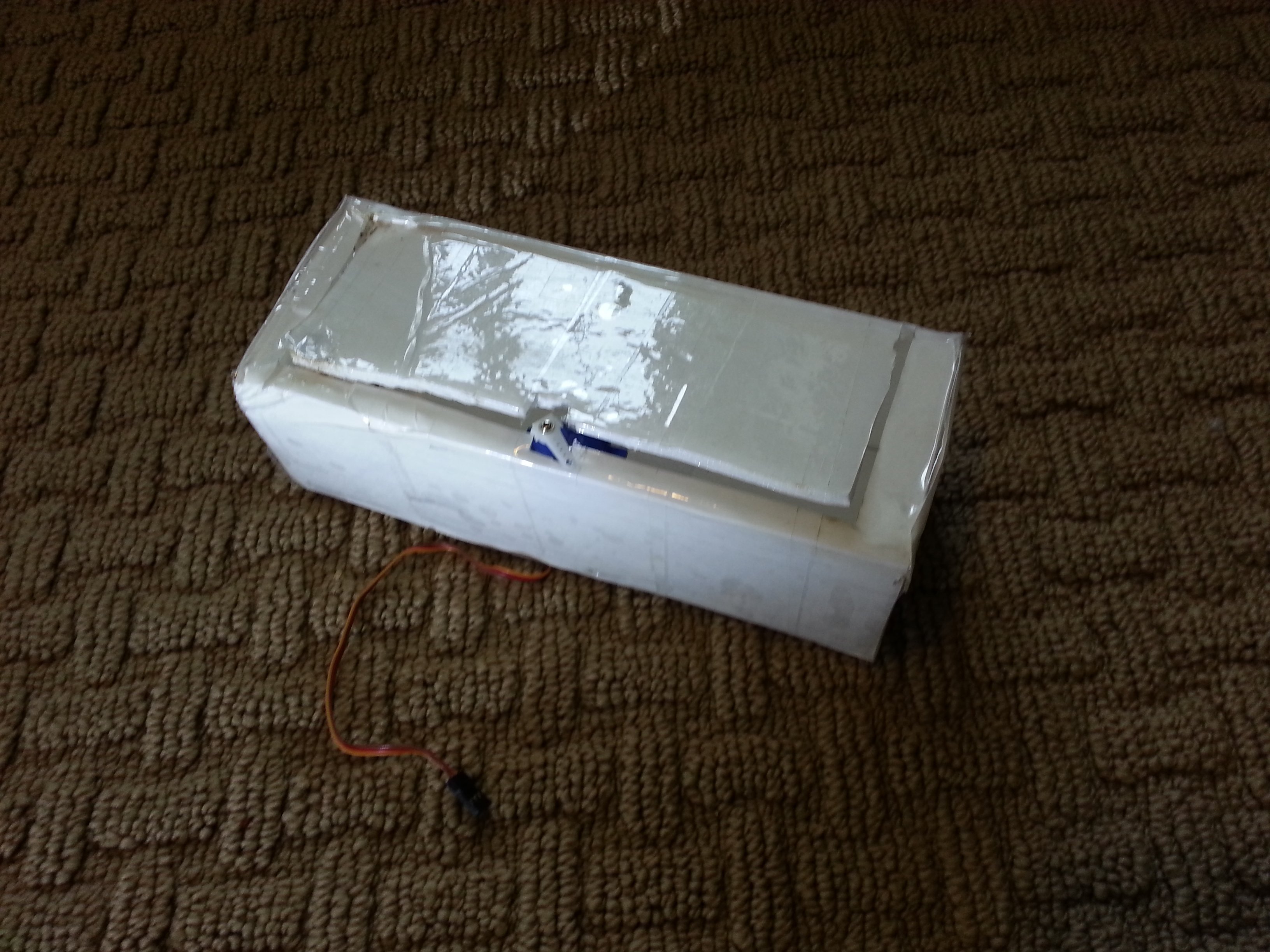

- Within my short 4 months of learning to fly, I have wanted to be able to use a bomb drop. Since this plane flew so well, I decided to design a bombdrop that would fit and function on the FT BN Versa. The bomb drop is very simple, it is a long rectangle, with a hatch on the bottom. When I push the gear switch on my controller, the hatch, activated by a servo, will open releasing anything inside. The bomb drop sits on the bottom of the Versa, and is held on with a piece of velcro and tape. I wanted the Versa to be even more Versa(tile) which is why I designed the bomb drop to be easily removed when you feel like it.

One little question: Do you have some gears, or anything to protect this bomb drop bay ? it seems already a bit crumbled...
Anyway, I like your idea of adding a bombdrop thing on your versa wing.
