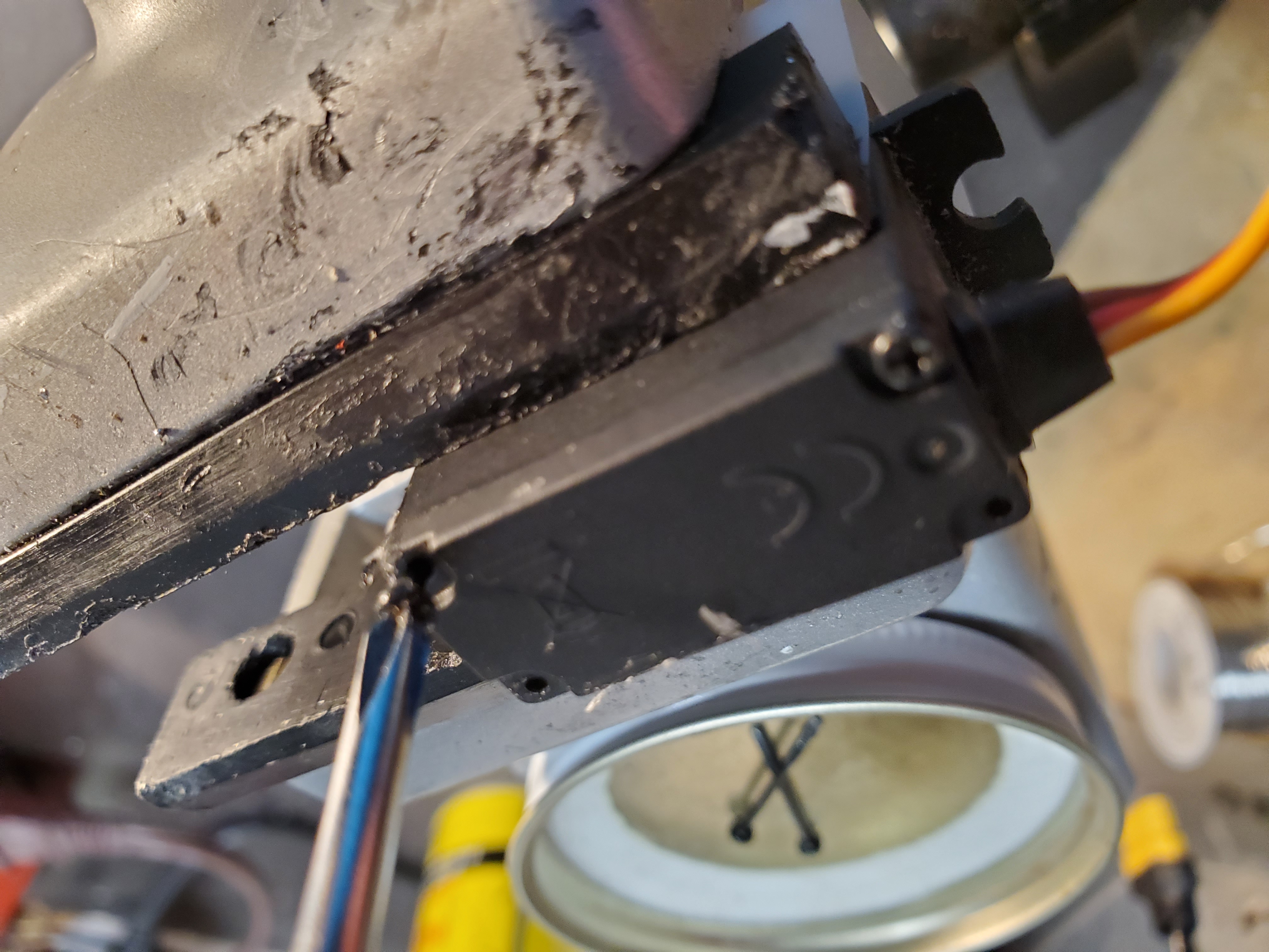

step one: get the servo you want to reverse, and unscrew it, being careful not to lose any gears or screws, it may be a good idea to simply tape the top of the servo, in order to prevent it from falling off when you unscrew the bottom (small cups or cans can be useful for keeping track of parts).
