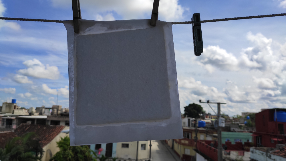

When we have finished, will hang it and let it dry in a ventilated place but avoiding the direct sun light. The direct sun would produce a differentiated drying of the layers and could produce some deformations.

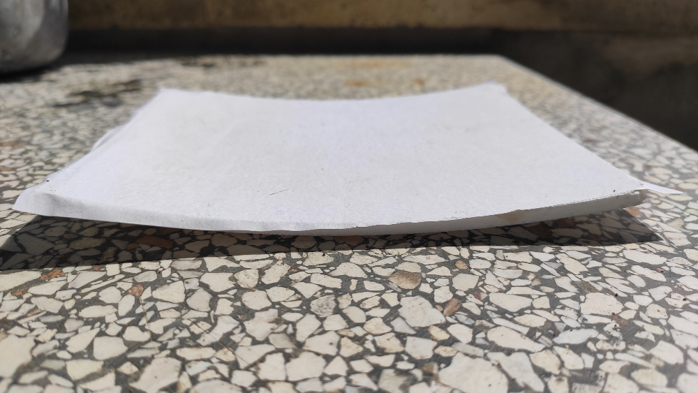

Sometimes it is necessary to remove the inner layers of the foamboard, so why not make your own foamboard with a single layer of paper? The answer is NO! While the glue dries, the fibers of the paper tend to shrink, which causes twists in the foam sheet. The result is a twisted and unusable foamboard.
With only one layer of paper on the bottom after drying under the sun.
