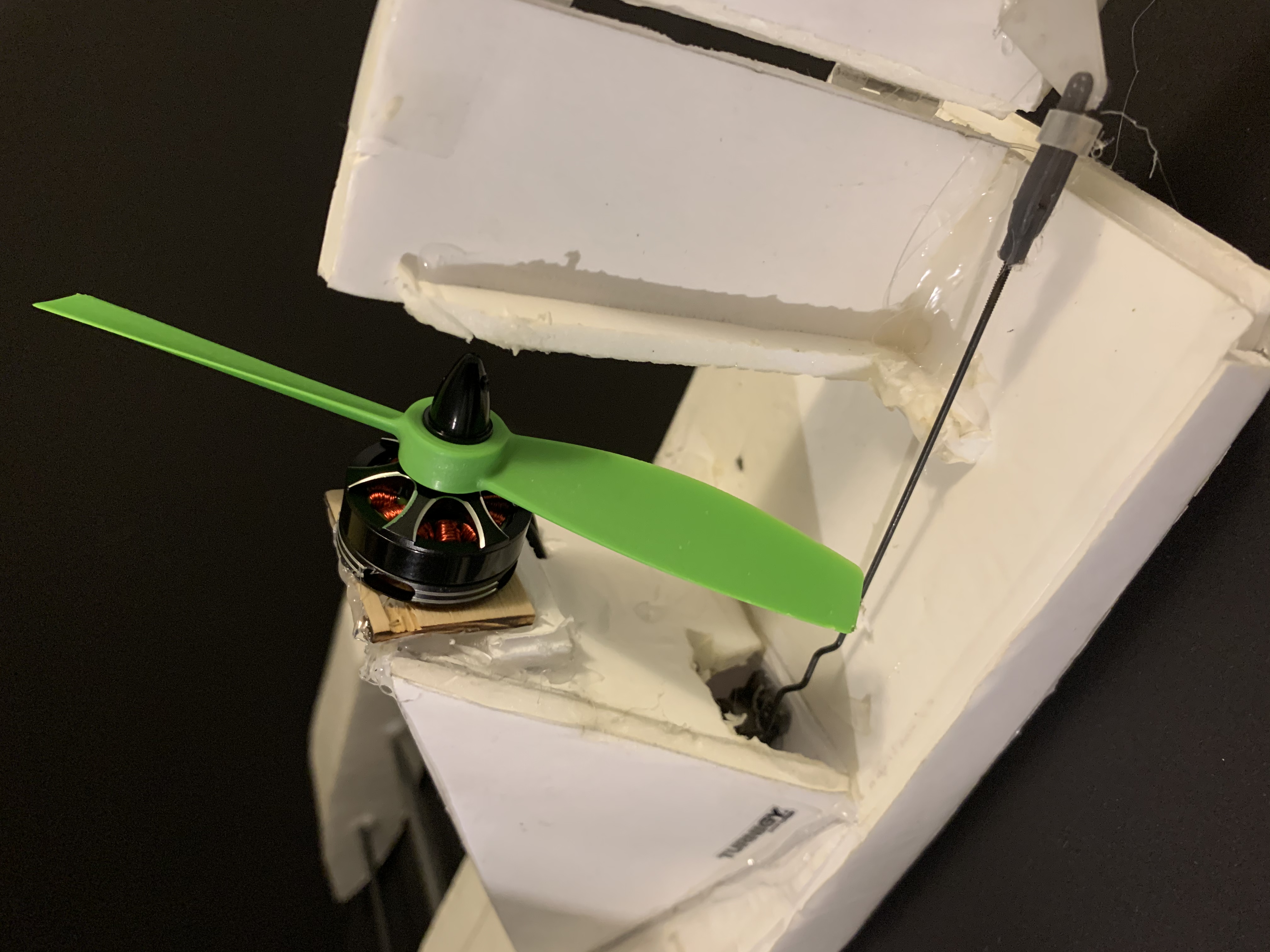

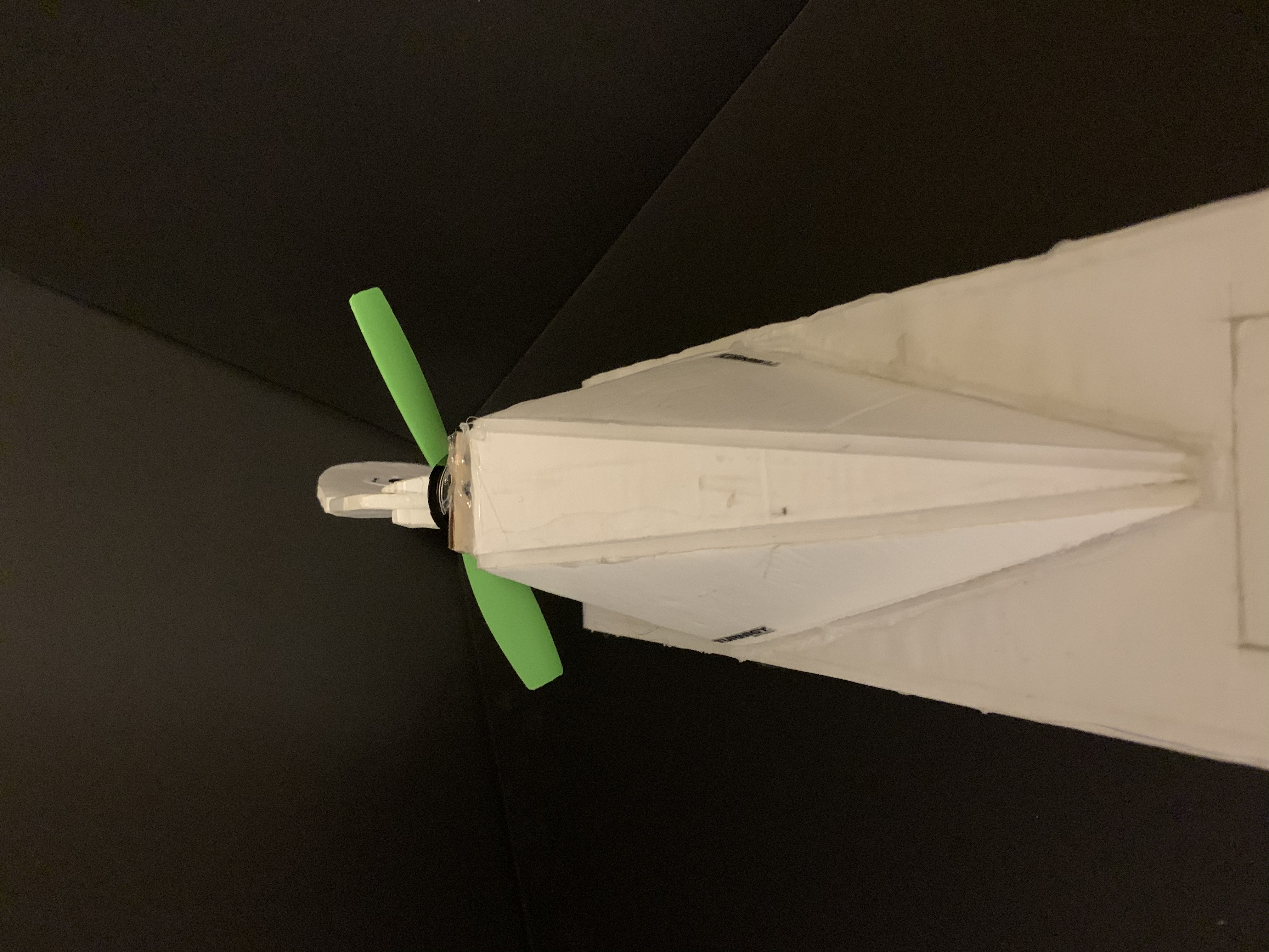

Without much access to Maker Foam or water-resistant foam board, I just used the standard Adams Reddi-Board. To get it ready for snow, I coated the cut pieces with Polyurethane. I built up the motor stanchion into something a little more solid and had to make some adjustments to the plans to completely enclose the sponsons.

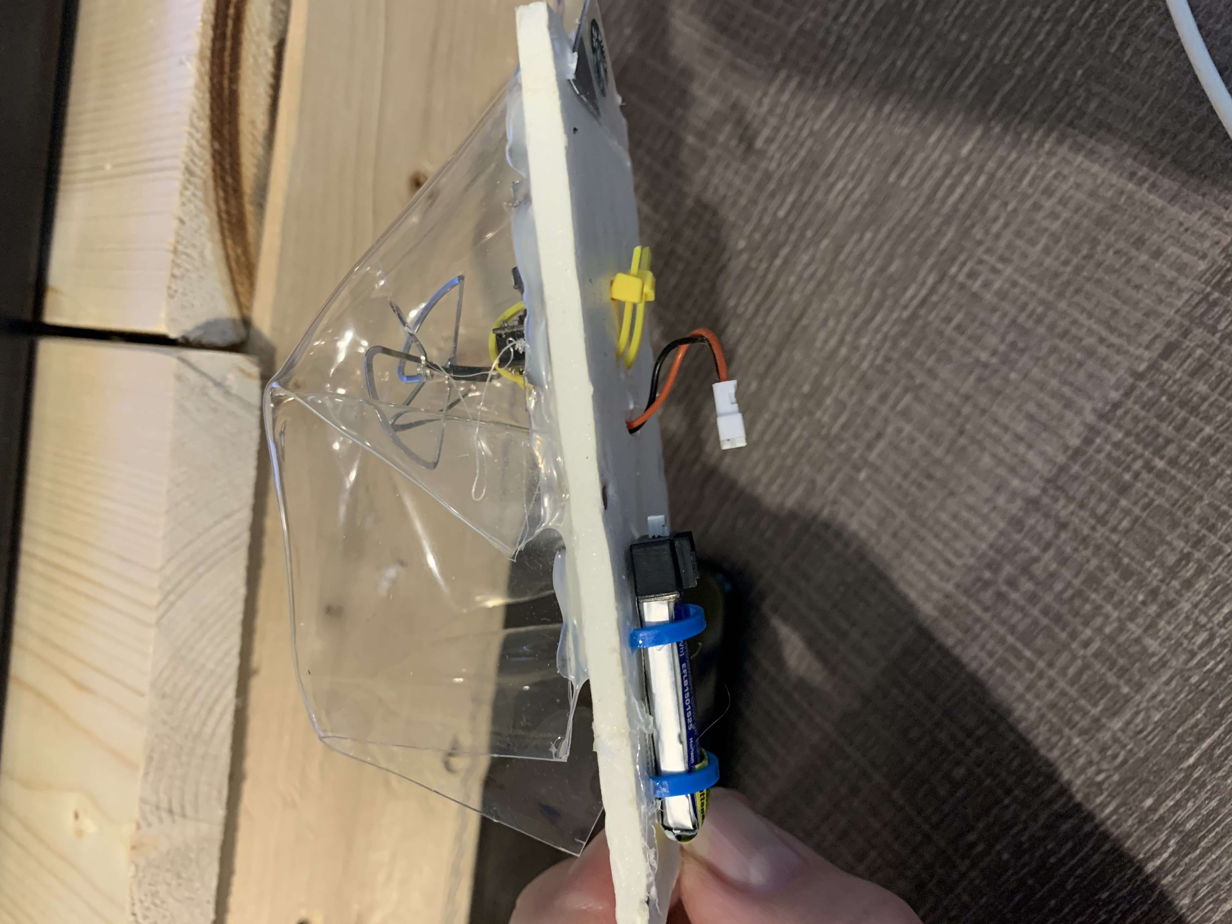

I added a magnetic hatch and then put together a second hatch with a rudimentary FPV setup (canopy looks rough but will keep the snow out).
While I still had everything open, I stripped some lights off of a decommissioned flying wing and ran them through the hull and out into each sponson. My struts are CF rods and i had some clear shrink tube that fit perfectly over the rods and LED wiring.

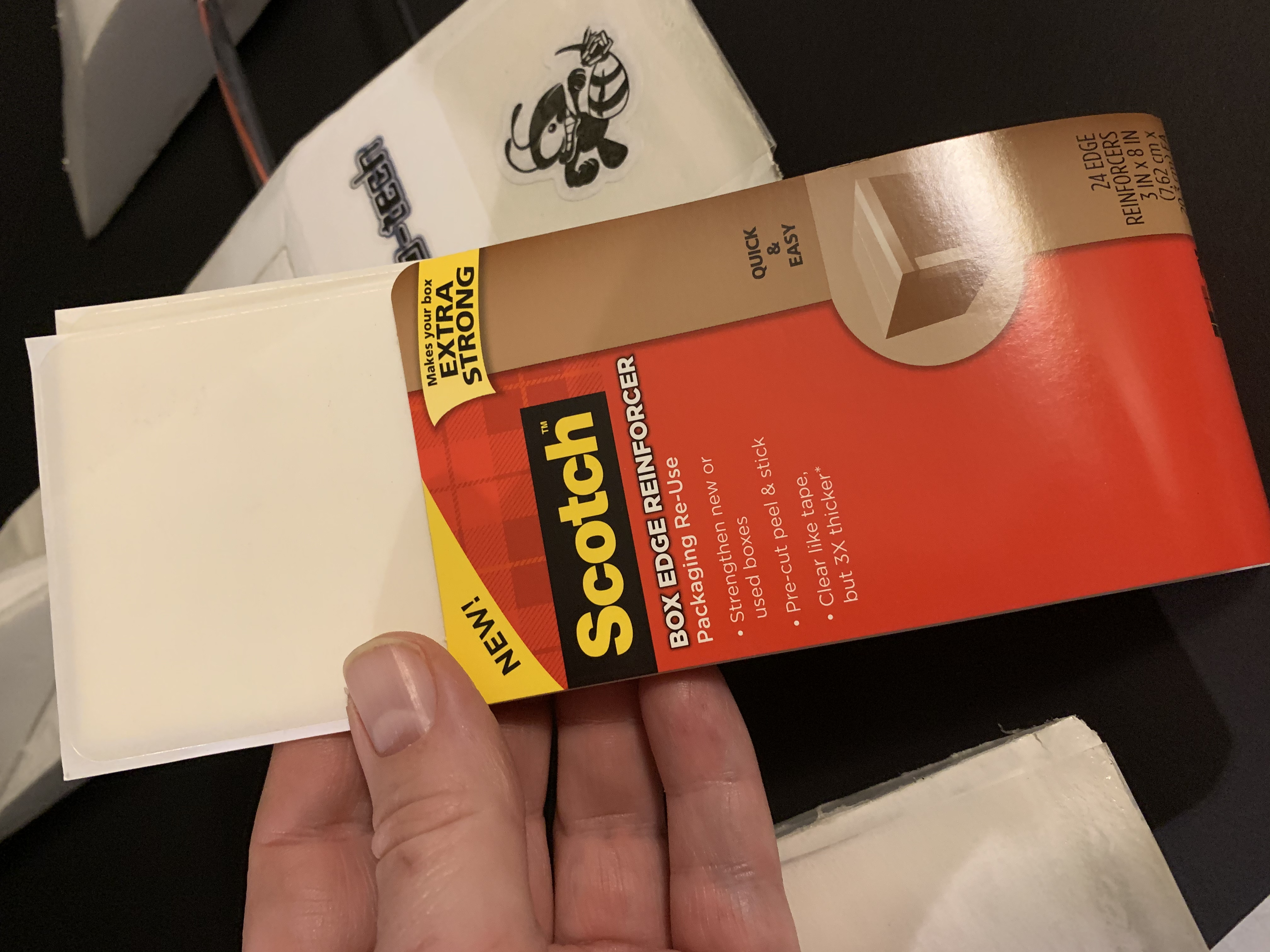

To help with tracking in the snow, I added some bamboo skewers to the bottom of the hull and sponsons. I found some 3mm thick tape strips at the dollar store that are meant to reinforce box corners but are fantastic for using with scratch builds and repairs. I used them to cover the bottom of the hull and the sponsons to add strength and reduce friction.
