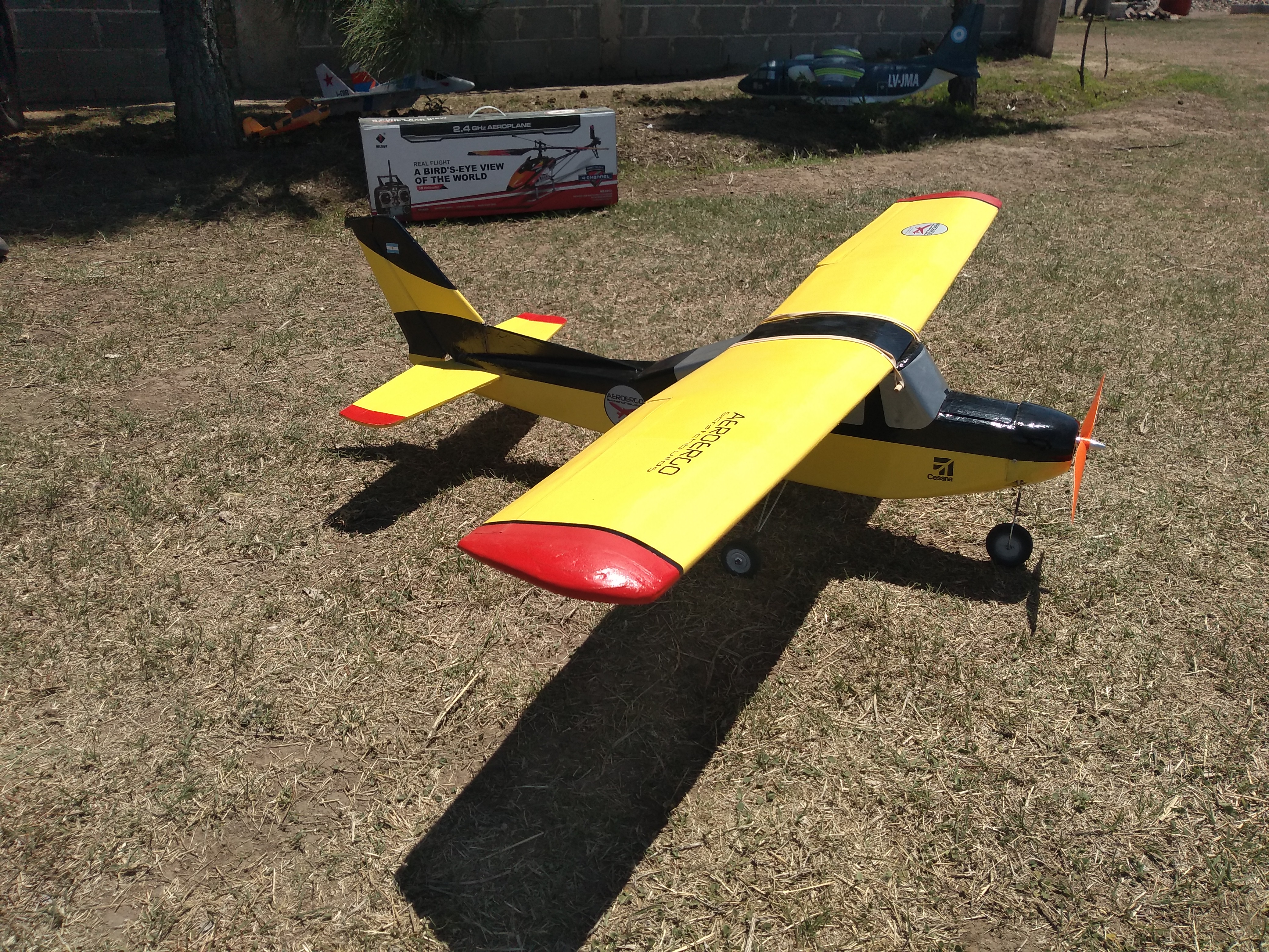

Specs:
Wingspan: 1230 mm
Length: 960mm
MTOW: 745 Grs.
2830 - 1400 Kv Motor
3S 1500 mAh 45C Battery
9x5 Propeller
30A ESC

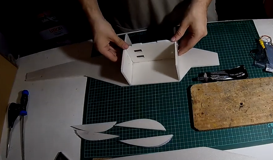

The fuselaje is a classic but reinforced box-shaped structure:

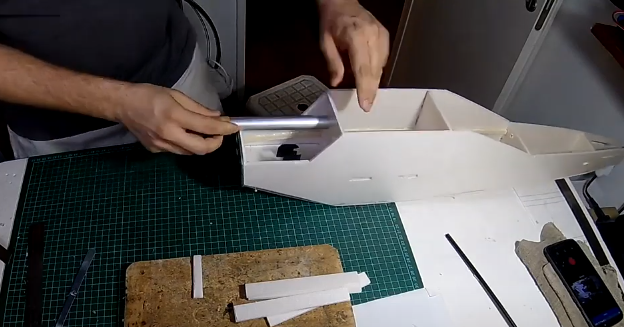

To reduce weight, and make it easy the electronics installation i drill few holes with a old Gas plane spar but you can use any metal tube sharply enough.

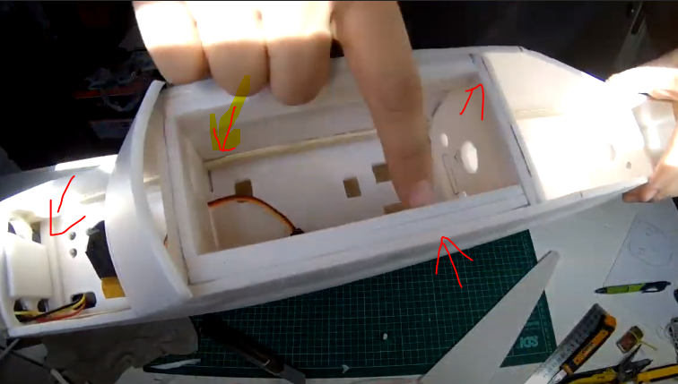

Here you can see the reinforcements in key parts to make it hold the hard handle of a beginner pilot, where the wing lays, behind the F1, and all along the fuselaje sides:

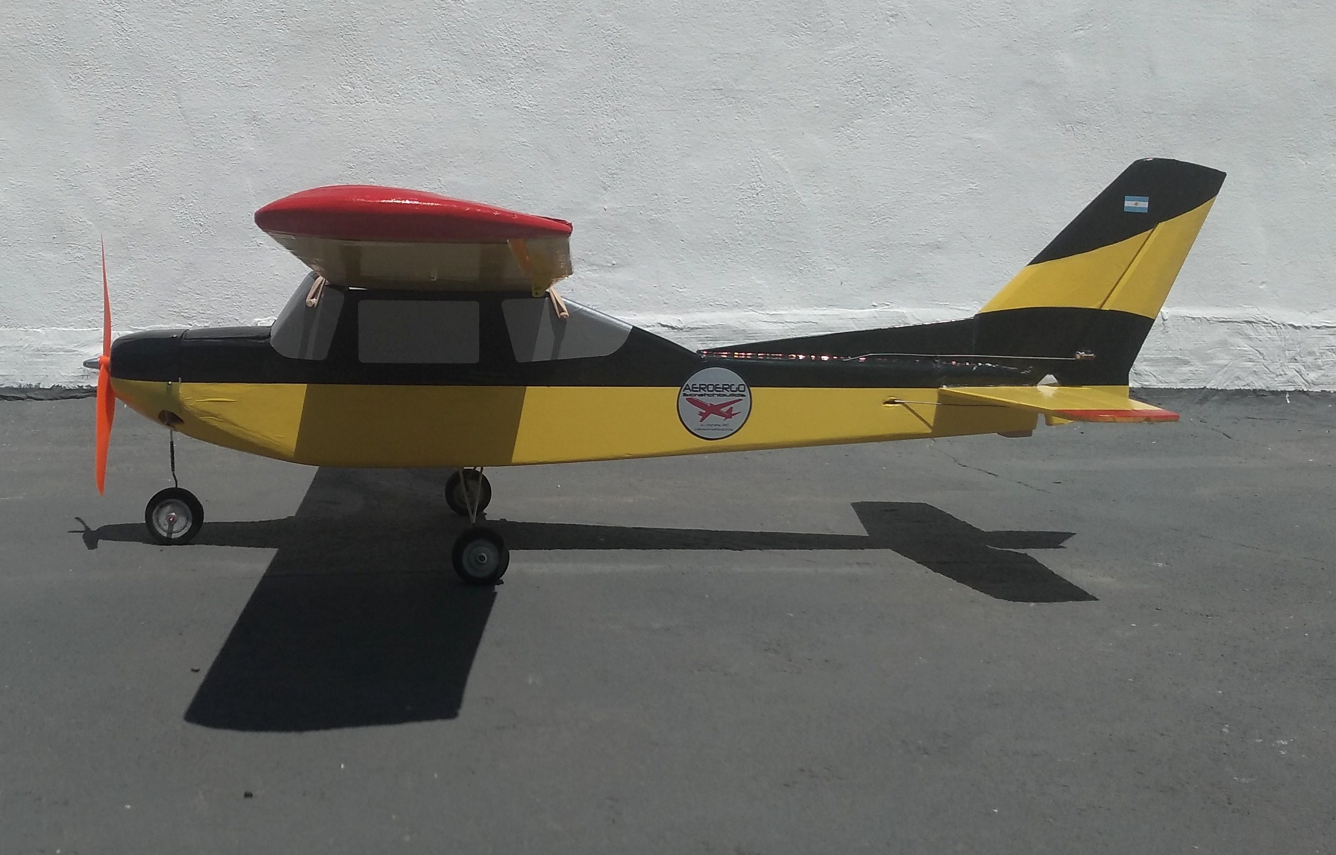

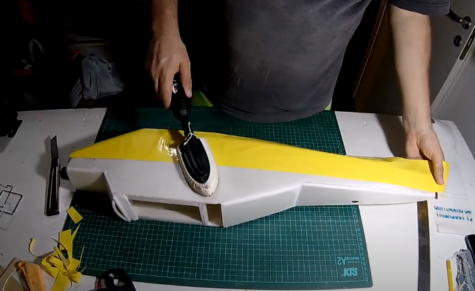

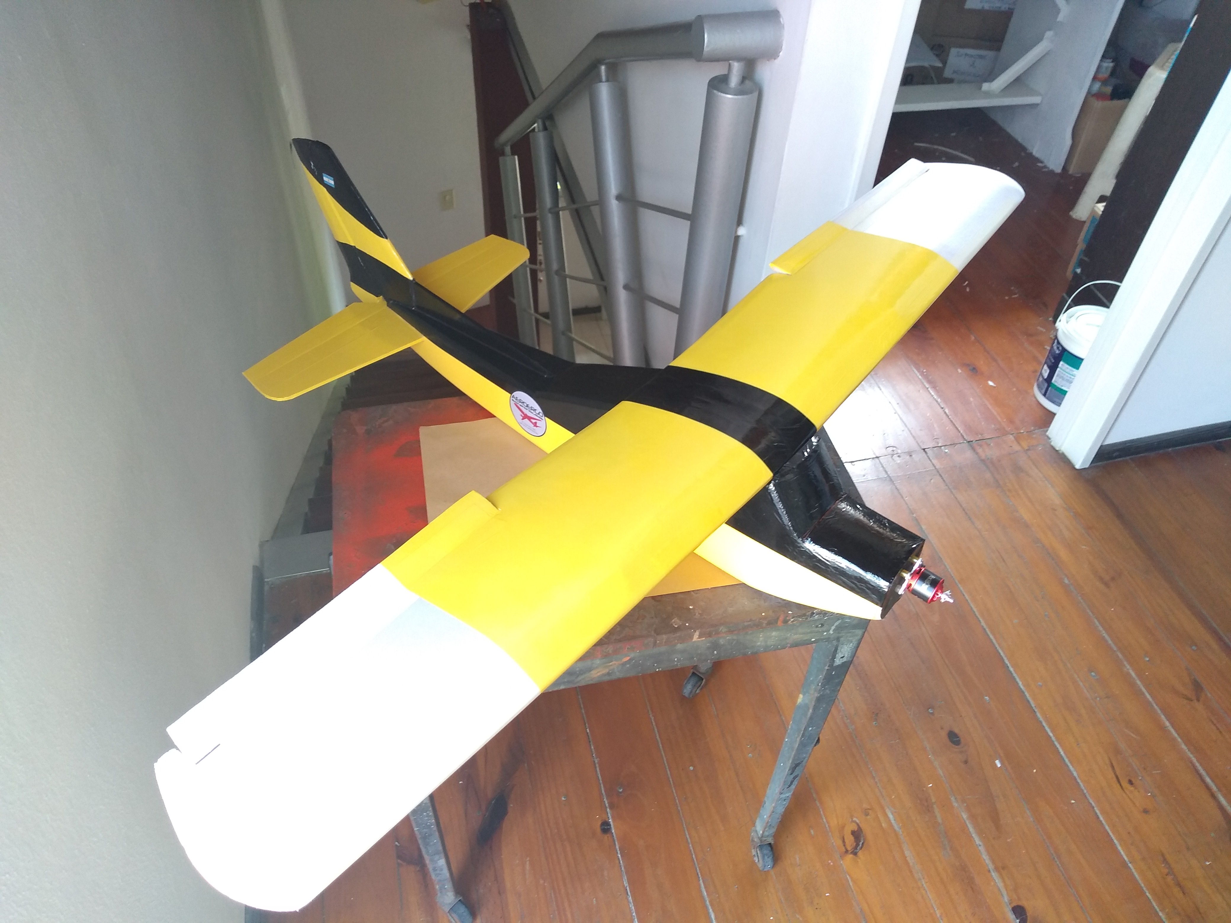

As always do, i tried a new technique to cover the plane, with laminating film painted with Rustoleum spray paint, an important tip: Paint the inner side of the film, later the heat will do his work anyway.
You can see how smooth and shinny is the result:

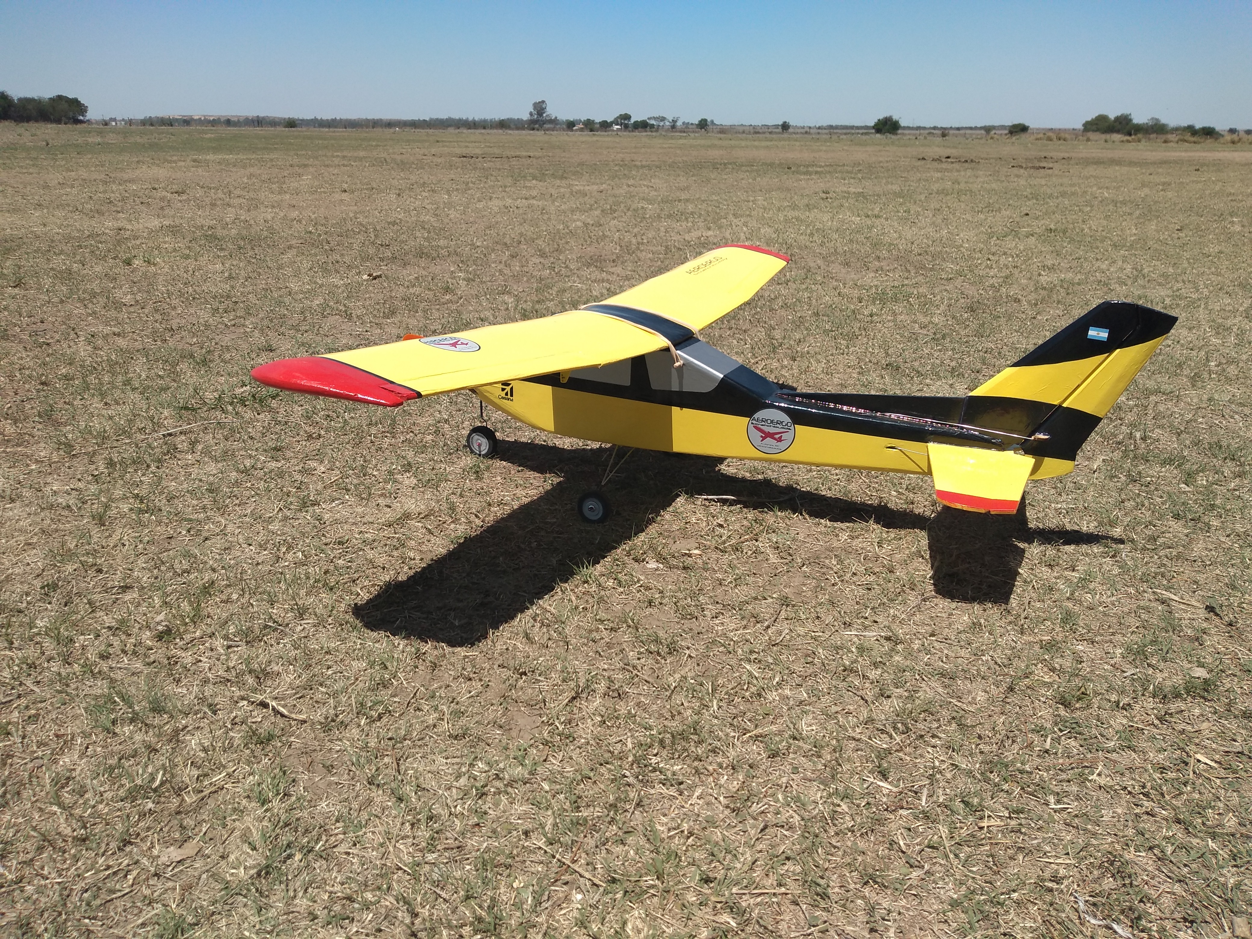

The plane needed 30 grs of ballast in the nose to flight better, in the second flight improves the handling characteristics
In the end the result was very good for a scratch plane, even the wheels are made from scratch, old flipflops hehe.
