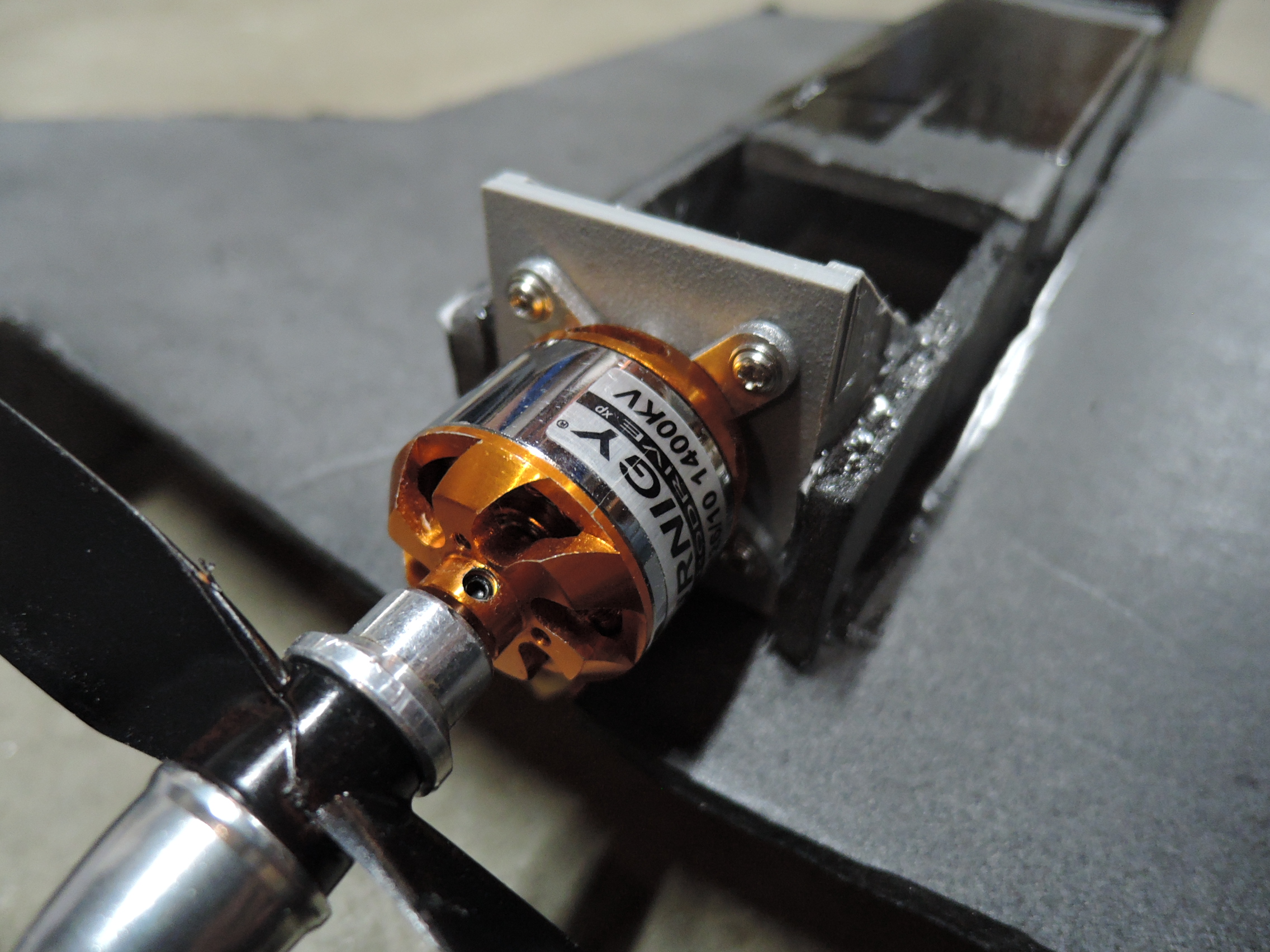

Electronics I am using:
Motor: 2826 1400kv brushless.
ESC: 3-4s 40A
Prop: 9x6
Battery: 2200mah 3s
Transmitter: Walkera Devo-7
Servos: Regular 9g

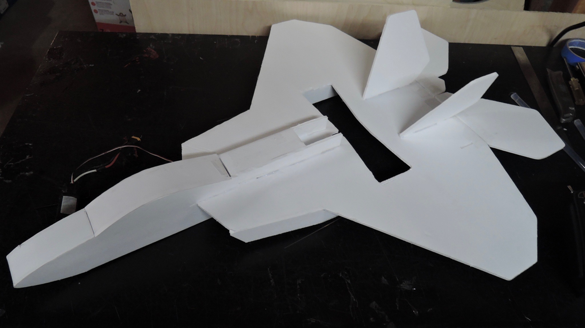

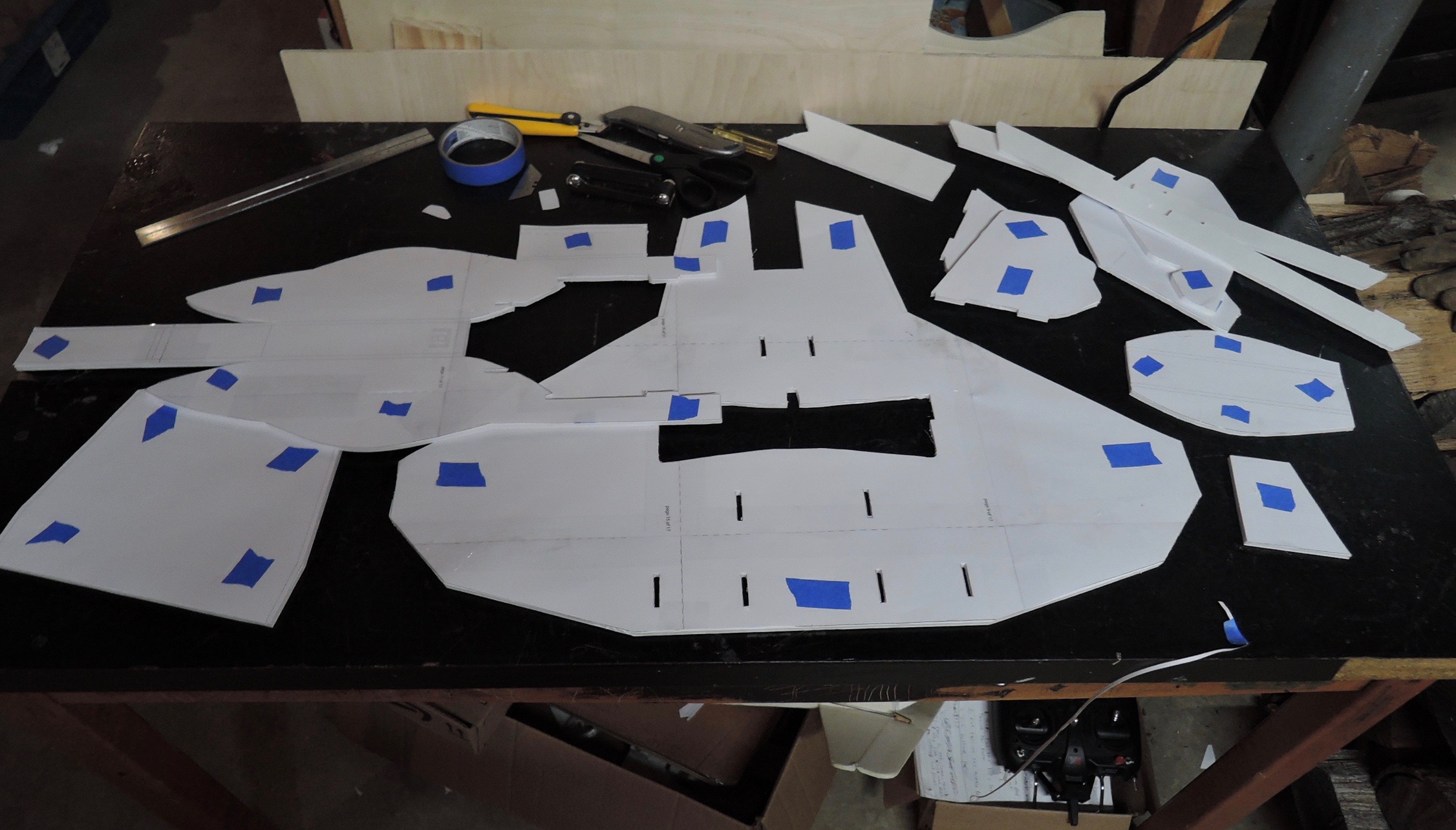

First step is to tape the tiled plans together and cut out all the pieces(it's the hardest part of the whole build).
The build is pretty simple and it only took me one evening to get most of it done.

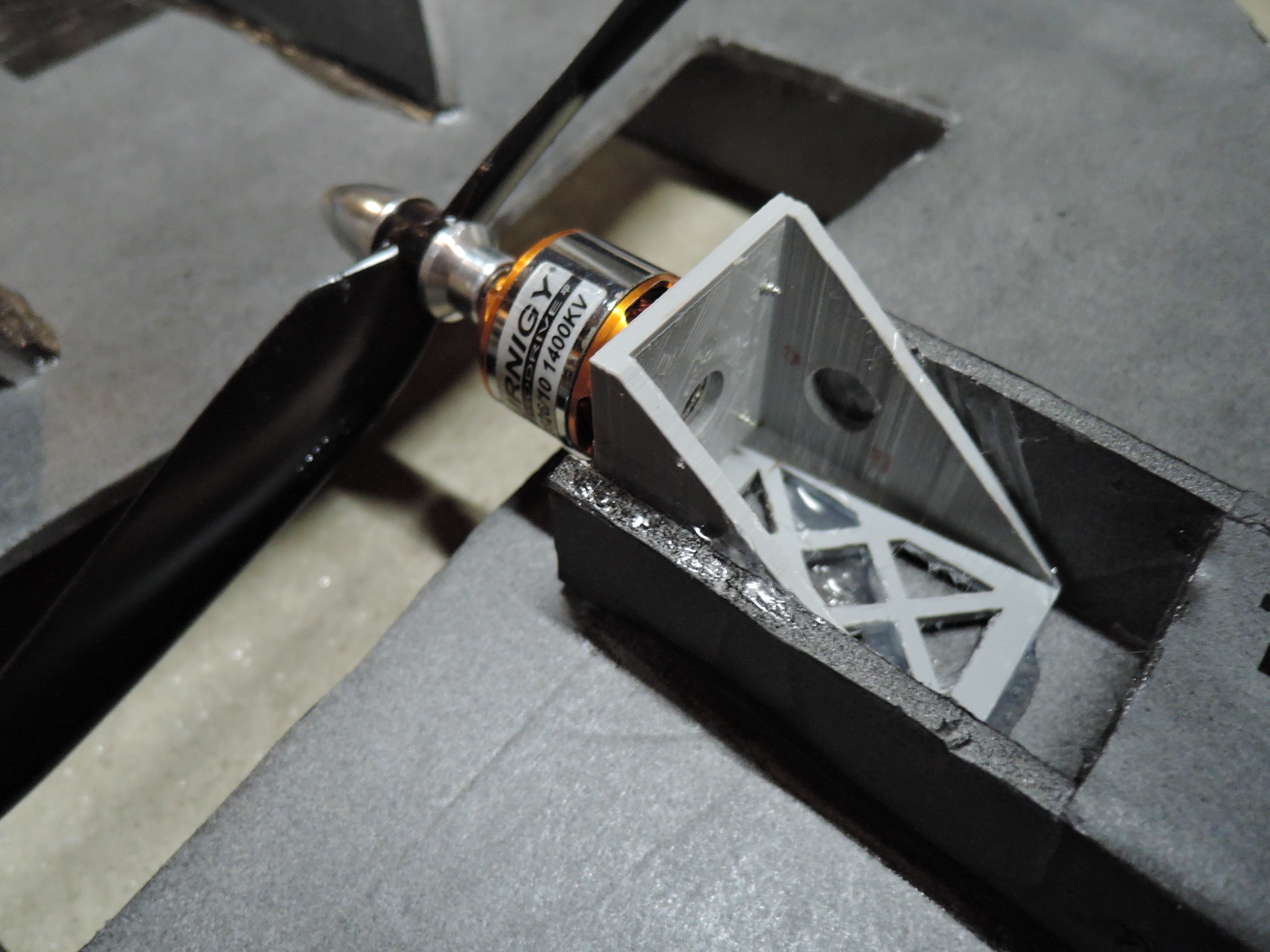

I didn't have time to order a FT Elements" Simple Firewall so I got a friend to 3D print one for me. Here is the stl file.
ft_elements_simple_firewall_v2__fixed_intersections_.stl
Here's what it looks like on the plane!

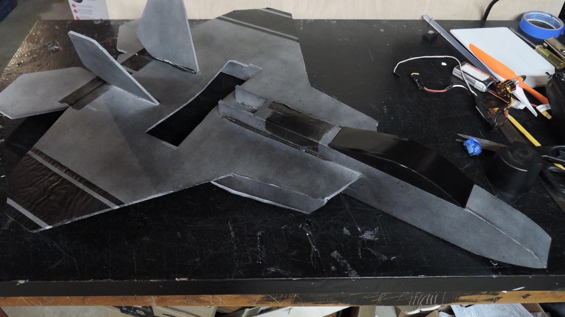

Before I put the motor, ESC and receiver on, I gave it a nice coat of GRAY paint! Big mistake! (Since it was all gray I lost orientation and that's how I crashed!)

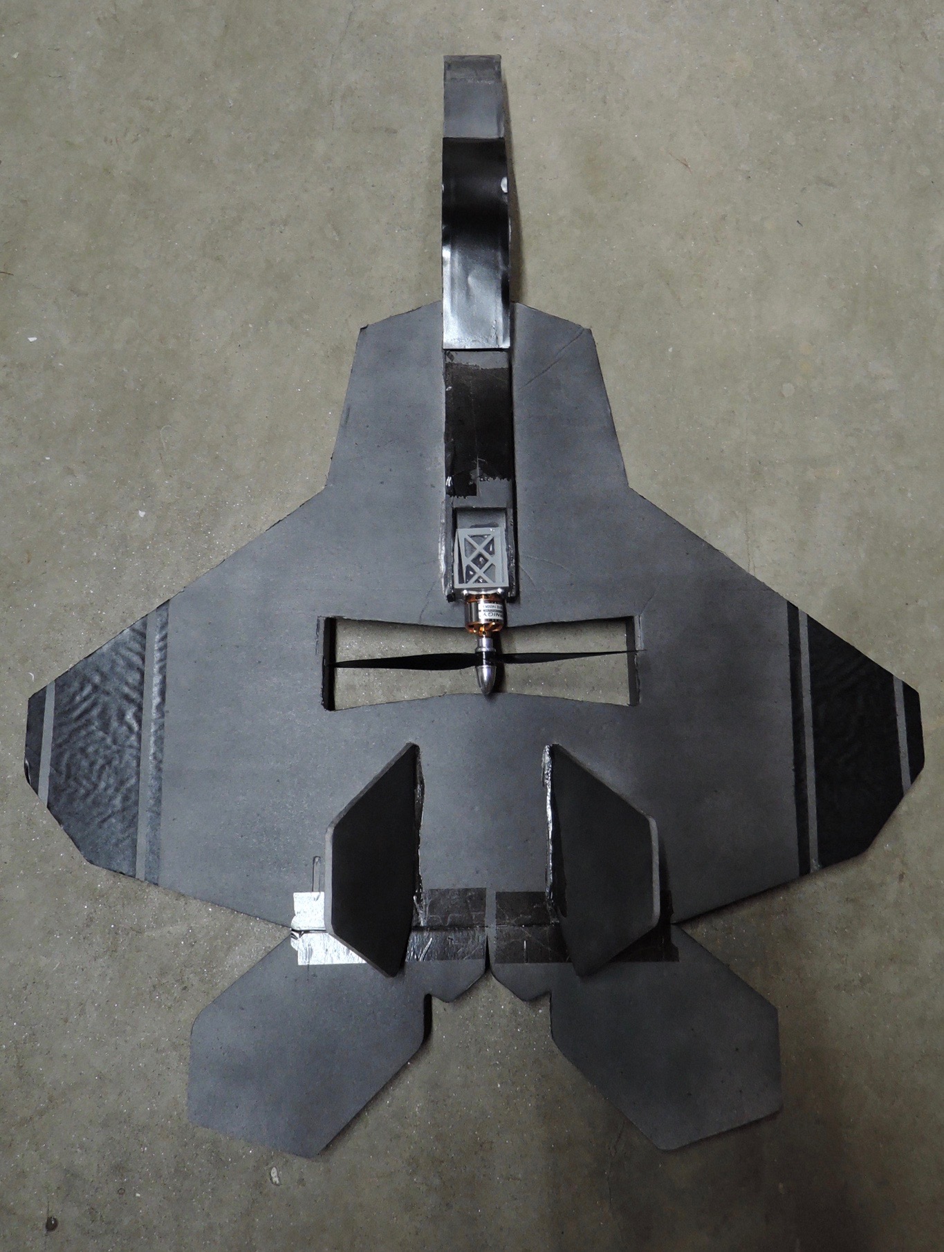

Crash damage:
 To keep the same thing from happening, I painted two big yellow stripes on the belly. We'll see if it helps on the next fight.
